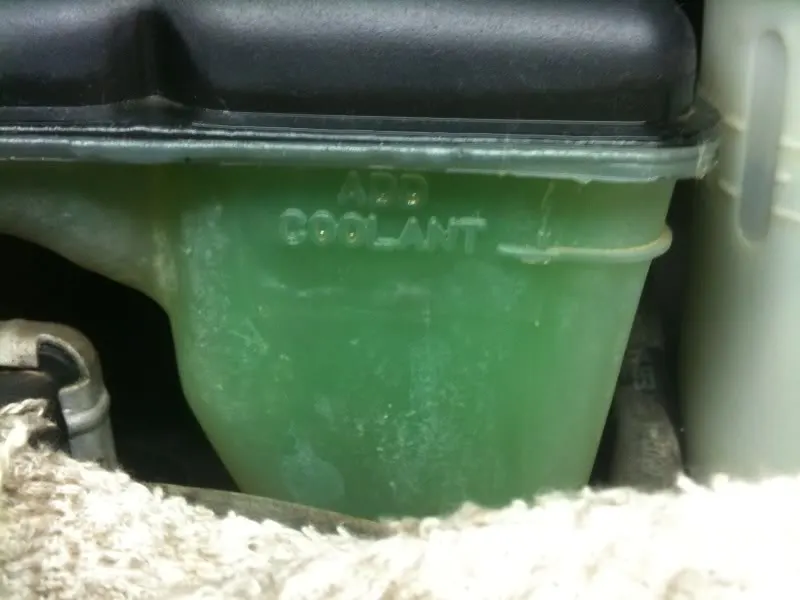

Ok guys, just recently my car started spilling out coolant from the tank/cap. Last two times I drove my car it did this. The coolant tank completely drains. Last night I started my car and watched it. I poured coolant into the tank just a tad below the fill line. After about 3-4 mins at idle, it risen completey to the top of tank. :shrug:
Anyone know why it would be doing this. The car runs fine, just the coolant spills out of the top and when I park my car, the coolant is gone :shrug:

Ugh....that's not good :( Yes, the tank is completely empty after I park the car.

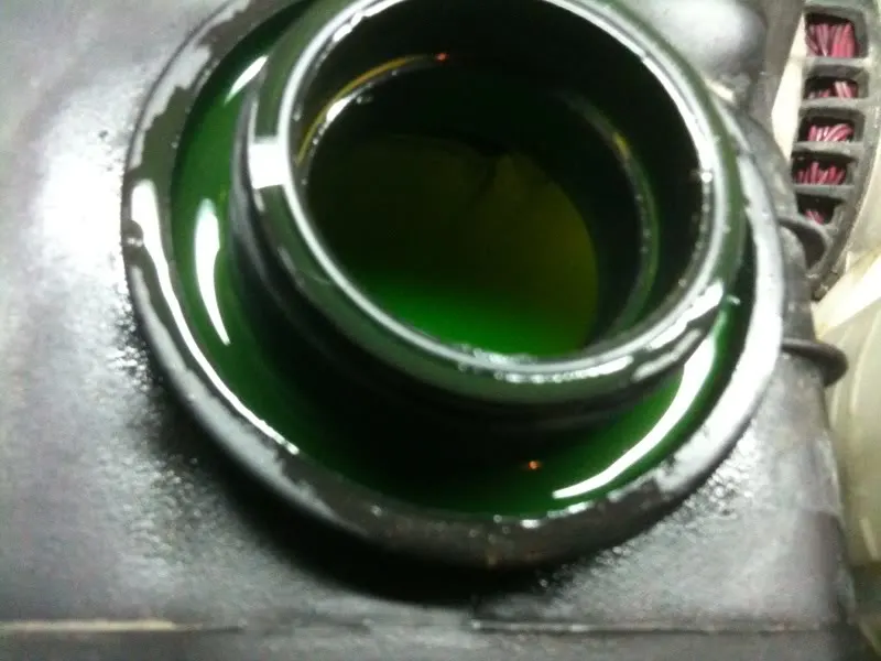

Here is a vid I shot yesterday. This was during the 3 mins of idle when the coolant was rising. You can see towards the end of vid a little better. Looks like air is coming up from bottom or something. It did the same thing when I first poured the coolant in(when car was off)

See, thats the thing, It's not really leaking anywhere(atleast from where I can see), nothing on the garage floor either. Just checked the coolant level before I went to work this morning and it was fine. Right where I filled it up to from the other day :shrug:
Now if I would go and start it. Then it would rise and if I would then drive it, by time I get back, the coolant tank would be completely empty :shrug:

Also note, in the vid the coolant is bubbling up with the radiator cap off. The system needs pressure to work correctly. If the motor is very hot when the radiator cap is removed, some flash boiling should be expected.
