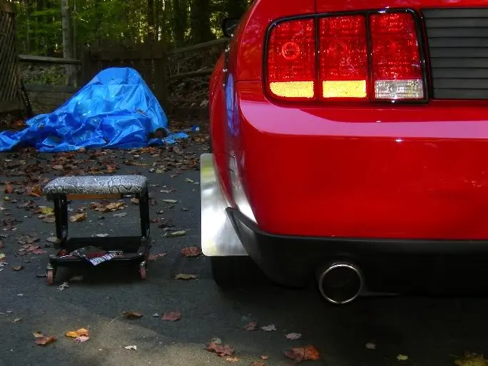

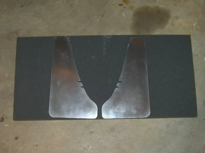

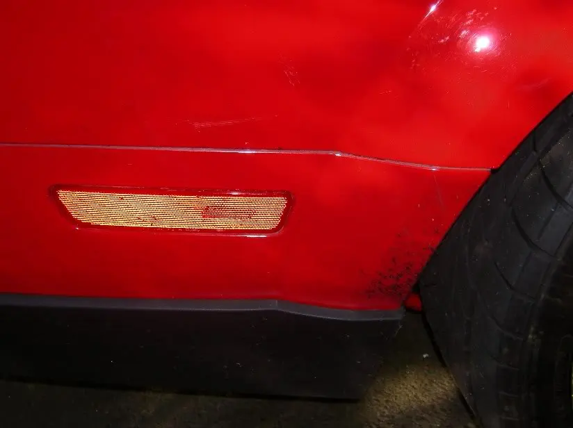

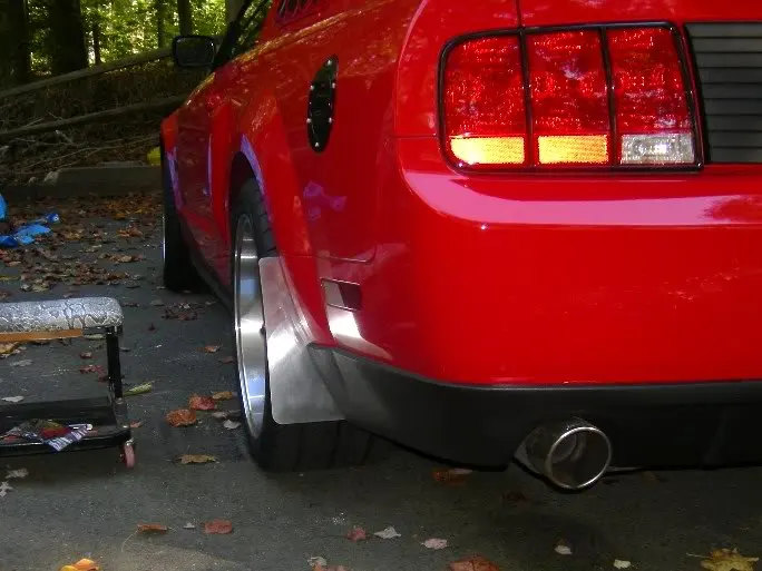

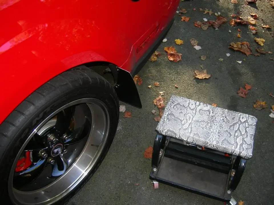

    Anyone who has run their S197 at the drag strip knows about the "Crap" that attaches itself to your rear quarter panels from burn-outs or simply spinning a bit during launch. Some of the guys use a crap load of painters tape to protect their ride which I am sure works but goes through a lot of blue tape and looks like crap if you have pictures or videos taken. Some guys install Ford or aftermarket mud flaps when they change out their tires which works fine but they are somewaht limited in size for cosmetic reasons and lets some of the crap get by. And you have to completely remove the three screws and get them restarted each time.

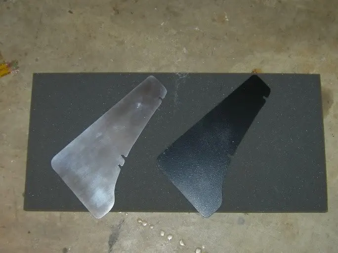

    I made an alternative today, they attach like mud flaps, but they are much wider, only require you to loosen the screws a few turns to get them mounted for simplicity, (of course you retighten the screws) and will catch more tire crap. These are easily cleaned and I painted the crap side black so the crap doesn't look so crappy on them.
    Tire crap Vs paint job....
    [IMG]
    The Crap Flaps...
    [IMG]
    [IMG]
    Installed on my car...
    [IMG]
    [IMG]
    And the crap side...
    [IMG]

    Cool idea, i like how you made them to be removable. When i first looked at them i was thinking no way would i permanently attach those to the stang but to be able to take them off when not at the track is nice. :nice:

    No I wouldn't want to drive around with those on there either, to and from the track maybe, but they are just for utility use. I could make them closer to the body but that kinda defeats the purpose or I guess
    I could paint them Torch Red but why bother. I suppose if I had a Cobra I could cover them in some of that "Snake Skin" Tolex I put on my roller seat...LOL

    I answered that in my original post. That blue tape looks like crap on the car and if you are having pictures taken or a video it really looks bad. It takes longer to put that tape on the car than it does to put these on or remove them.
    You are entitled to your opinioon as am I, to each his own.

    looks pretty cool, i prefer the look of tape instead of those, but such a quick install/removal is definately a real nice advantage. permanent mudflaps are for pickup trucks.
    The only thing i would say, i'd want the screws going through holes, not just a slot, i want no chance of those flying off at 110mph.
    Either way though, thumbs up on coming up with an idea and making it :nice:

    I told you a few weeks ago I was going to make something so I looked around at what I had on hand for some kind of plastic/rubber kind of material and I didn't have anything suitable to go that wide so good 'ole 6061 aluminum it was LOL.
    I did reshape the upper outside edge and made it a lot less squared off and a little nicer looking, but I wanted them wide and that's what I got. Of course I have until next Spring to rework them or make somethng else entirely as materials come available.
