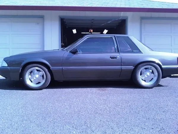

Was out swapping wheels around today and seen my driver side rear shock was shot (look like it was leaking oil?) on my 4 banger. So the question is should i do some nice KYB's or something? I want it to handle to a point and have other supporting mods on it to go with it. (yes i said supporting mods on a 4 bangerLOL) peace
john:p
well this is what it's going on. I have a 8.8 with 3.55 gears steeda alumn. LCA's and soon a pair of full lenth SFC's.OH yeah plus i put a sway bar on the rear cause the 4 bangers dont come with them.
Tokico, Koni, Bilstien, Tokico Illuminas are the only shocks I would reccomend for that low of a car. Tokico Illumina and the yellow Konis will be the best combo of good ride and handling for a good price. The Bilstiens a better unit but is a bit more expensive too.
