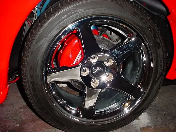

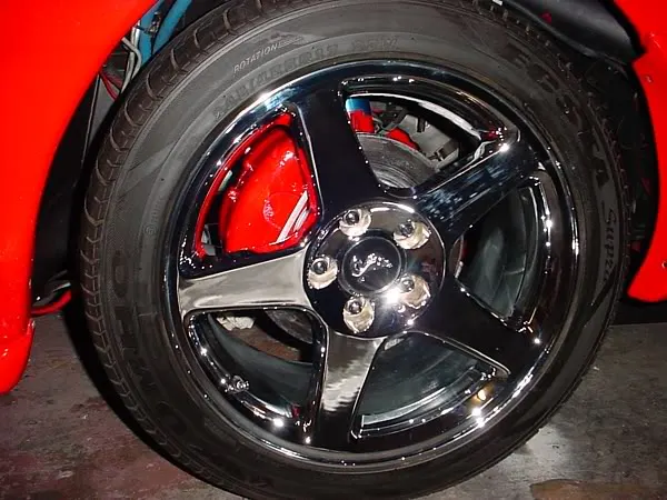

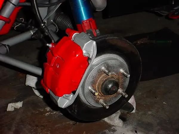

Started out cleaning them with a sanding disk/wheel, then laquer thinner.
Then sprayed the silver base, then clear coat.. Waited a few hours, then masked off the silver section, and then primered the main caliper
Next, I sprayed the main caliper with a red base (dupli color spray bomb)
Then pulled the masking tape off the silver caliper piece, then cleared the whole caliper assymbly with PPG high solids clear (nice shi*) And cleaned the brake disk up while i was at it, with a brush and some grey, and silver paint..
