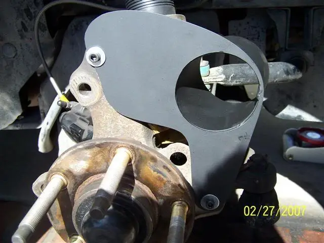

    you could always replace them with these

    I've wondered about this as well. Also, I wonder if the brakes run just a little cooler without the shields.

    Perhaps I'm slow but are these custom or a stock ford parts and they do cool the rotors, correct?

    That set up on the spindle can have a hose type assemble attached to it going up to the front bumper. Kinda like ram air for your brakes.

    I took mine off, coated them with POR-15, and re-riveted them. Now that they are good and black they are not noticeable. IMHO too much risk of damage to run the car without them, especially if you drive on gravel roads at all.

    A guy on SVTP sells them. they are for brake cooling, you run heater duct to the front bumper and knock out the useless foglights. I got them when i was pulling 1200 F rotor temps at Buttonwillow.

    They are for water...not dust. Basically they keep water off the rotor from the opposite tire splashing it up. It does make a difference as wet brakes sometimes have a delay when soaking wet.
    You can use 04 shields on the earlier cars. 96-04 should be no mods, while 94-95 require minor trimming of the tie rod area
