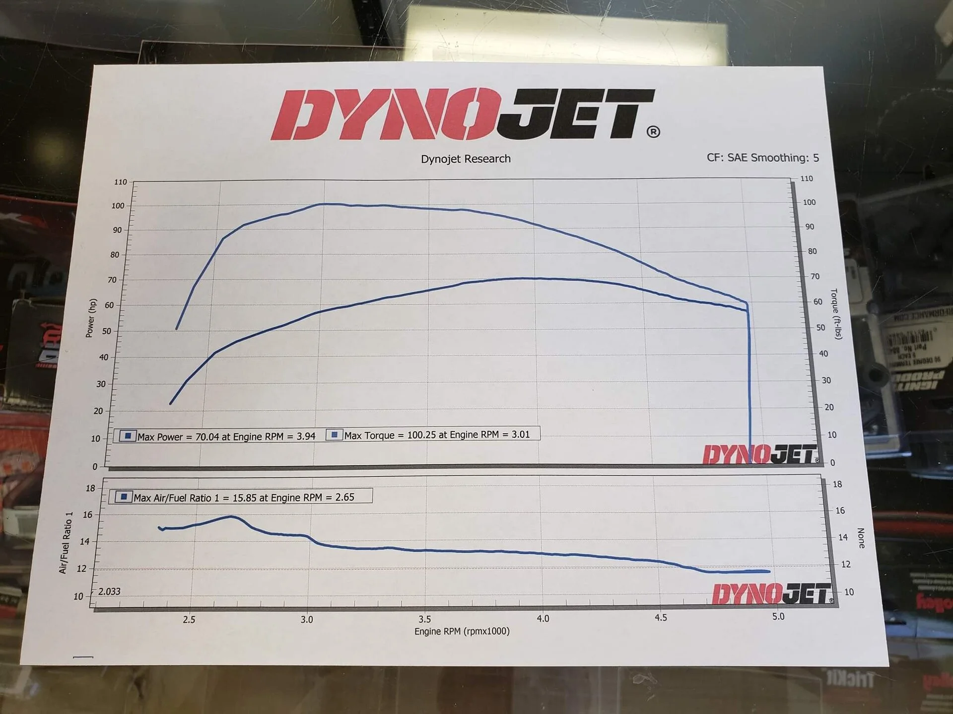

1989 2.3L 82,000 miles, bone stock with the A4LD.
70.04 HP
100.25 LB/FT Torque!
HP fell off after 4,000 RPMs.
Building something better...
