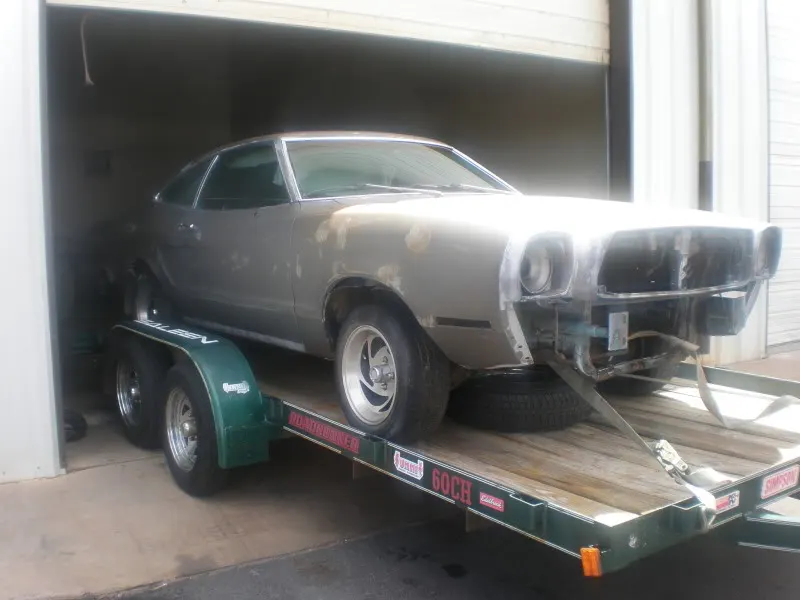

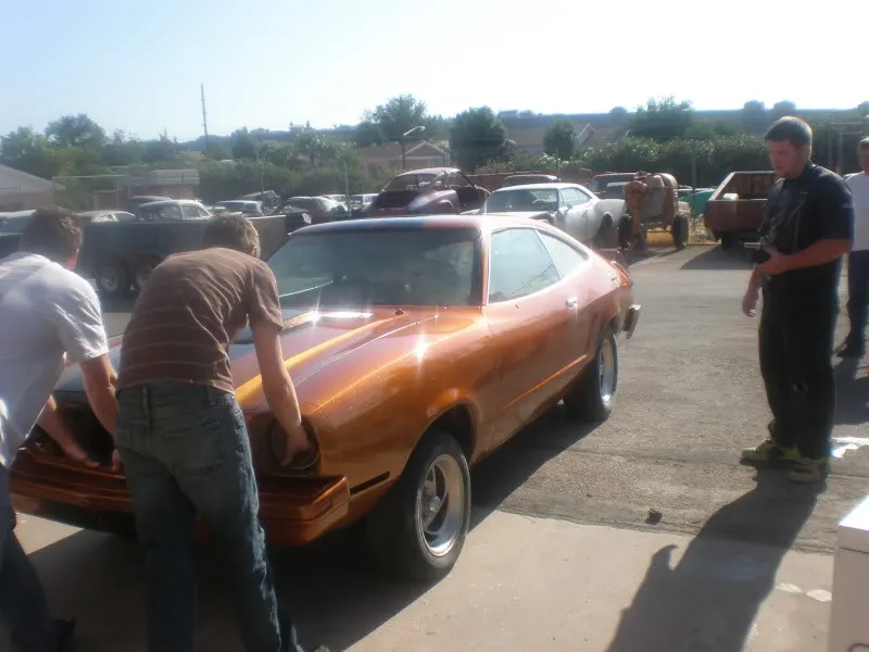

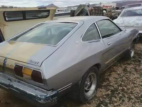

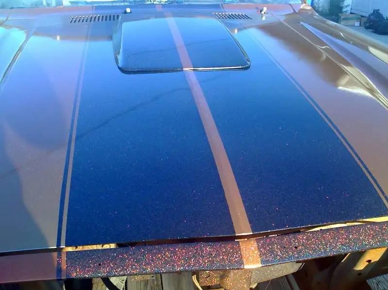

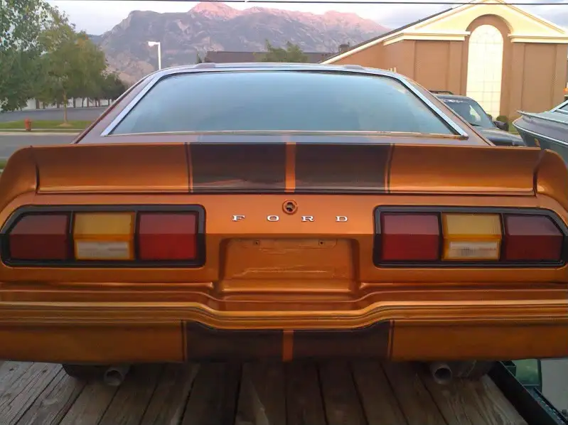

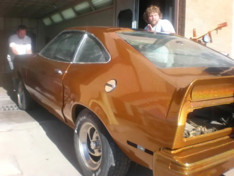

    Well I guess I can divulge the results "so far" on my next project. I found it in a field and picked it up for 200 bucks here are some pics of progress and where we are now:
    Where we found it...
    [IMG]

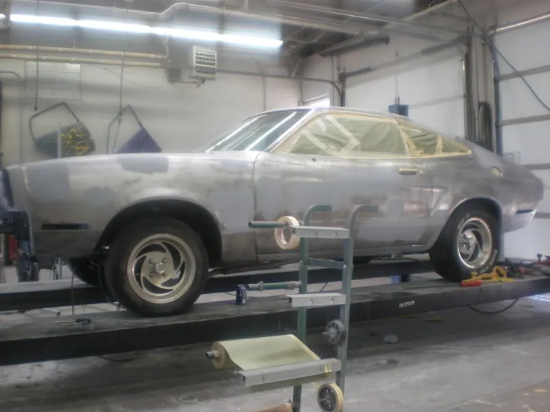

    Stripped it down with a Soda Blast...
    [IMG]

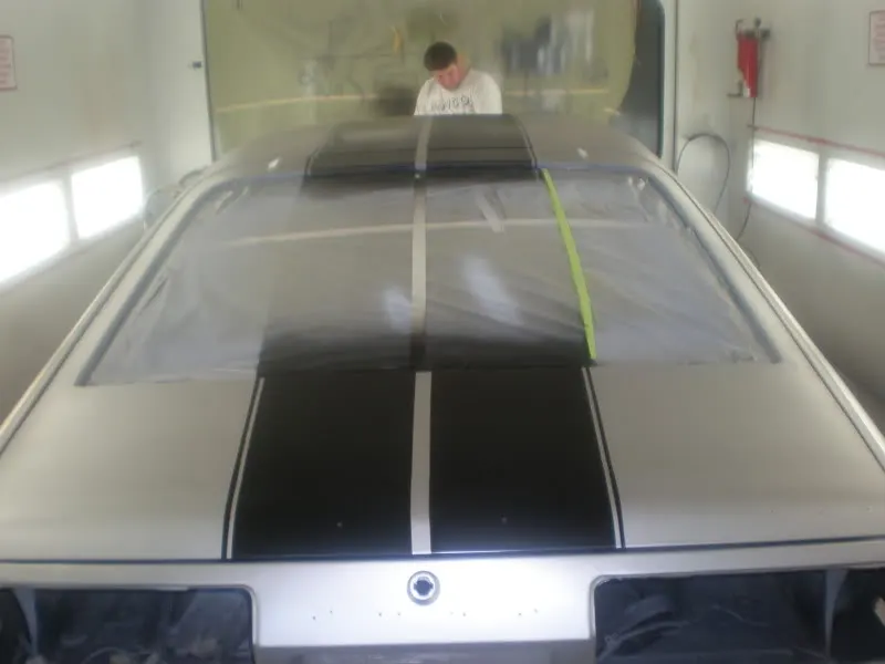

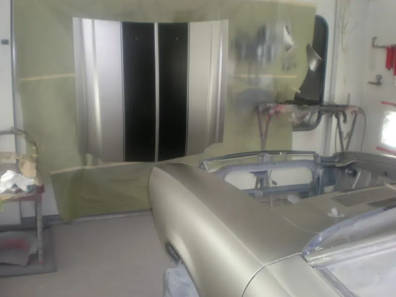

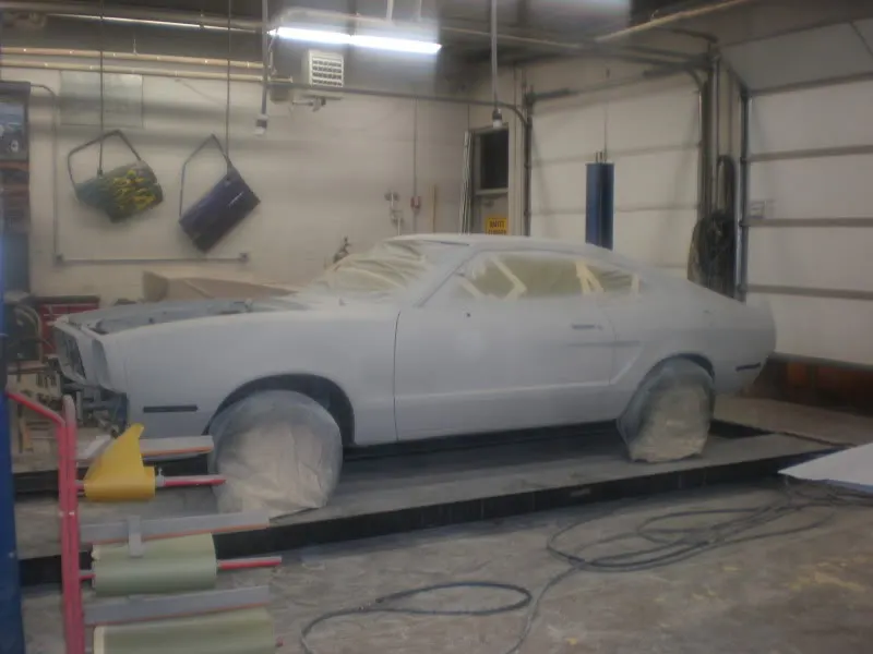

    72 hour overhaulin Bodywork...
    [IMG]
    [IMG]
    Paint, 2 coats primer, 2 base coats, stripes, 2 coats color, 3 coats clear. 9 Coats total:
    [IMG]
    [IMG]
    Rolling it out...

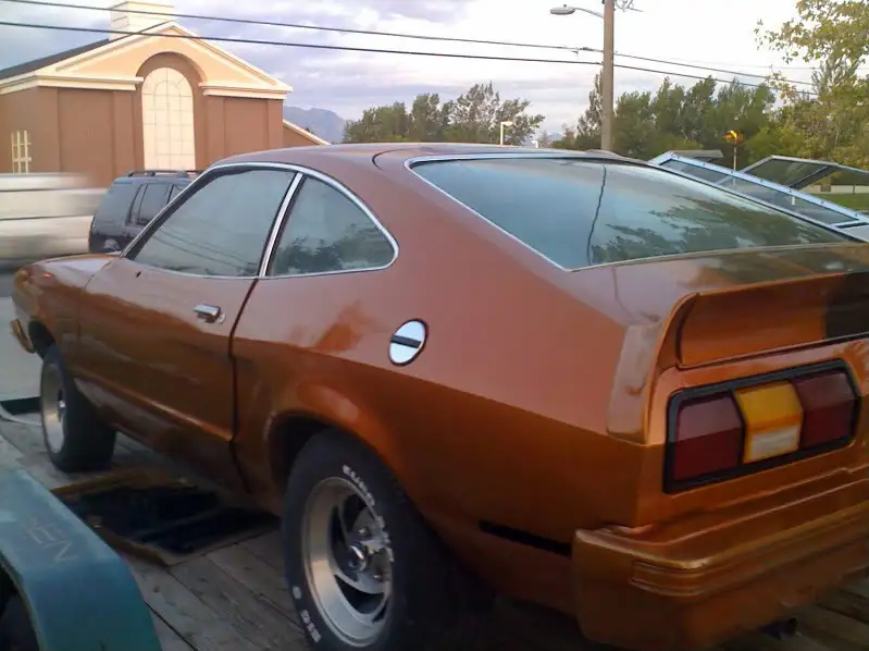

    [IMG]
    [IMG]
    REassembled... Mostly...
    [IMG]
    [IMG]
    [IMG]
    [IMG]
    Still to go, Engine, Complete re-do of the interior...
  4. 78CobraII Moderator
    Member Since:
    Jul 31, 1998
    Message Count:
    1,799
    Likes Received:
    Trophy Points:
    36
    Location:
    Birmingham, AL
    Great body work and great color! I can't wait to see the interior and engine. What do you have planned for it?
