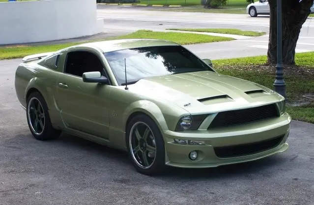

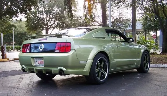

    [IMG]
    [IMG]
    I love my 20's!
    20x8.5 f & 20x10 r
