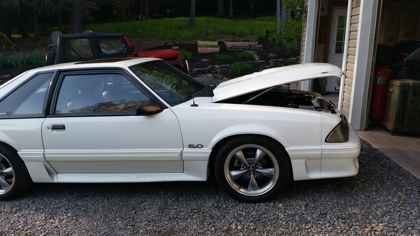

  1. I have an '89 LX. I have a tire rub issue and it has only gotten worse since its been lowered. And I do know the '89 has less clearance than I think the 90-93. Any idea on tire size?
    It has 17in Chrome Cobra rims. I did not buy them so I do not have any specs on them. Tires are 255/40/R17 I did not purchase the tires.
    What is the ideal tire size or other ideas short of getting later fenders that's not an option right now?
    Thanks in advance.

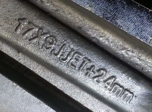

  13. Honestly I do not know the 17 chrome Cobra's were on when I bought it in '08. I have looked at them for a serial number or part number but I did not find any. I did not look to heavily though. Thanks in advance for your help.
  14. no problem. You should be able to simply remove on and look inside one of the spokes. There should be a stamping similar to ET38, ET43, etc. The number corresponds to the wheel offset
  15. Here is what I found.
  16. So on a hunch i pulled the rear rim to see it is 17x8 fronts are 17x9. Im dumb! haha been like that since I got it.
