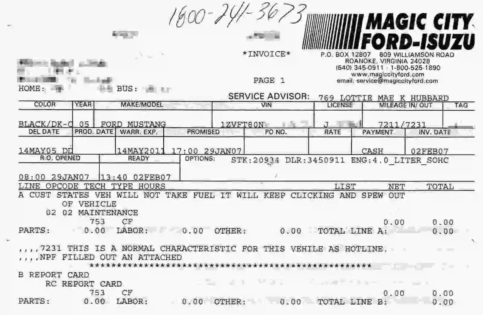

Took my car to get the replaced fuel tank in 2005 because it was clicking off the pump and spewing gasoline everywhere. Replaced, no questions asked.
Still doing it (don't fill up often, rarely drive it, 2 years old and 7200 miles). Took it back in this past Monday. Today, Friday, get a call that it will not be fixed and that the behavior is now considered normal on that vehicle.
See attached ticket.
Not sure why it didn't attach. I tried attaching a jpg. If you want me to email it to you, let me know. It's good for a laugh.
I can't get it small enough to attach. Let me know and I'll email it.
I cropped the scan down, but it still shows the relevant information.
So you already had TSB 05-4-8 performed in 05. NOW, you take it in and after 5 days and a 20 mile joy ride (check the in/out mileage on the order 7211 IN - 7231 OUT. Come on.. They didn't drive that far in my GT when it had cracked control arms.. pfffttt WTF?) they tell you this is "normal"....
I find it difficult to swallow that the federal government with their tight hiney emission controls + vehicle warranty would accept this as being a "normal characteristic" for any vehicle.
You have two ways of handling this based on this affecting you only or this affecting many consumers as well as the environment. 1. The grand pro-active butt kicking for the masses would be write Ford Corporate and send a copy of the work ticket, provide a copy complaint to the NHTSA
http://www-odi.nhtsa.dot.gov/ivoq/
as well as the EPA. 2. The proverbial "Just Me" approach will be to contact the GM of the dealership and ask he/she HOW is a vehicle that is spewing fuel and vapor emissions due to a faulty vapor venting system inside their ill-designed saddle tank a "normal characteristic"? Let the GM know that you would be interested to see how the federal emission warranty and laws would read their interpretation of this "normal characteristic".
Either way, hold tight and your fuel tank should be fixed in time. This will not fly - NO WAY.. Not on my watch. LOL
Yell if you need help. I have an arsenal of big words and lofty intellectual threats at your disposal.

Jennifer,
Thanks for the reply. I have a call into Ford Customer Care and am waiting to hear back from them. I have also spoken with the Service Manager at the dealership and also plan to speak with the General Manager as well.
We'll see how that goes, and then I will see who else I need to speak with.
I know I'm not the only one in this situation, too. That's the crappy part.

I don't do that. Actually, to be honest, I've never even seen the "low fuel" light come on in the Mustang. When I went to fill it up the other day, it had about 1/2 tank in it. After about fifteen minutes, it was up to about 9-10/16 of a tank. That's where it is now, minus the 20 miles that they drove it while it was in the shop not being repaired or diagnosed.
Yes, I did speak with the shop foreman and was told that they didn't attempt to even duplicate or diagnose the problem.
