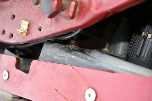

    The easy solution is order a new headlight, but that still requires me ripping off the headlight that's on there now. I'll go out and get a picture.
    Thanks for the input.

    [IMG]
    So these are the screws holding the headlight to the car. The nuts are rusted on to the screws.

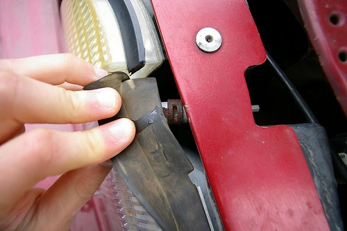

    [IMG]
    And this is one of the clips that hold the screw into the headlight. This one is in just fine, others are missing or disconnected. This allows the screw to spin freely in the headlight assembly making it impossible to get the nut and the headlight off the car.
    If I could get it off it's be as simple as getting new clips and tightening up the headlight. But right now they are all loose and the headlight bobs up and down when driving or if you pull on it with your fingers.

    The screws have a hex shank that you can use to hold the screw still.

    That was exactly the tip I needed thanks! Unfortunately whoever put the headlights back together used some of the originals and some new screws. Of course the ones with rusted nuts are different screws with no hex at the end. And there is no room to get a pair of pliers on them AND a wrench for the nut. Lovely, god damned hillbilly PO.

    Your first pic shows the nut that holds the headlight in, your second pic is of the adjustment screw, There are three nuts that hold the headlight in the housing. It's probably the adjustment screw that is adjusted too far out and is only pushing on the headlight rather than holding it in place. Screw it in 2-3 turns and it should have very minimal play when the threads catch.

    You should be able to snap those clips off with some needle nose pliers.Then you will be able to see the end of the adjustment screw, it has a slot at the end of it where the clip will sit in.You just need to tighten or loosen the adjustment screw to where you see the slot then snap the clip back on.Make sure you put the clip on the correct way, one of mine were backwards from the "factory" causing my light to move back and forth like you described. In the meantime soak those rusty nuts with some penetrating oil.
