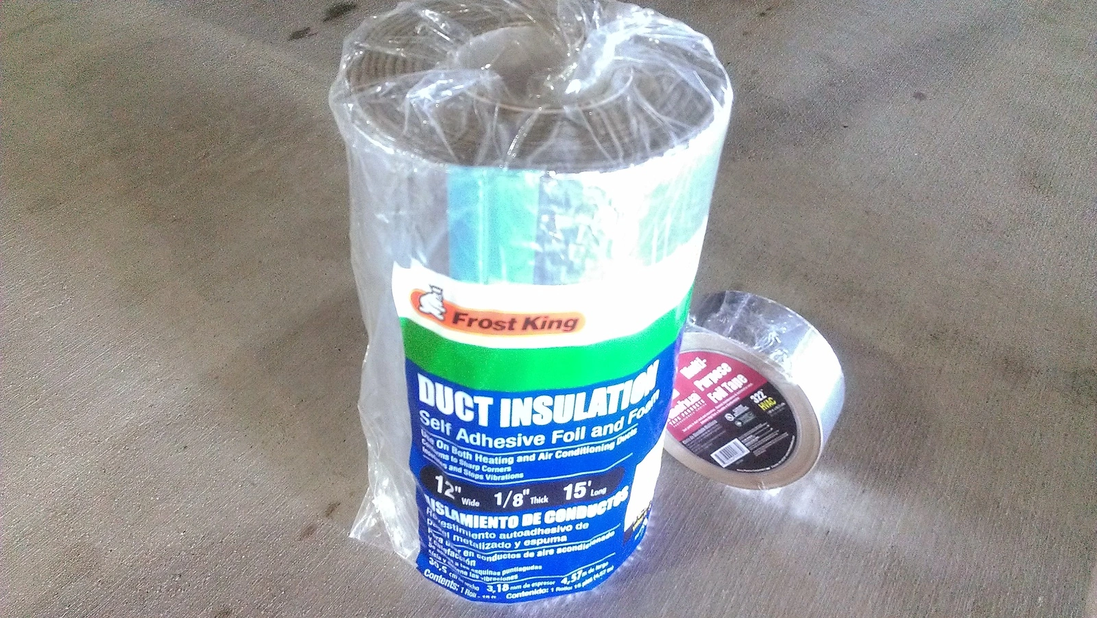

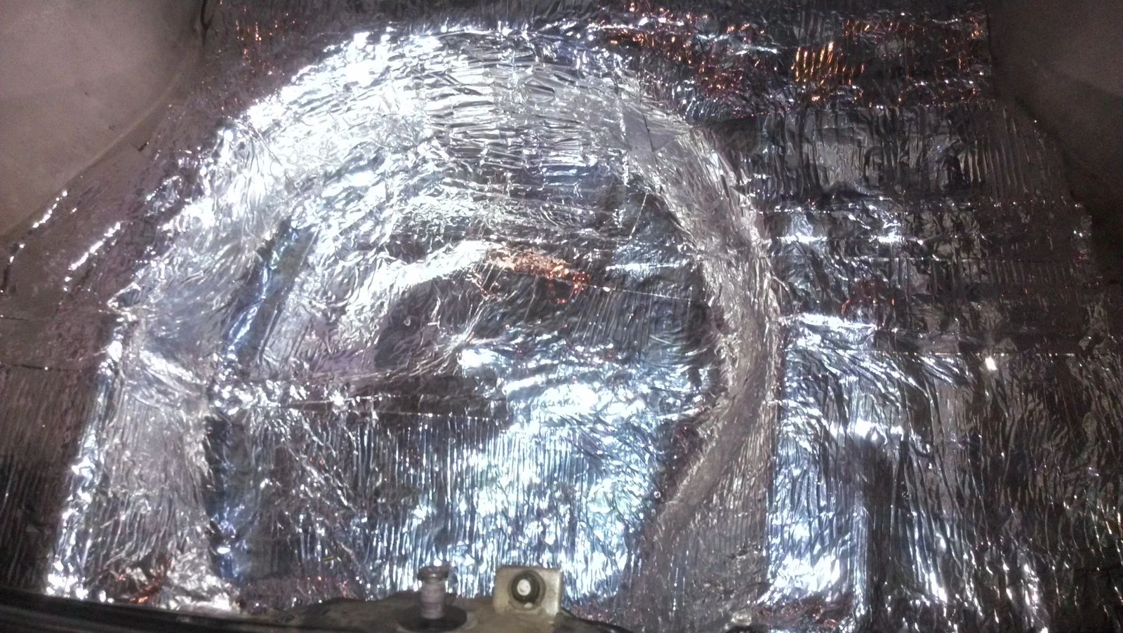

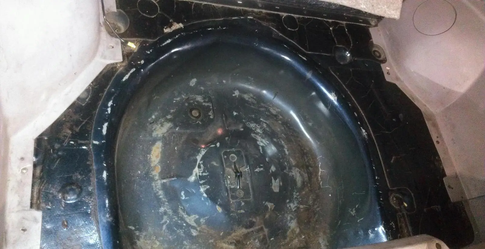

Alright, so I've done some research and I'm headed to Home Depot to get some Frost King tacky insulation. It helps with heating/cooling along with noise dampining. I'm gonna do my hatch/trunck first and see how that goes. I'll report back with some pics and info :nice:
Well this is what I got, they were $18.97 + $7 at the depot....

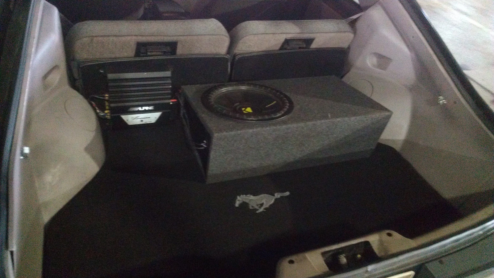

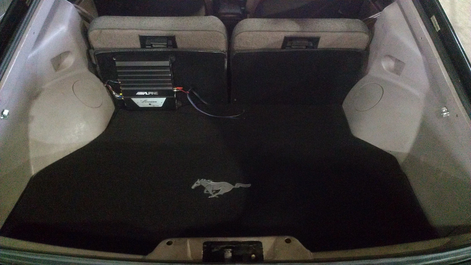

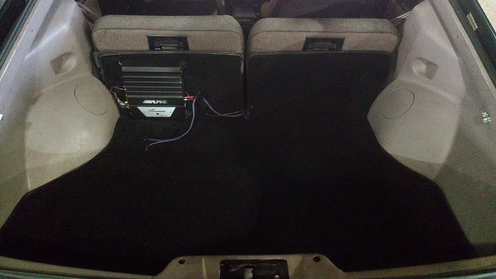

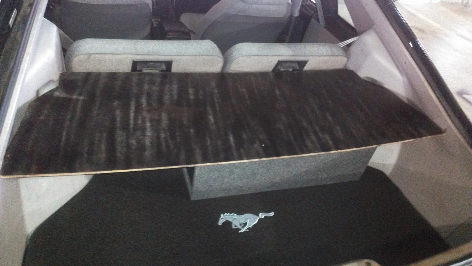

I also added the new rear carpet, mat cover logo and my own fabricated privacy cover. I used cabinet locks for the clips on the side to lock it in place. It fits snug against the rear seat on top of the fold downs. I bought a real privacy cover, but I like this way because I can open the hatch without revealing everything evertime its opened. I've got to finish the paint but it's close. Btw ....the Frost King insulation is very easy to work with, no funny smells like others I've read about. Now that I've got a little experience I'll tackle the passenger compartment when I can. Oh btw 1 roll did that trunk barely so make sure you plan it right.

My buddy did the frost king stuff, worked well, but by the time he was done, he could have bought some of the cheaper sound deadener/heat barriers. The cost was negligible. Either way, it will still work.

Yeah I know what you mean, not sure what it will take for the passenger area. But I believe this is the way lighter avenue compared to the premium sound deadner material. I originally wanted a thermo-barrier and now I got a little of everything!!

Oh if anyone is wondering what I used to mount the amp on the fold down, ...I just pricked a small hole through the carpet and ran small zip ties through the upper amp holes. The carpet hooks onto the top of the fold down so I didn't have to drill or anytyhing. There is enough slack in the amp wires to release the fold down flush to the back seat. That way I can just slip out the wires from the 12" sub box(from best buy) and easly take it out if i need to haul something. Which that would be quite rare, but it gives me options with taking trips with suit cases etc... :spot:
