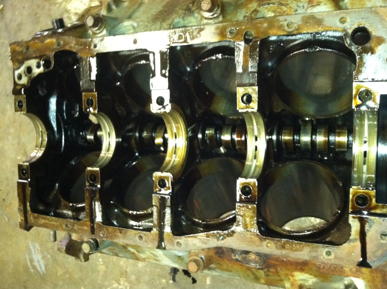

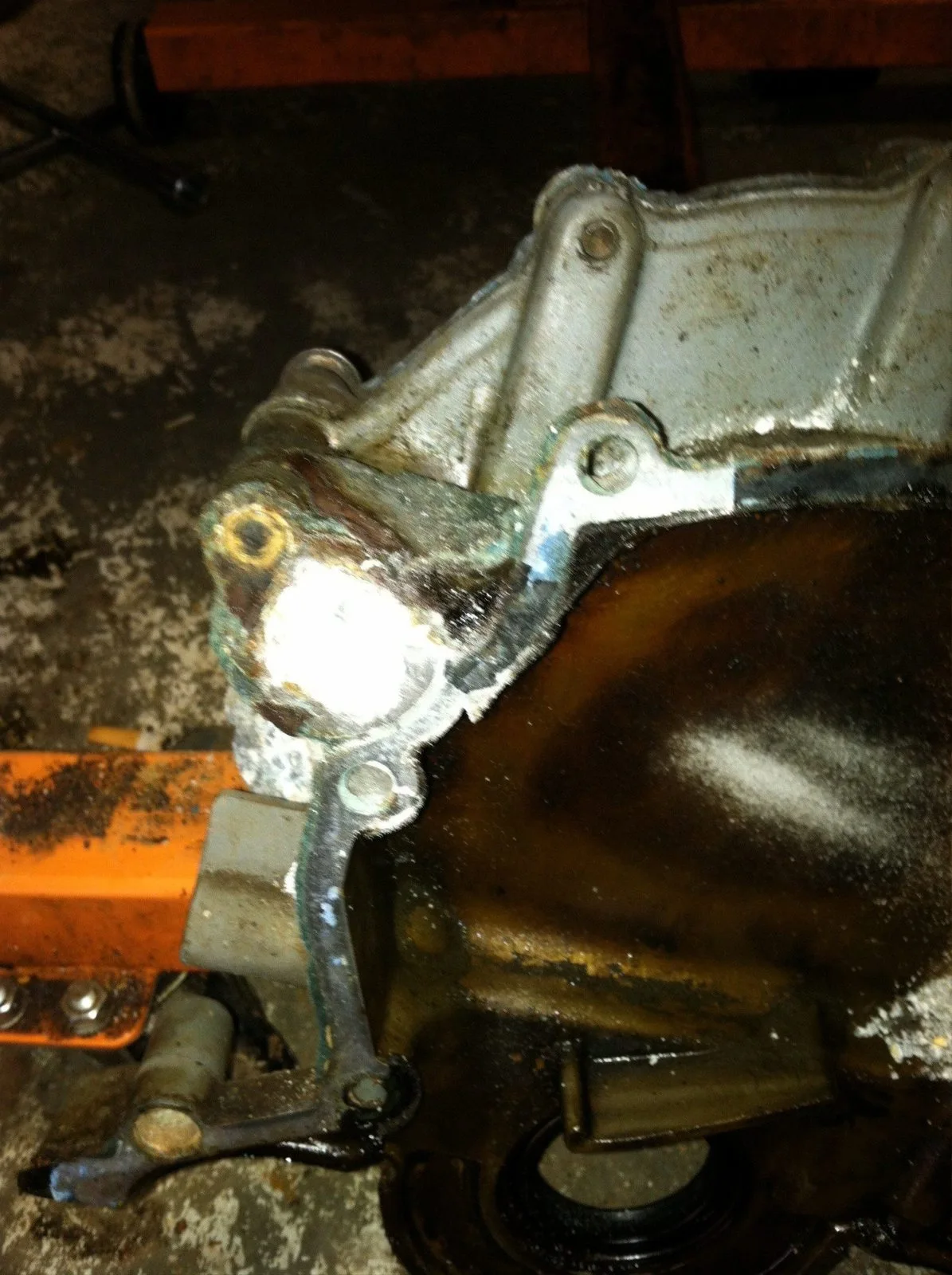

    I finished pulling my engine apart and have found somethings that werent or may not be right. water jacket cover.jpg My water jackets were full on the pump/timing chain cover side along with on engine. I was able to take my finger and push the stuff from the engine but the timing chain cover is pretty solid. Can that cause any issues I should know about?

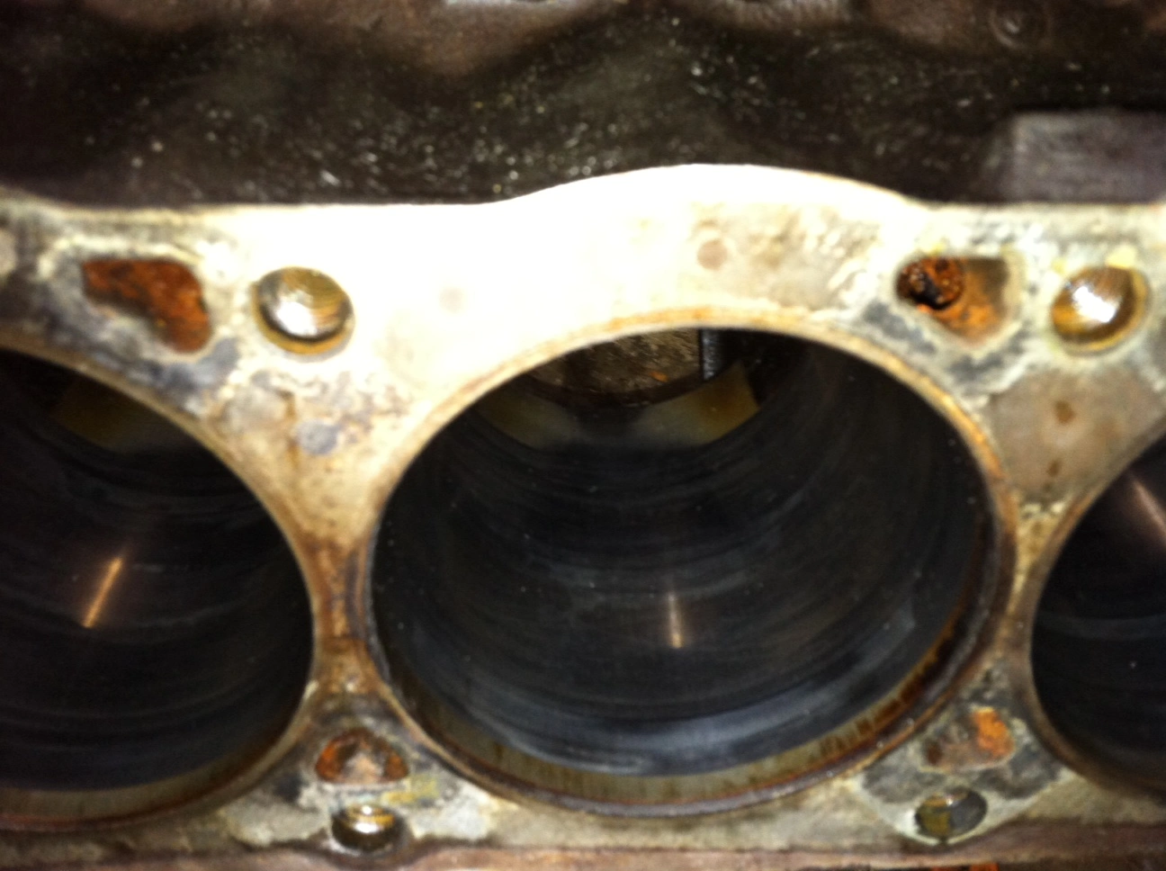

    MY bores at the very top of the cyclinders have a ridge bore.JPG at first I thought maybe they had alot of wear but I can still see very hard to but can see crosshatching. Was this part of the engine design or is it just like the junk the develops in the heads on the valves?

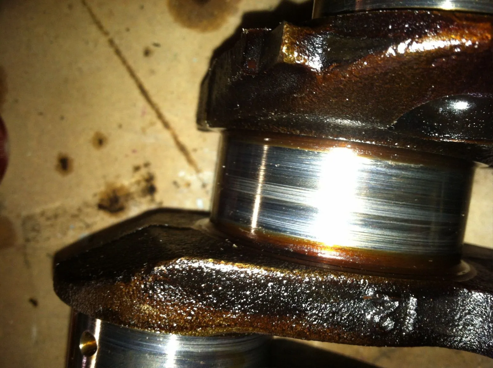

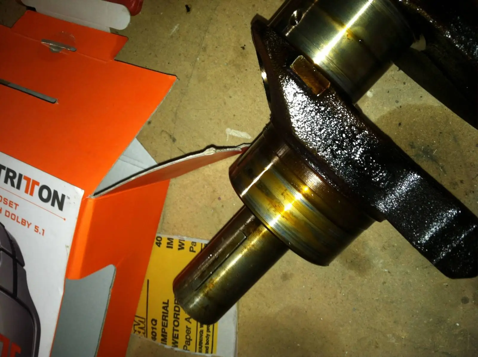

    My crank shat has small very small not seeable but you can feel there is a ridge in the center where the main bearings are crankshaft1.jpg crankshaft.jpg bearings.JPG are these little ridges ok because of the bearings having the slot on top side of engine or is this bad. Two of my bearings on the other side that screws down crank in place had copper showing one alot more then other. If replacing my crank is the route then I believe I will be looking at the entire 393 stroker from dss since its not much more then buying a crank and pistons. What are your or anyones thought on this.
  12. The blockage you showed will definitely cause some heating issues if you don't get rid of it. the ring ridge isn't out of the ordinary for a high mileage engine. Sometimes the "ridge" is only carbon deposits, but scratch through that crud with a razor or something like that, and you might find a ring ridge too. And based on the condition of your crank, it probably has a ring ridge, and if you can catch a nail on pretty much any surface, it'll need machined. If you saw copper, that means either the engine was high mileage, or led a rough life...possibly both. You don't have to replace the crank though unless it has to be heavily ground. Take it to your machinist, and they can likely grind it down 0.010-0.020" and it would be fine. It's been a while, but I seem to recall paying about $120 to have the crank ground...probably a little more these days. But, if you buy a stroker kit, you typically have to buy new rods too.

  13. Well based on the pics I think it had a veery rough life, Ive never seen coolant passages that packed and it definitely had less then ideal oil changes....
    The crank looks like a polish will clean it up but really it needs to be measured and looked at to be sure. If you decide to go 393 let me know, Ill hook you up...
