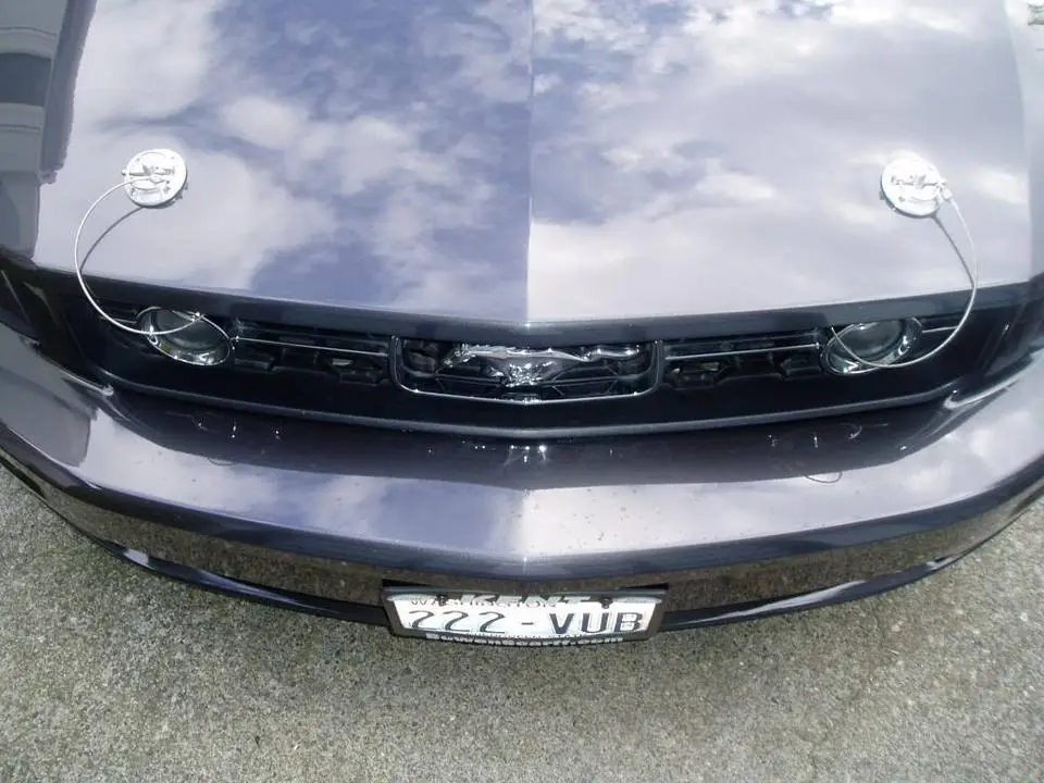

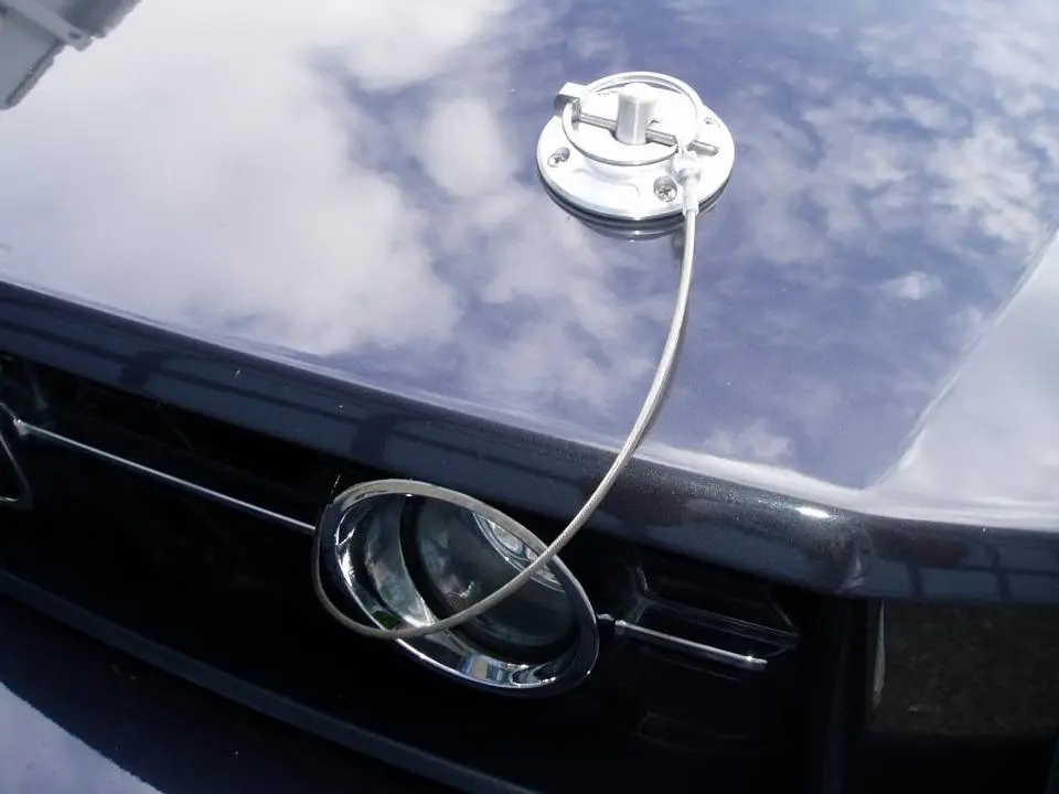

I had a lot of hood flutter at high speeds so I installed the Shelby non-logo pins. I've installed pins on many of my cars, so it's getting simpler each time. The Shelby pins are good quality. Here's these pins on my '07 GT....

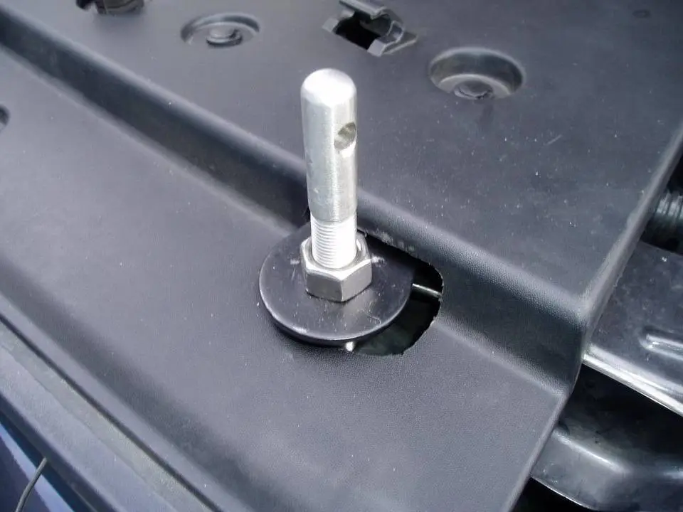

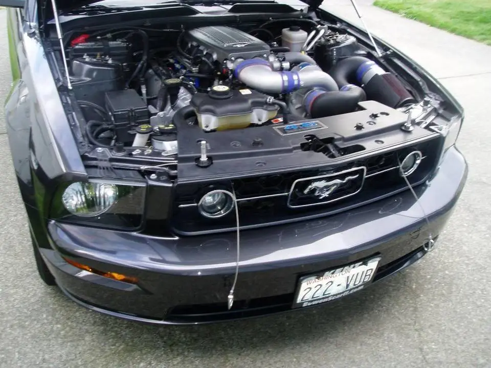

I had the same pins as five oh brian with my stock hood, but I placed them near the outside edges. The brackets that come with them have you mount them on the upper radiator support. For me, that was too close together. I know emay and heavygt have thiers out near the sides as well. The thing about mounting out there is you need extra care in proper positioning of the scuff plate or they won't line up. Mine didn't line up great, but they worked. I have yet to put them on with the Steeda hood. I like the look without them and hope I don't pay the price of not having them on there. As far as finding the hole location for the hood, you figure out where you want the pins, install them, place something on the top of the pin, gently let the hood down and wherever it marks the underside of the hood is where you drill.
