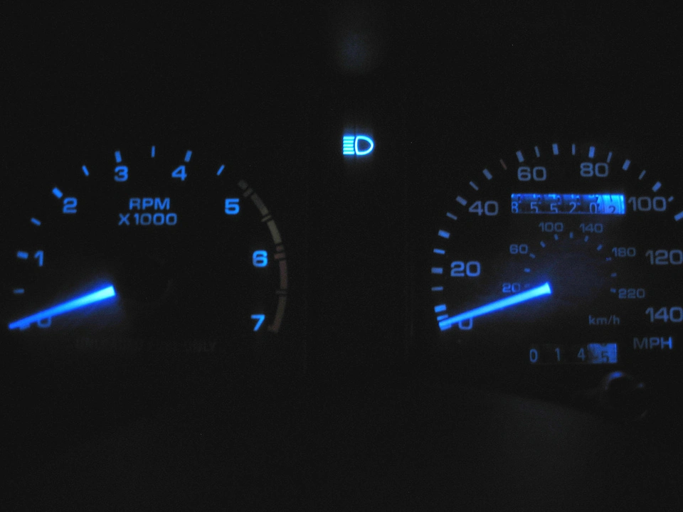

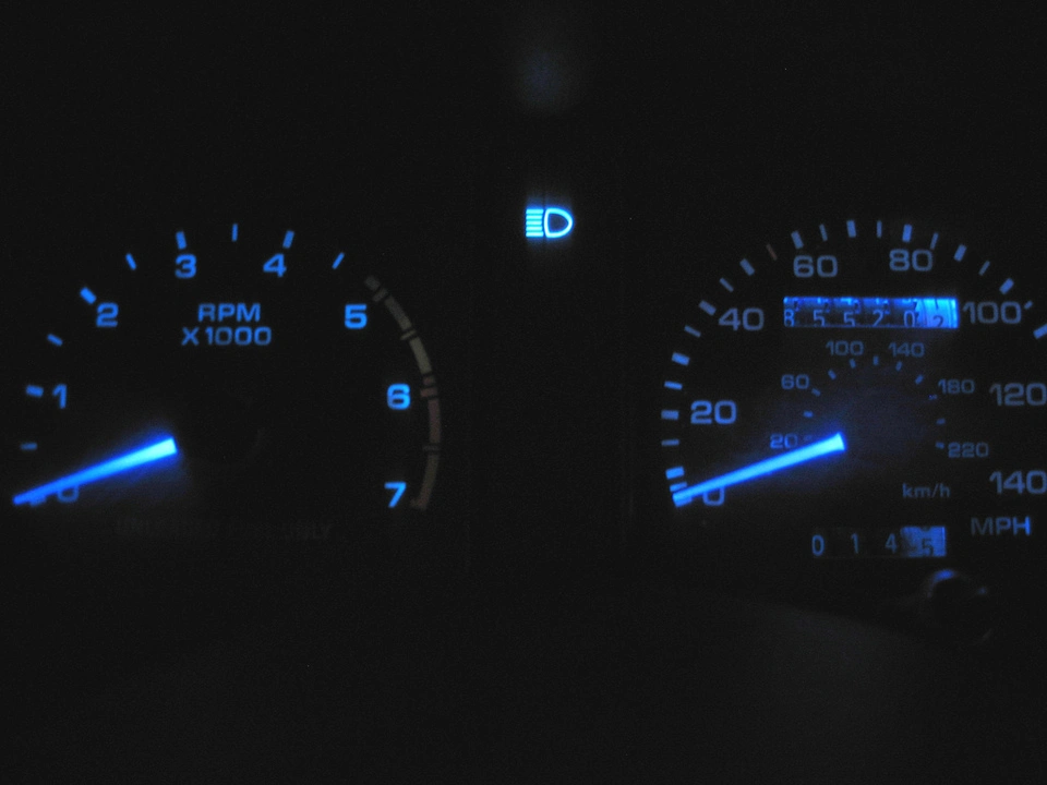

    i got this done at midnight...thanks for all the help!
    those steps came in really handy...thank you.
    here's a few pics so far...

    [IMG]
    [IMG]
    I LOVE BLUE!!!
