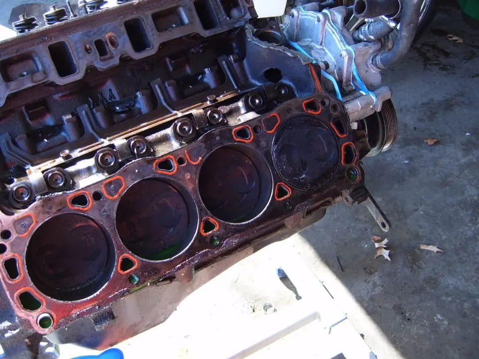

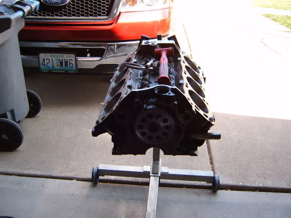

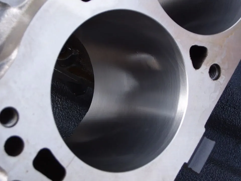

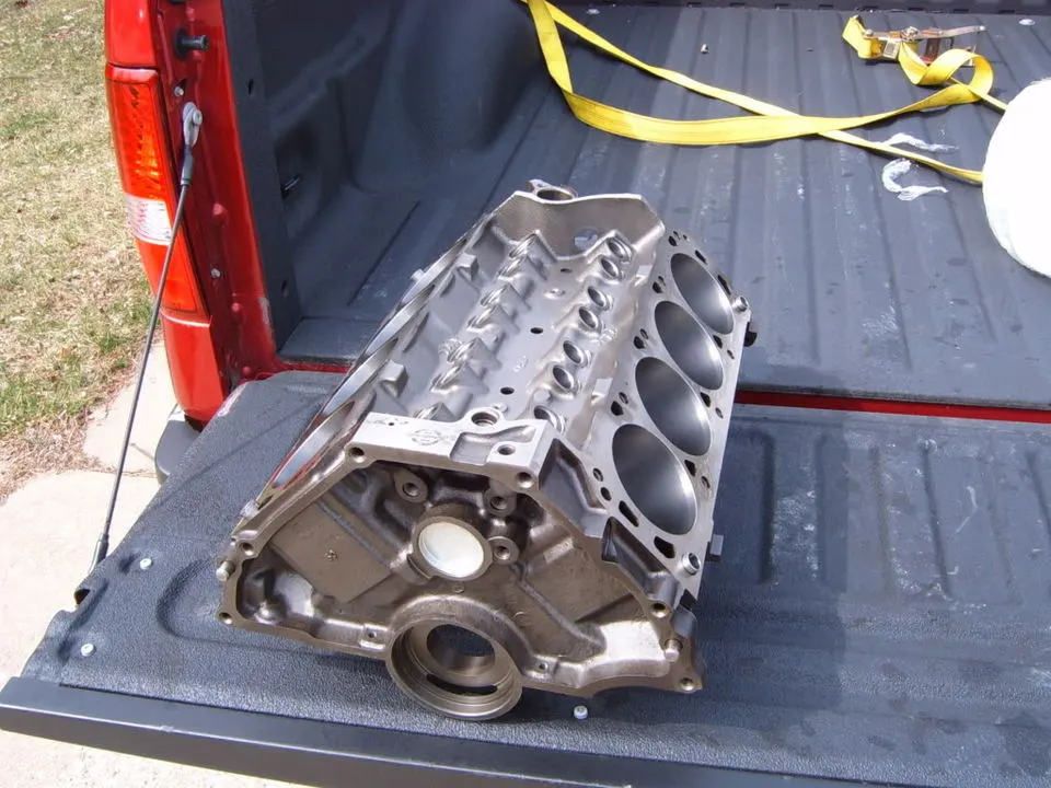

    just picked this up at the machine shop today
    [IMG]
    [IMG]

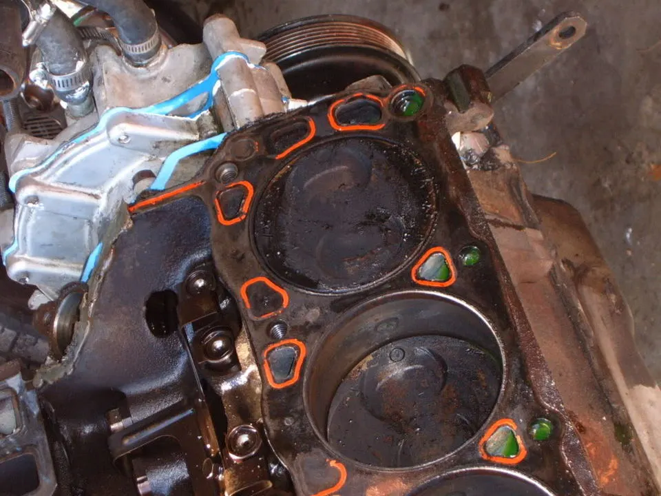

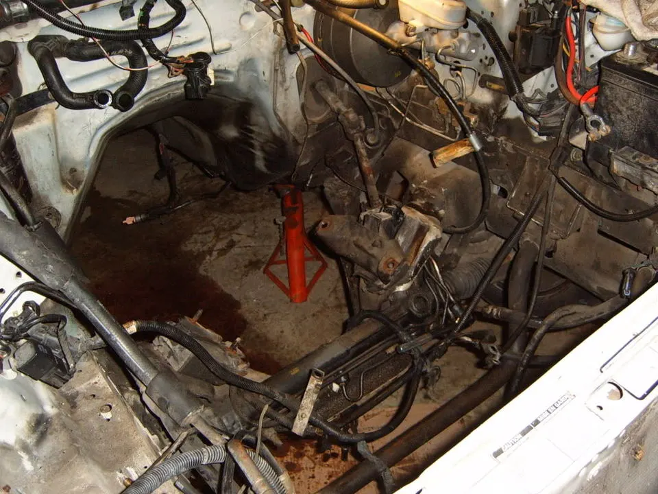

    and this is what i pulled out saturday
    [IMG]
    [IMG]
    and still gotta clean up this mess, undercoating is great for making a rust free car, but damn it looks ugly in an engine bay
    [IMG]
    rebuild kits supposed to be here tomorrow, and hopefully itll be above freezing so i can give the block a bath and continue my bit of wire hiding and do an a/c delete.

    stock crank and rods, new .03 over pistons, and a trick flow kit (waiting on ye ole tax return for the top end still)

    Wow that thing looks great, thats exactly what I want to do but I am trying to find a stock block for like 50 bucks local. Looks great though. If you dont mind me asking what did they do and how much did they charge to clean it up? Was it like a well known speed shop? Or just an engine machine shop?

    That's one damned beautiful block. :nice:

    block was done by what used to be allied motorsports (the call themselvels bessel now). same guys who run Home . block was tanked, decked, bored .03 over, honed, and stroker notched. price was a bit on the high side, $475. also its not the same block, i dropped mine off weds, they called me thurs said they had one already done and wanted to trade so they could put their main caps on mine so they could have a full batch of em. no big deal to me, they threw in the cam bearings and freeze plugs for free.

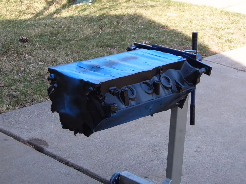

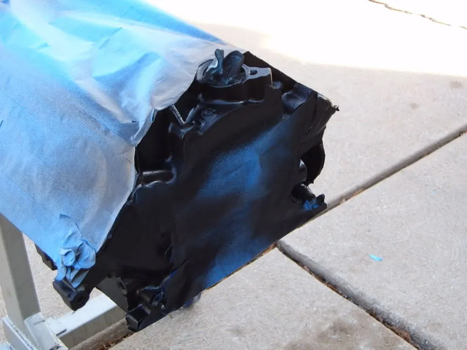

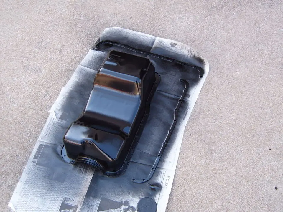

    well, managed to get the block cleaned and painted today, also painted the pan.
    pics:
    [IMG]
    [IMG]
    [IMG]

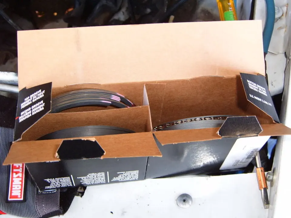

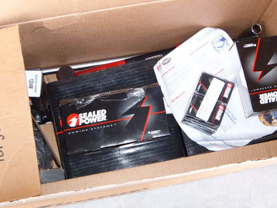

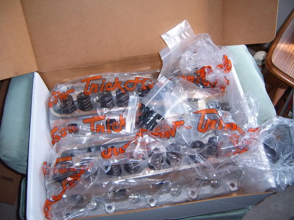

    also got a nice big box of summit parts, yay!
    [IMG]
    [IMG]
    [IMG]

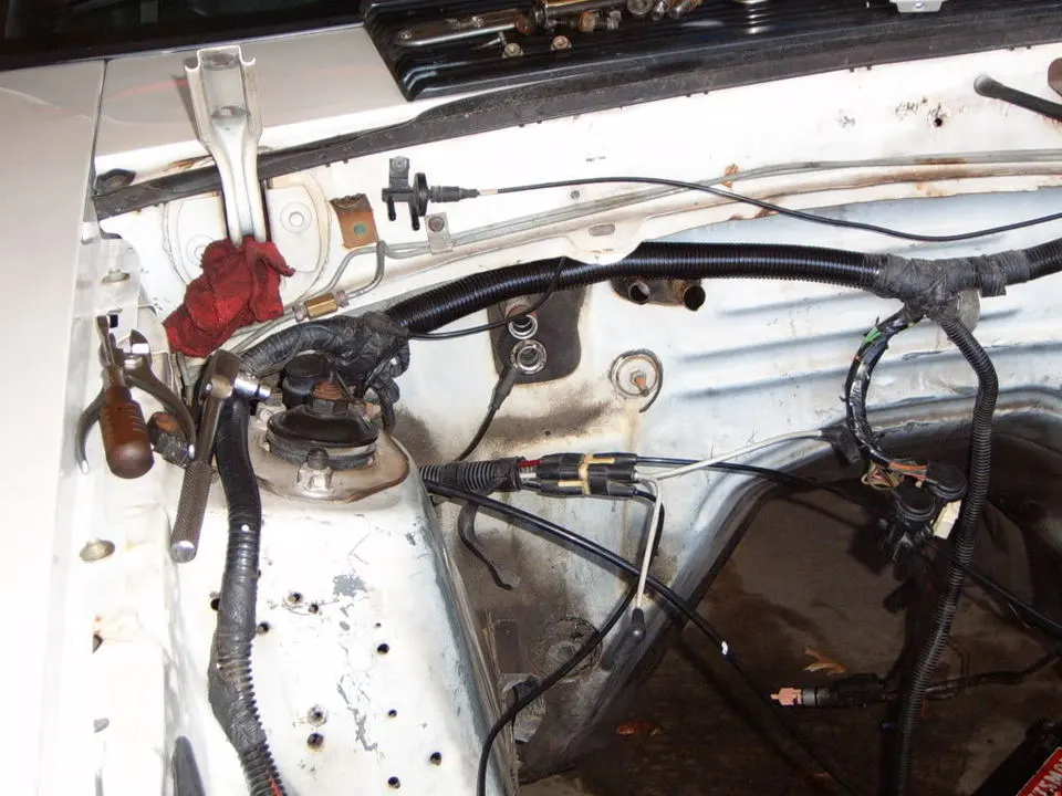

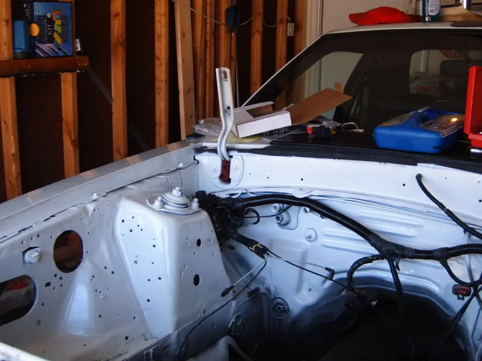

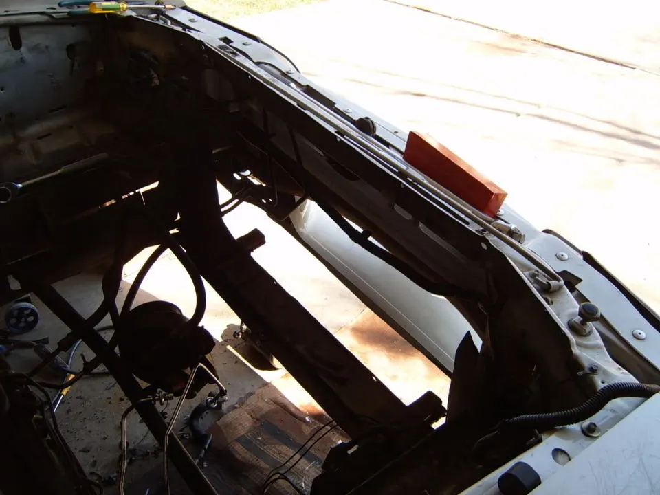

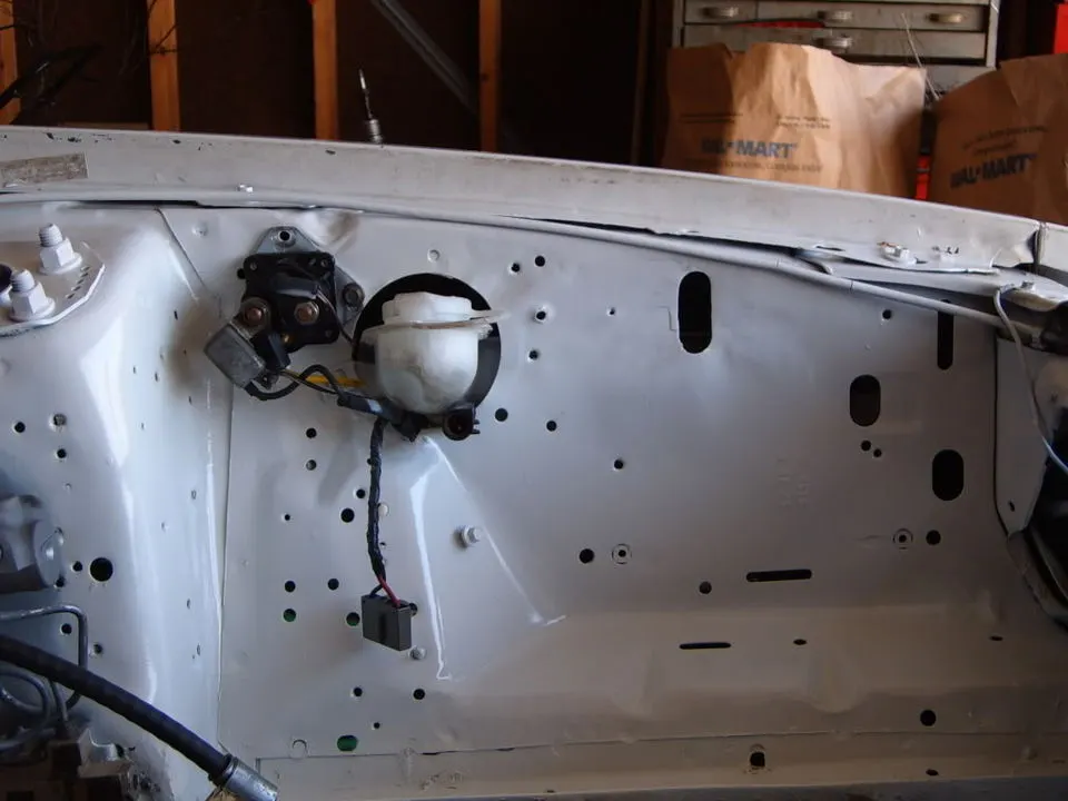

    well, i said i was goint to pull the a/c stuff out today, and i did, and was able to get the main harness to tuck under the pinch weld, looks a lot "cleaner" than it did
    [IMG]
    [IMG]
    im off to see the watchmen right now, when i get back me and a buddy are going to roll the car out into the driveway and trow some degreaser and a hose its way, hopfully get it looking white again, thinking about rattle-canning the bay once tis clean and everything is out of the way (dont have the equipment to hole fill right now, nor the cash to go buy said equipment, so it'll have to wait till the next time i pull the motor)
    btw, heres what i did with my starter solenoid. iirc the oe coil cover also hide the solenoid, so hopefully i can just loom/tape the wires going to it and it'll look halfway decent.

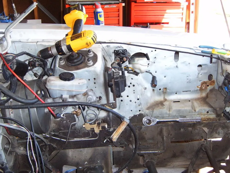

    ok, and here is where i need inspiration, or at least a couple ideas......
    i degreased the bay last night, got all the gunk above the frame rails gone, but the paint is in bad, bad shape, the drivers side still at least looks white for the most part, but the passenger strut is down to primer. the frame rails themselves and everything below them are still undercoated (that nasty stuff is everywhere, but at least theres no rust, so its done its job)
    ive got most everything out but the brake system (cobra booster=pita to get in or out), so i think im just going to mask off the frame rails, and repaint every thing above them white. hopefully the morons who painted the body actually did use the factory color, and whats left in the bay is just faded, otherwise i could be coming back into this thread cursing.....

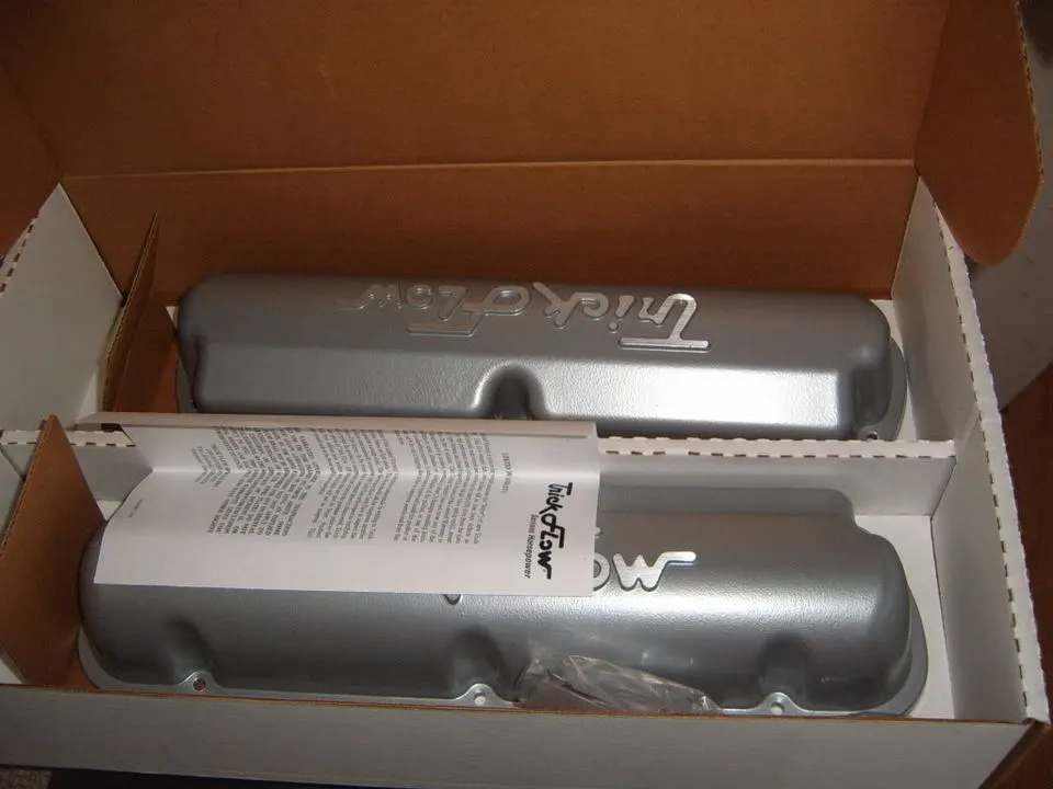

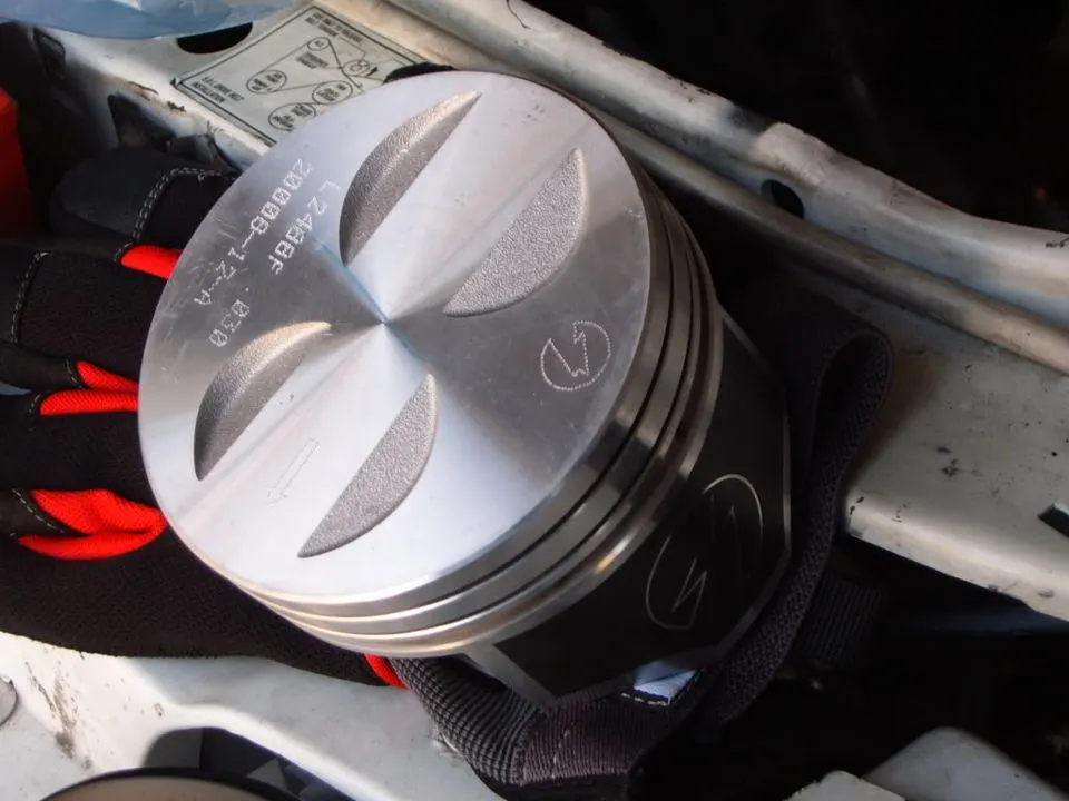

    also got some more goodies from the ups man today
    [IMG]
    [IMG]
    [IMG]
    cam installed
    [IMG]
    meant to bring my indicator from work yesterday to check the play, but i forgot, so it'll have to wait till monday.
    rotating assembly is getting balanced as i type this, so should have the bottom end put together this weekend hopefully.
