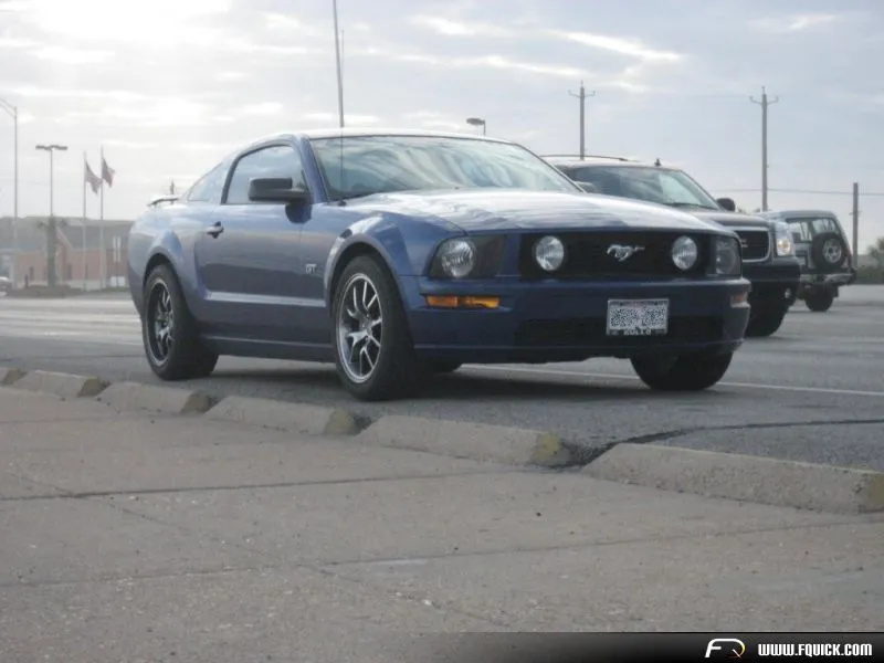

    If you just want to go for looks and go on the cheap get yourself a pair of Roush rear springs and do the install yourself. It'll even out the way the car sits and overall give it a better look then stock and it won't break your bank.
    This is how my car looked with just the Roush rears.
    [IMG]
