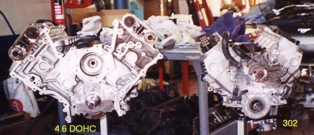

the mod motor in the 2010 mustang will fit between the shock towers of the 67-73 mustangs. it will be as tight a fit as putting in an FE engine, but it is doable.
rbohm, are you sure ? From what I was told, the new 5.0 is the same physical dimensions as the 4.6L. I was under the impression you had to at a minimum notch the shock towers to fit the 4.6L.

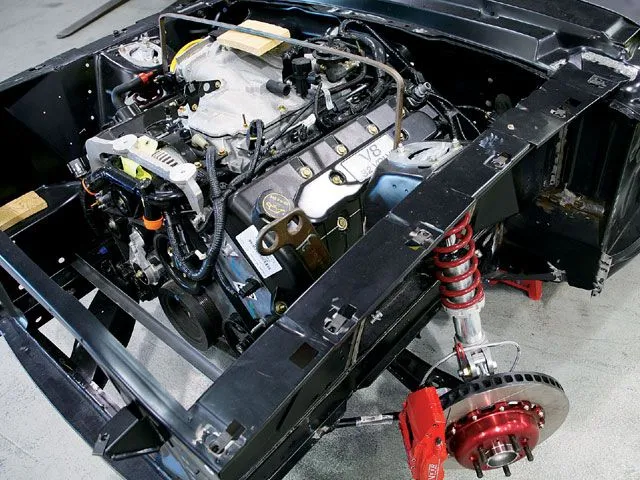

Either way, I'd like to see that. I have seen the Mod 4.6 DOHC in a 66, and even with the shock towers gone, there was only a few inches to spare. Hopefully, someone has photos. I found one.
Dynacorn makes a notched tower to clear large engines, but since the top is retained, you could still use an export brace, and strut type (instead of the Mustang II type) suspension.
the 4.6 is the same width as the 460, and that behemoth fits in the 67-73 mustangs nicely, though with little room to spare. i have seen swaps done with the 67-70 stangs using the stock shock towers, and with the 4.6 mod motor.
