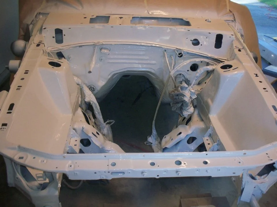

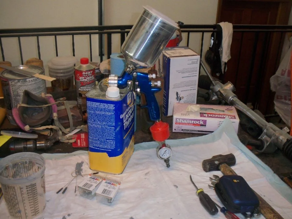

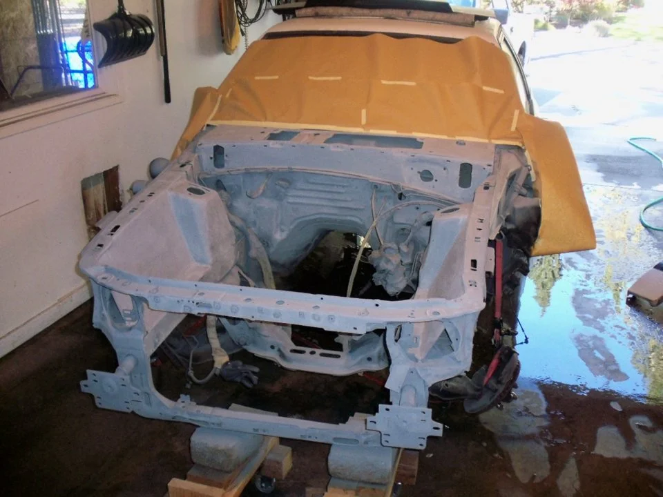

Got my high build 2K primer shot today. Should've been yesterday, got everything prepped and ready to spray and I open my gallon of primer and it's completely separated!! When I was at the autobody supply store I saw them take it to shake while they made my paint but I guess they forgot so that cost me a day. Had to take it to home depot and begged them to shake it for me and they did.
Anyways I laid down 3 wet coats and it came out great.

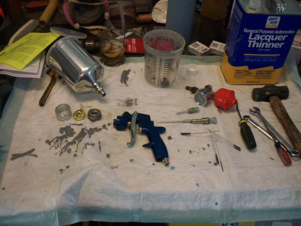

Immediately after shooting you got to disassemble your spray gun and clean it!!!
Cleaned up and installed tip for shooting my color tomorrow if everything sands out nicely tomorrow morning i'll be spraying my Valspar single stage after lunch.

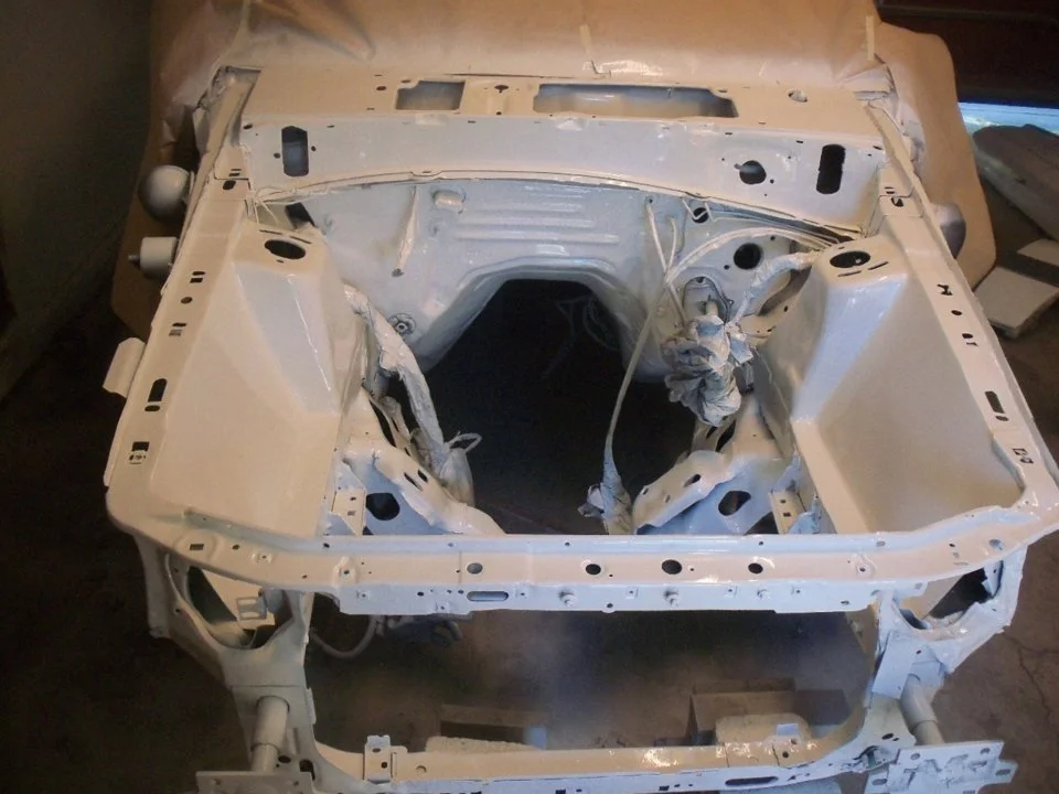

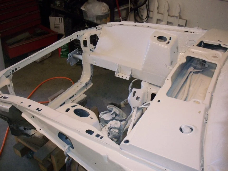

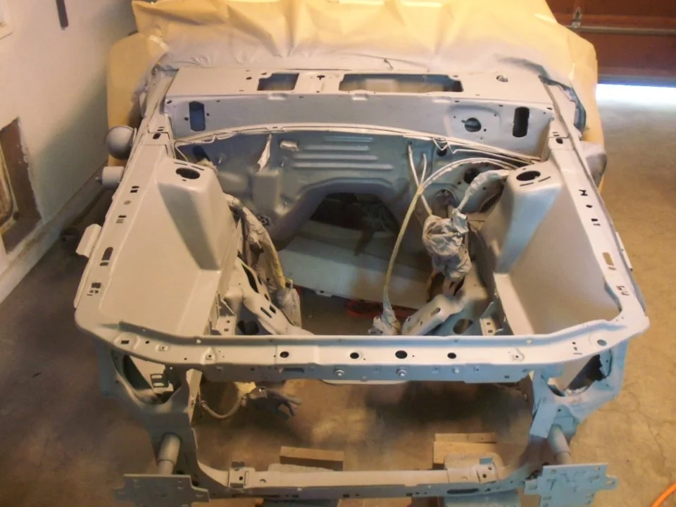

^^Thanks guys, lots of work going on, gotta get this 5.0 on the road in the spring and still have lots to do. Got my Valspar single stage WB (paint code) which is the same as my 05' Screw Oxford white sprayed today. I love what $5/hr baby sitting allows me to get done.
Here's some progress pics, came out great!

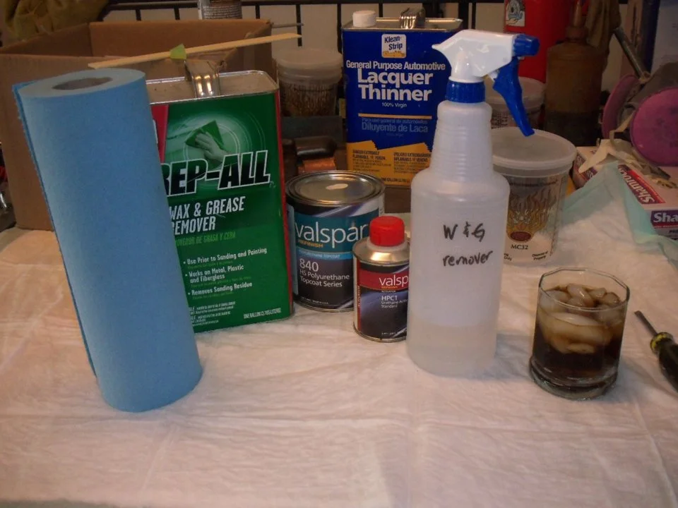

First, I sanded down the 2k primer with 320 grit then 400 grit with a block in some areas and by hand others. Block sand your flat areas and hand sand the curved or hard to get to areas. Scott pad other areas like the Kmember that you don't car about "finish" quality. Blow with compressed air, water down you floor with a hose to keep dust and over spray settled down. Then go over your area that your going to paint with wax and grease remover. Once done let it flash for about 20 minutes which allows you go to get your compressor charged up, paint mixed and gun ready.

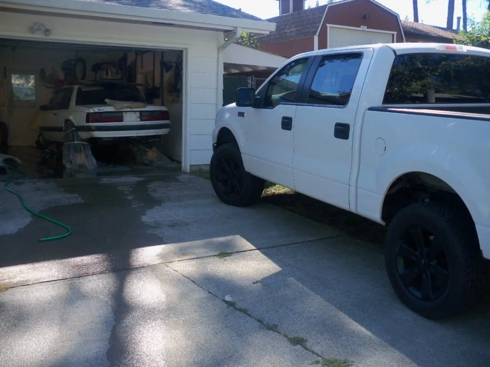

I'm painting my Mustang to match my 05' Screw. They will be "twins".

Yes the entire car will be done this color in Valspar single stage paint. I tried to get PPG Concept but I heard they stopped making that line of SS paint when I searched around for it in my area so I went with my next best choice. @RacEoHolic330 , have any insight on the paint being discontinued?

Thanks bro! There's a couple flaws in the paint but overall i'm happy with the results and stoked to get the engine ready to get installed soon. I'm thinking maybe I'll change my mind and spray the rest of the car when it warms back up in the spring.
