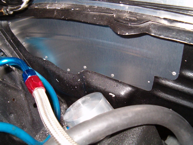

I would weld in a 1 piece firewall plate like the one Scott Rod sells with everything out of the car. So much easier than after the dash is in. Plus you don't risk the chance of sparks setting your nice interior on fire.
I think what you're talking about only goes above the seam on the firewall, the AC line hole is below it. Unless there's another panel I don't know about. My interior is removed except the dash and steering column.
They sell this as well. For 20 bucks it beats trying to fab up one.
http://scottrodfab.com/foxmustang.html
I think it blocks the heater hoses too. I'll try to fab something up that will look good while not melting my dash. Don't feel like pulling the dash yet.

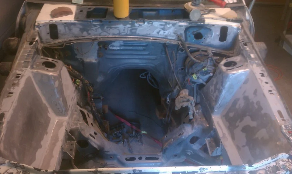

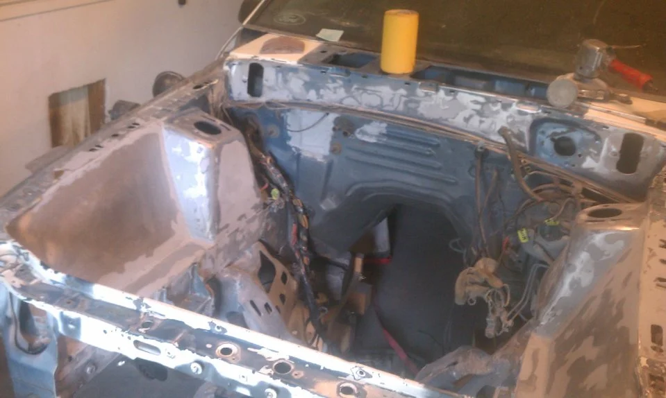

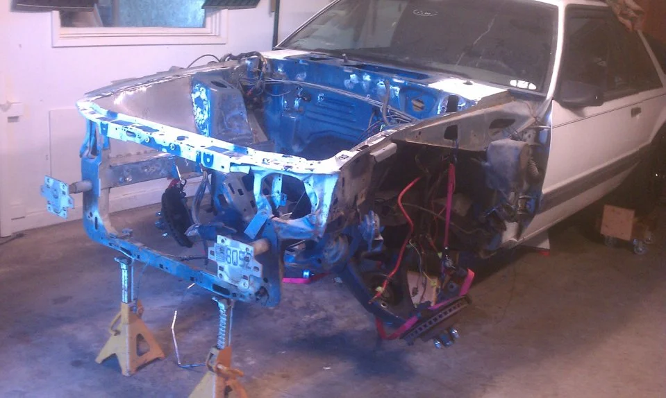

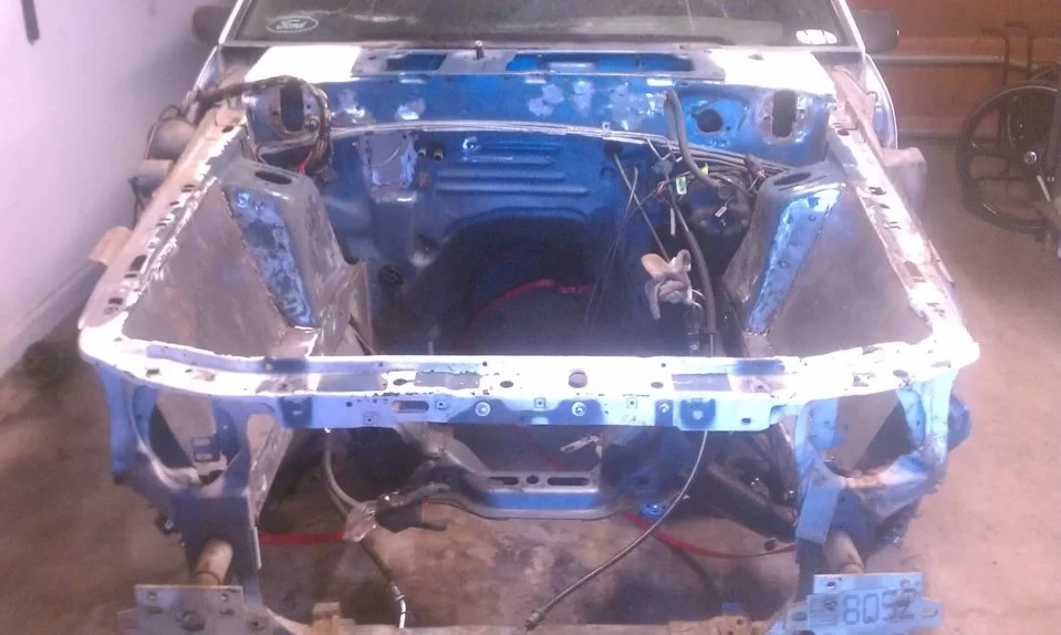

It was an awesome Labor day weekend and I hope you all had likewise! Got lots of work done this weekend on the engine bay plus numerous other things not related to the Coupe.

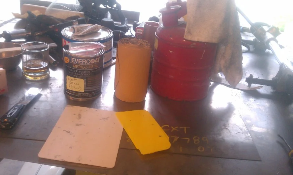

First off I'd like to say Evercoat Metal2Metal is bad ass! Really strong and sands easy. Pricey but worth it in my opinion.
What I did.
1) Blow out area really well with compressed air blow gun
2) Wash down engine bay with warm water and mild dish soap (dawn non scented). Let dry thoroughly.
3) Wax and grease remover. I prefer putting the W&G remover in clean spray bottle, spray area and wipe away with clean lint free shop towel before it dries. Discard towel and use clean one each time. If you keep "cleaning" with a dirty towel then you're not really cleaning are you?
4) Sand your work area
5) Blow everything clean with compressed air gun
6) Apply Evercoat Metal2Metal per mf'r recommendations.
7) After recommended dry time, sand.
8) Blow area off again, apply body filler (bondo)
This is as far as I've gotten over the weekend.
Hopefully tonight I will get the Bondo sanded down, scuff everything up with a red pad and be ready to shoot my primer. My self-etch primer had been sitting for almost a year so I brought it to work today and stuck it in our paint shaker a couple times. Good to go now!!! Hopefully be shooting color this weekend!!!

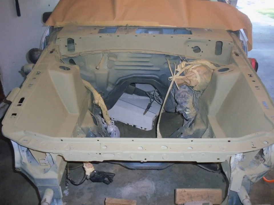

Finally got to spray this weekend. Got a couple coats of etch primer laid down. I'm upset with myself for forgetting to get some thinner while I was at the autobody supply store. I ran out and wasn't able to clean my gun all that well and I kept me from spraying my 2k primer. Temps are about to cool down so progress will stop till later this next week.
Reactions: FoxtrotTangoWhiskey
So are you still glad you did it this way over buying the prefab panels?
If I had to do it all over again I'd get the SR panels. I love the way mine came out, the work wasn't really all that bad but I like the look of the panels that follow the original engine bay lines a little better. They open up the engine bay more too.
