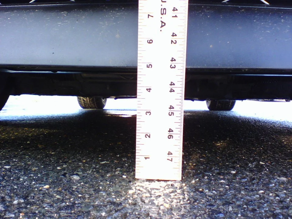

    Here is my front ground clearance. A 12 oz soda can is about 4 13/16".

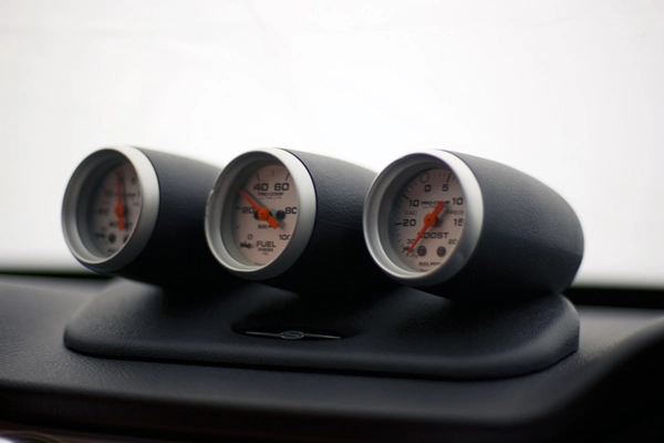

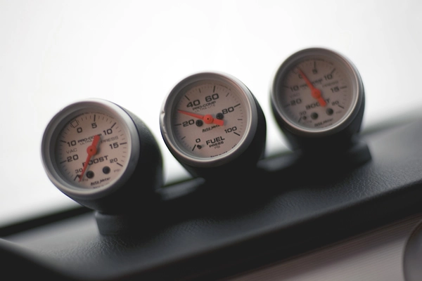

    Also, no matter what route you go with forced induction, you are going to NEED at least 3 gauges. Wideband (digital) Air/Fuel ratio, a vac/boost gauge, and a fuel pressure gauge. Those are the three that I would probably run but of course you can run more if you want more piece of mine (Oil temp, water temp, etc...). I would suggest getting the SOS triple gauge a-pillar pod or the SOS triple gauge dash pod.
    www.speedofsoundllc.com is where you can buy them. They are more expensive than other companies, but they look like they came with the car is how well made they are.
    [IMG]
    Non-drill version of the dash pod:
    [IMG]
    Drill Version of the dash pod
    [IMG]
    the drilling is required for the wires that go to the gauges. If you get the non drill version it has a piece on the back of it that runs to the heater vents where the wires would go through (from my understanding).

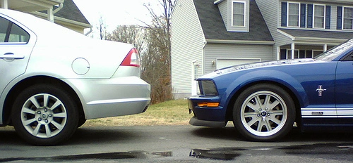

    Here is an undoctored pic of the front of my car compared to the back of a stock '07 Milan.
