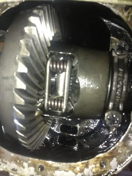

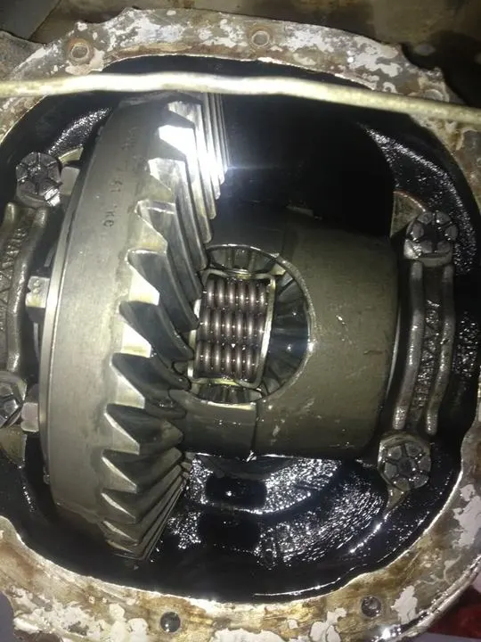

So today, I pulled the cover on the rear end to see what was in there. I didn't see any brand markings, so I thought I would see if anyone could identify it from pictures. Kinda crappy pics, but maybe someone can tell.

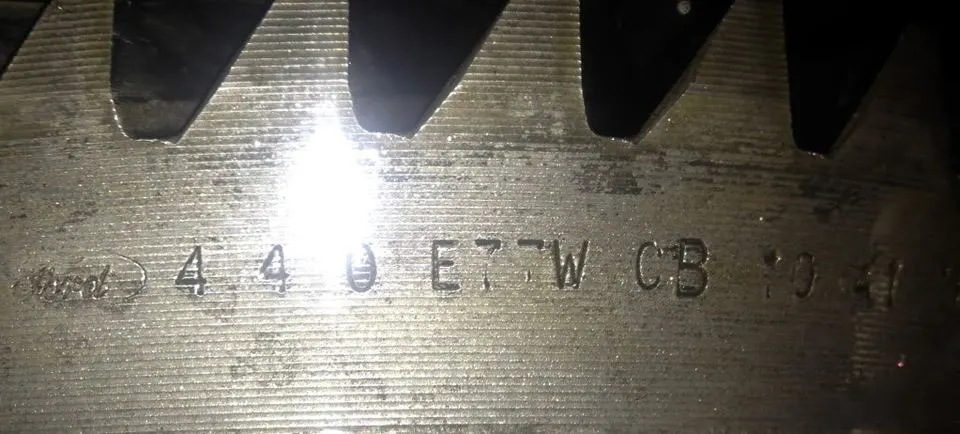

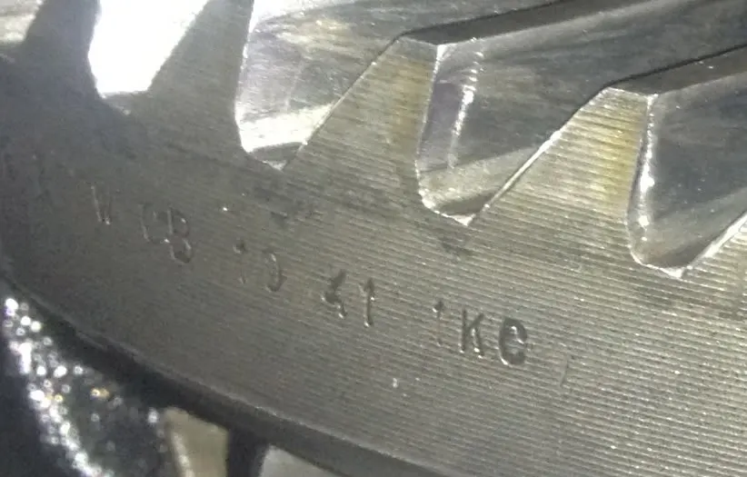

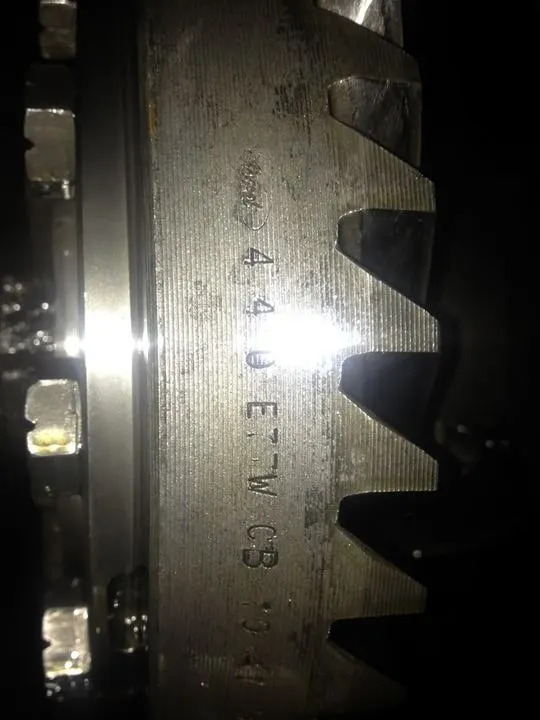

Its definitely a Ford gear set. From what I can find, the "10" and "41" stamped on there should indicate 10 teeth on the pinion and 41 teeth on the ring gear. So between that, and also turning and counting, that should indicate 4.10 gears. I'm really wanting to know for sure what carrier that is. I'm probably going to go ahead and take it in and have 3.73's put in, I guess he can tell me for sure what I have.
