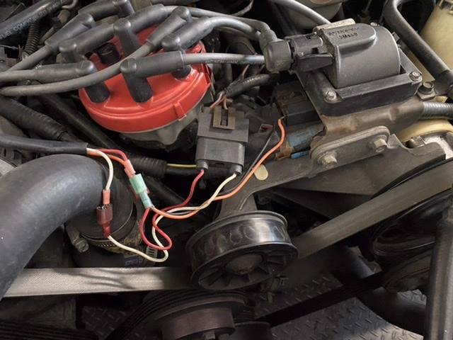

I‘m trying to get the wiring reconnected back to the stock configuration after removing an inductive boost retard MSD box. Attached is a photo of the current wiring. What do I need remove or reconnect to get everything back to stock? Thanks in advance.

Unplug the connector at the coil....and the connector by the distributor. Plug the wires coming from under intake into the coil. Done.
