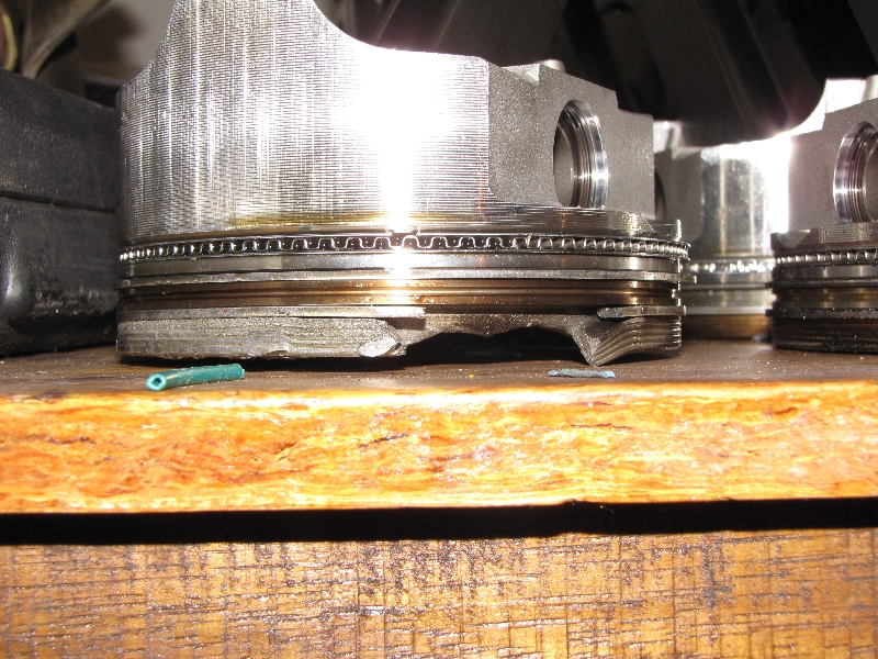

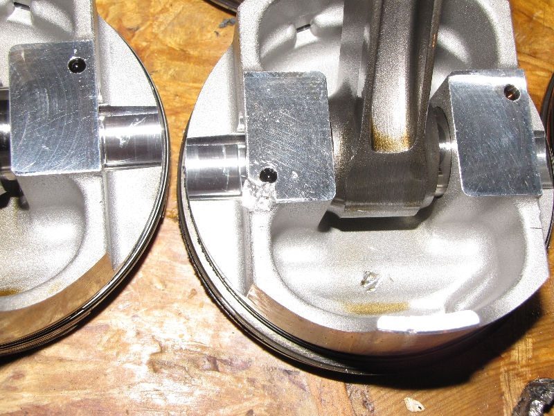

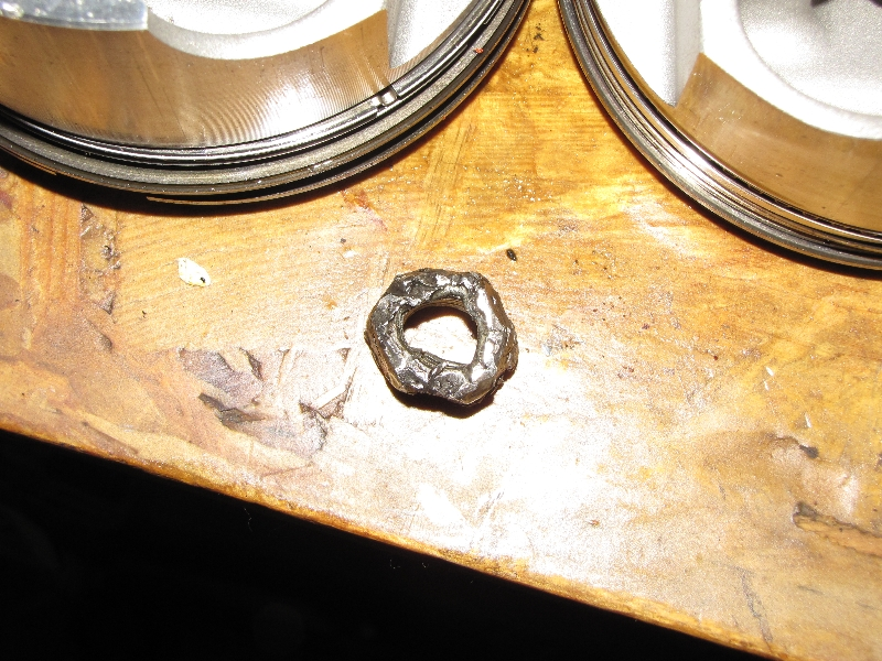

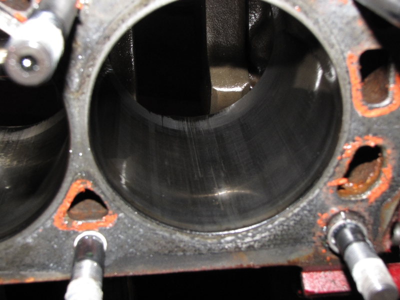

    Almost finished tearing down my engine and it looks like the block is toast. It'll definitely need .060 over, maybe more. The nut that holds down the oil pickup tube on one of the main studs came off and dinged up a couple pistons and the windage tray. Not sure if that's what caused it break... I haven't taken off the mains because I need a pulley puller to get the balancer off, but I think the crank and rods are ok. Here's some pics.

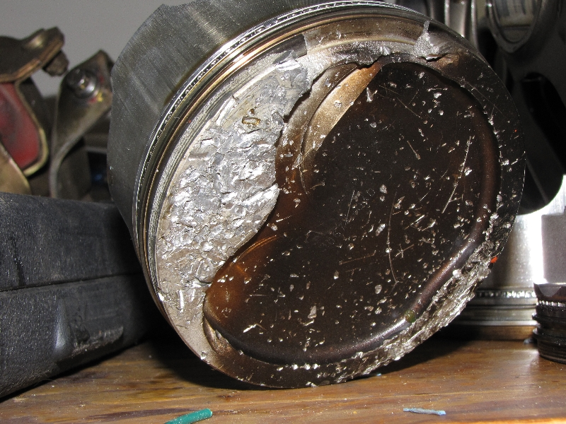

    A couple pistons look like this....

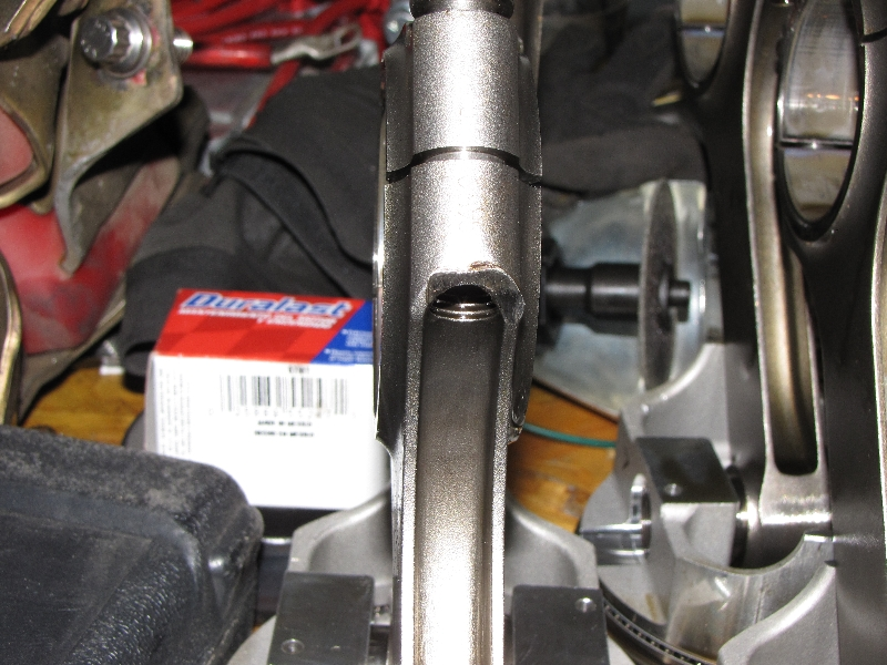

    And all the rods have this flat spot in the same place...
