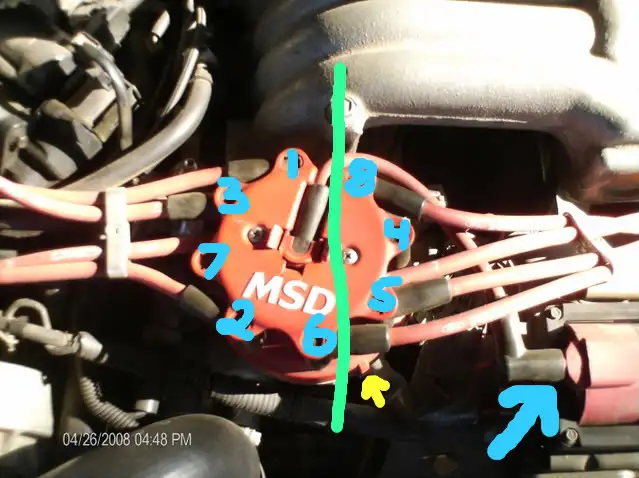

  9. you sure it's just not way out of time?
    here's a pic of mine.
    comparing mine and Mark's(the_mustang) picture,your's is in a different position.
    see the tab on the cap(yellow arrow),our's is to the right of the green line,your's is up front.
    mine is a reman from autozone with an MSD cap and rotor,set to 10*BTDC.
    could try setting the engine to TDC again,use the intake manifold bolt as a referance and re-stab the dizzy.
    hope this helps alittle.
    good luck.
