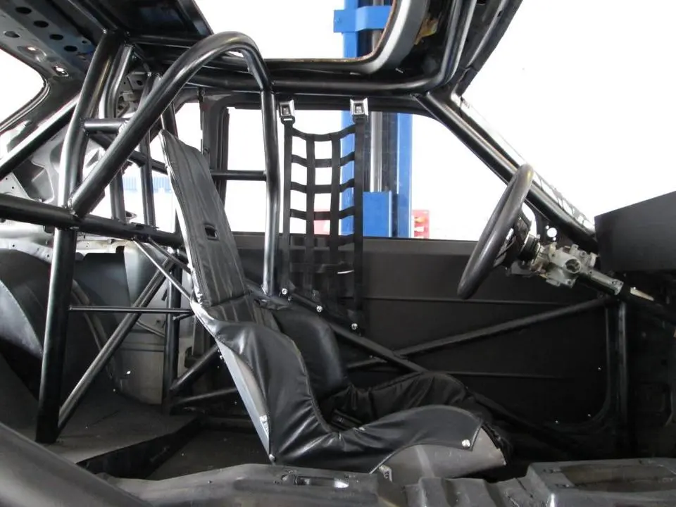

  3. Going with mostly a matte black finish on the inside. Should be easy on the eyes and reduce glare and not be as hot here in the FL sunshine.

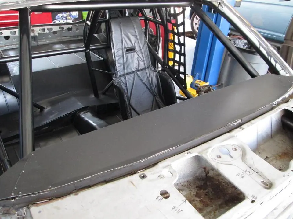

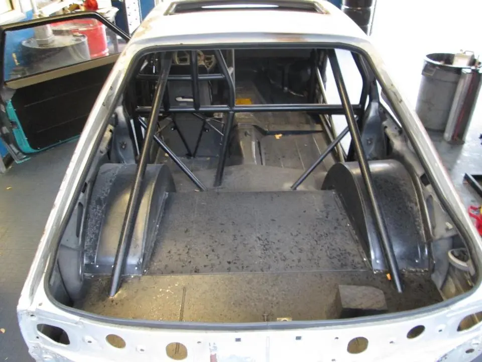

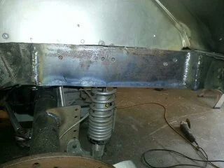

    Frame rail filled in where it was notched for the mini tubs.

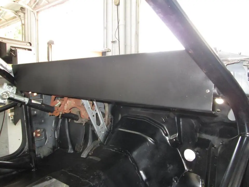

    Cover for the top of the firewall

    Like I said, I went with a matte black to be easy on the eyes while I was in there.

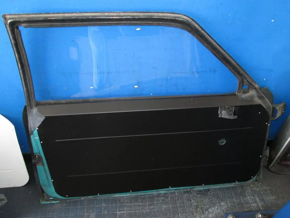

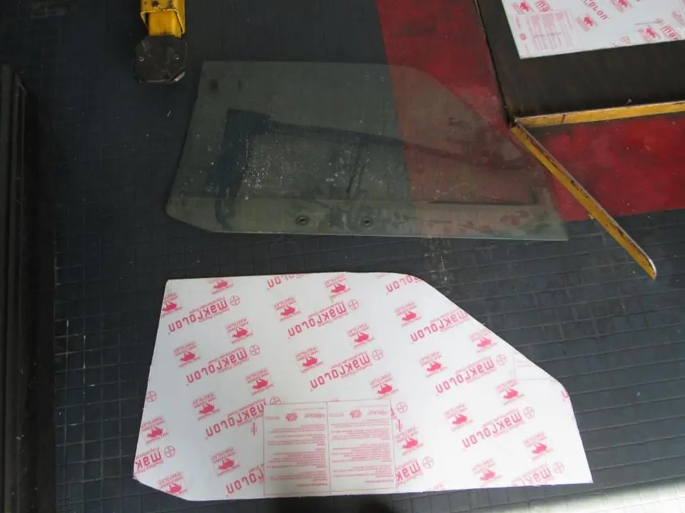

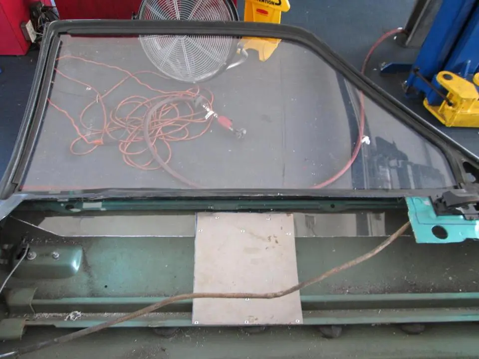

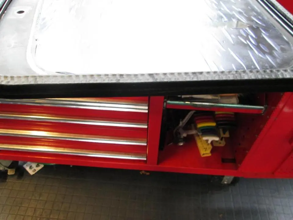

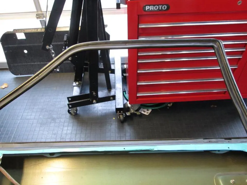

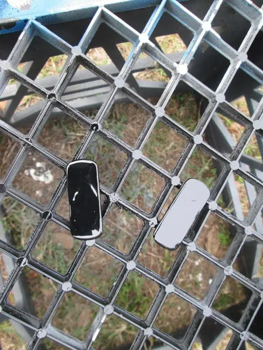

    Finished doors with lexan windows. I just need a grommet to fill where the window crank was since I decided to gut the doors and the small side mirror delete plate for the outside. Then, paint last, of course.
    What I used to cut the lexan.

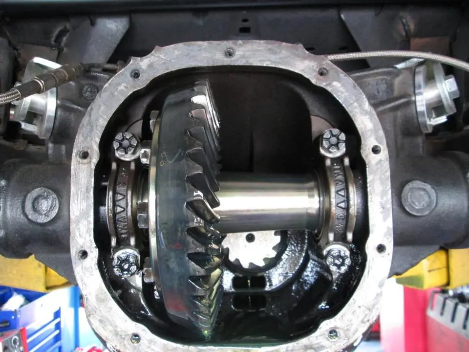

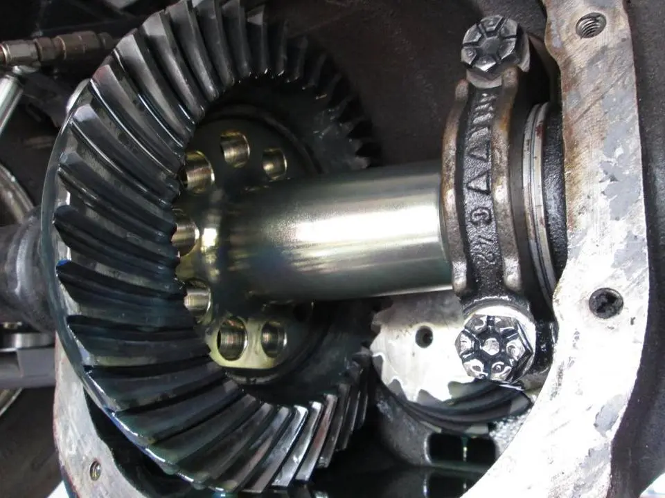

    I did FINALLY decide on a power combo. Also, I checked on the rear end to see what gears were in it and luckily they were 3.73's so, they should go well with my carbed, stroked and turbo'd 351W.

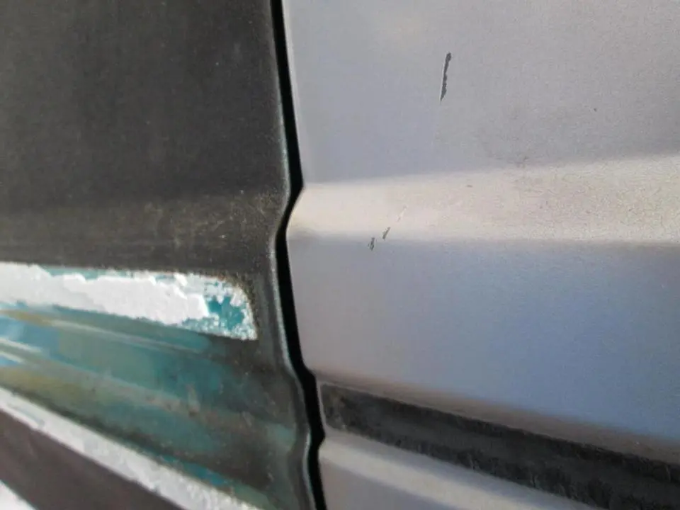

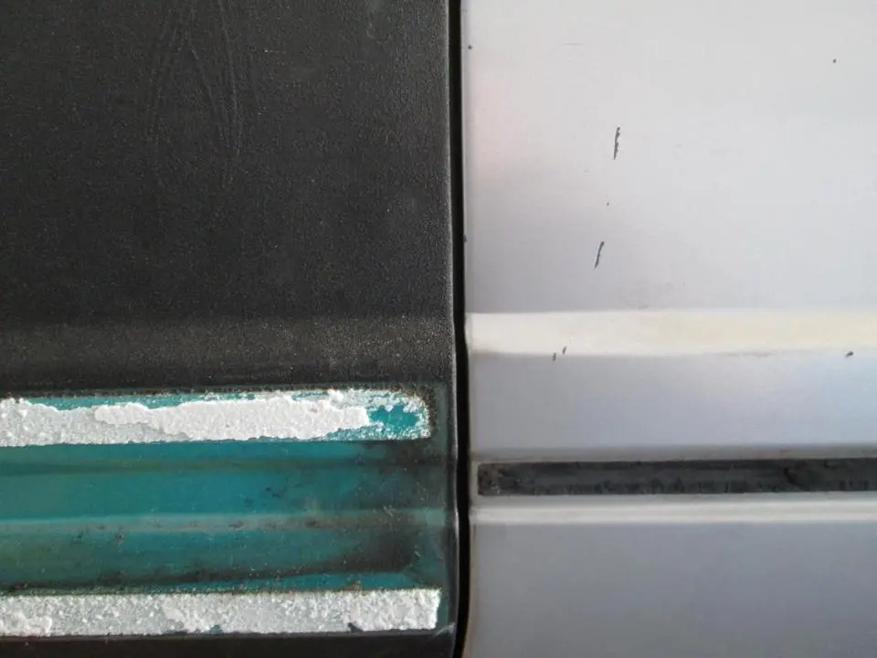

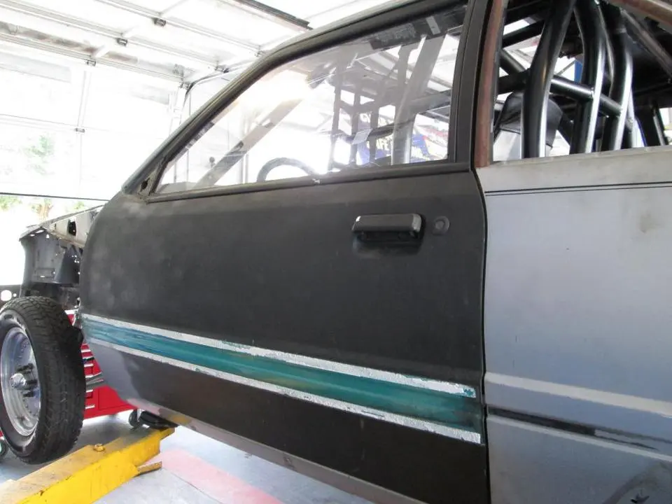

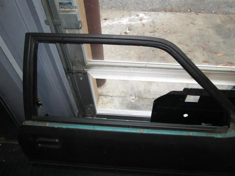

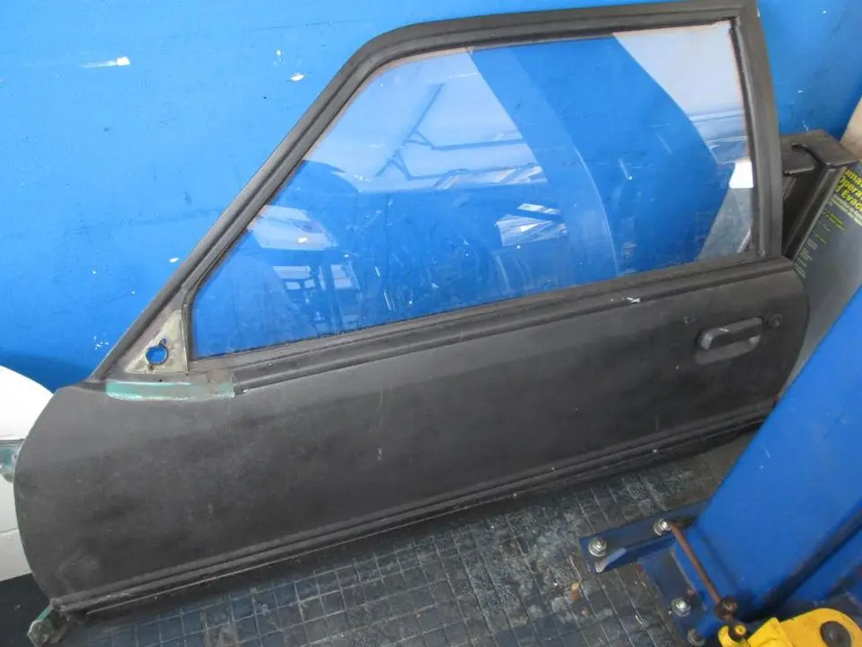

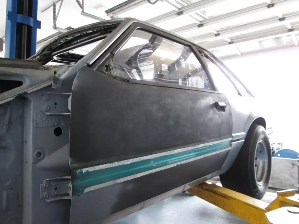

    The doors are going to have to be taken down to bare metal bc the douche canoe that had them before me painted them with that truck bed liner paint. Oh well. cant beat $50 for a pair of rust free 89 Fox doors. I just need to add some sort of handle to the insides so that I can close them if I am at the track alone or, my help isn't close by.

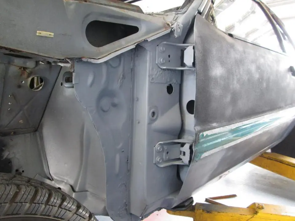

    Starting to hang the door
    Aligning the door
    Checking the door gap

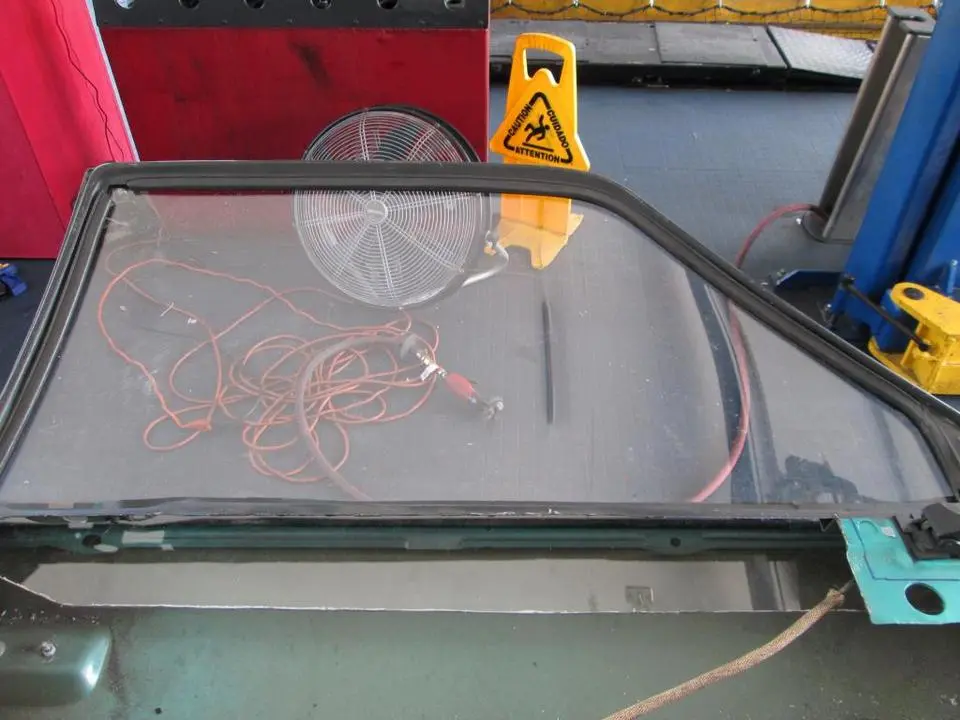

    I have a set of 87-93 1/4 windows to go behind the doors

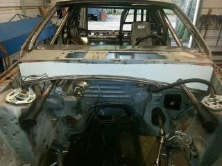

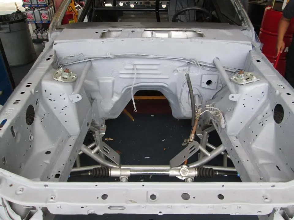

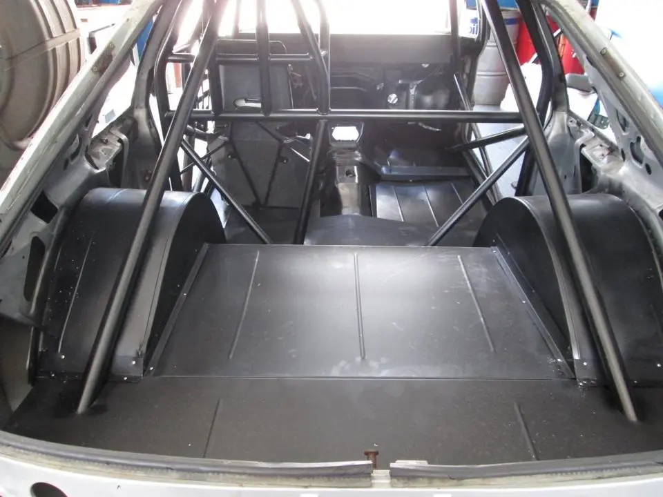

  8. Took all day today doing the engine bay. All I have left to do is remove the C/C plates (I am still going to paint them to match the engine comapartment), k member and struts so I can finish it off. Not bad, if I do say so myself for tin snips, old sheet metal laying around and rattle can primer. Any suggestions on the color of the engine compartment? I was thinking either a semi gloss back or grey. The exterior color is still TBD.
    Final product after all day sanding, trimming, cutting, drilling and hand riveting. I really need an pneumatic rivet gun. I stopped the 2 bars coming out of the firewall and had them welded directly to the strut towers. The other end of the bars are welded to the cross bar behind the dash. I figured (and the chassis guy) would experiment with this set up. If you notice, there are tabs at the ends of the bars, those are for a strut tower brace that we will fabricate up after the motor/turbo are in rather than running the bars all the way to the front frame rails. I will be needing that space anyways.
  9. Why no fill in all those ugly holes on the strut towers and the inner fender panels while you've got it torn down this far? Now would be the time. And I do hope you plan on doing some wire hiding as well?

  11. I have something planned for both of what you just said.:nice:

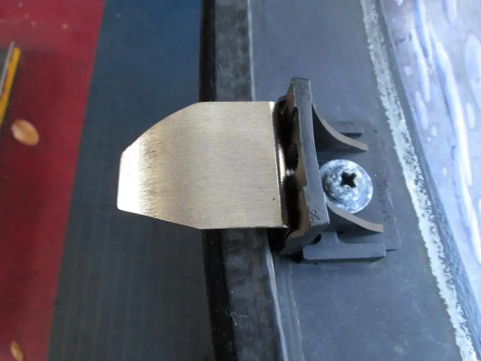

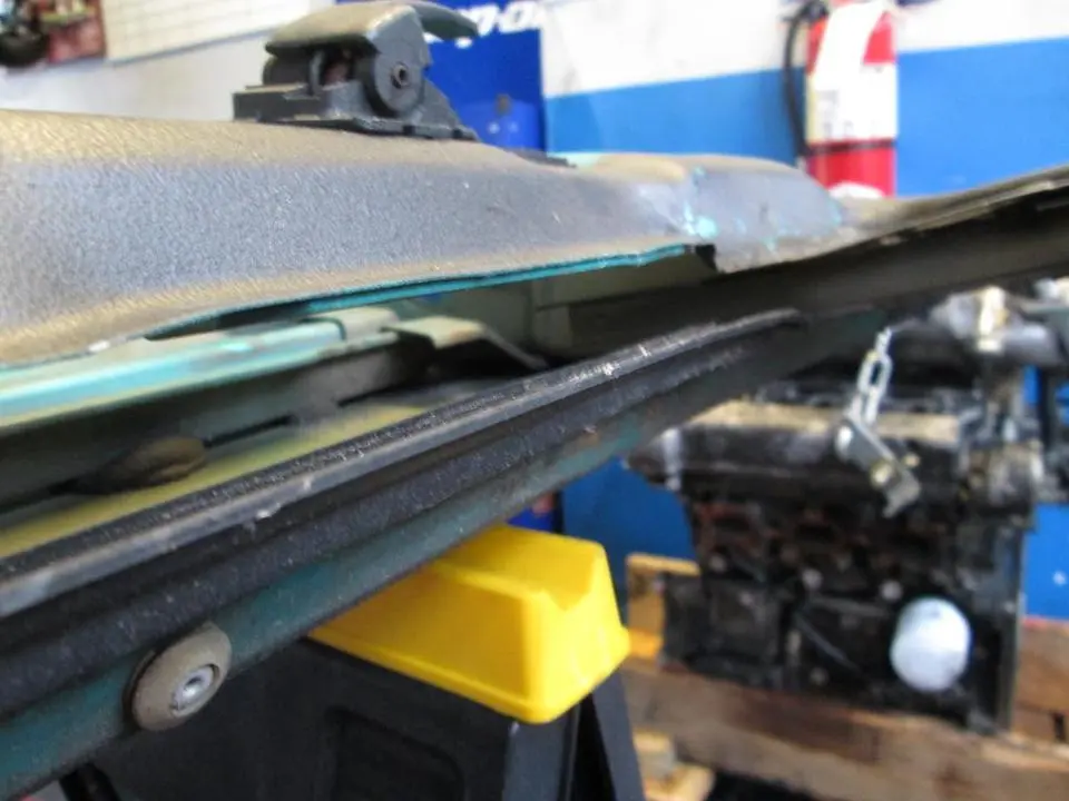

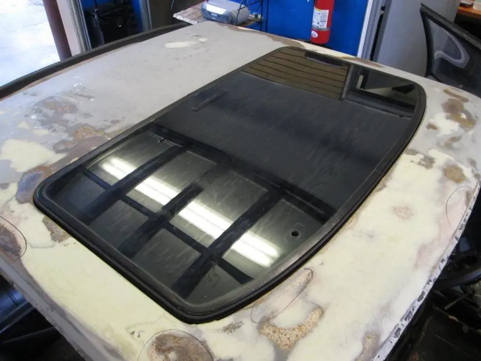

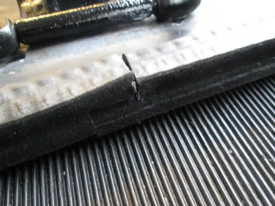

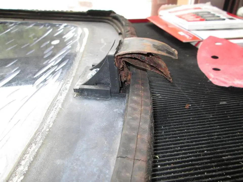

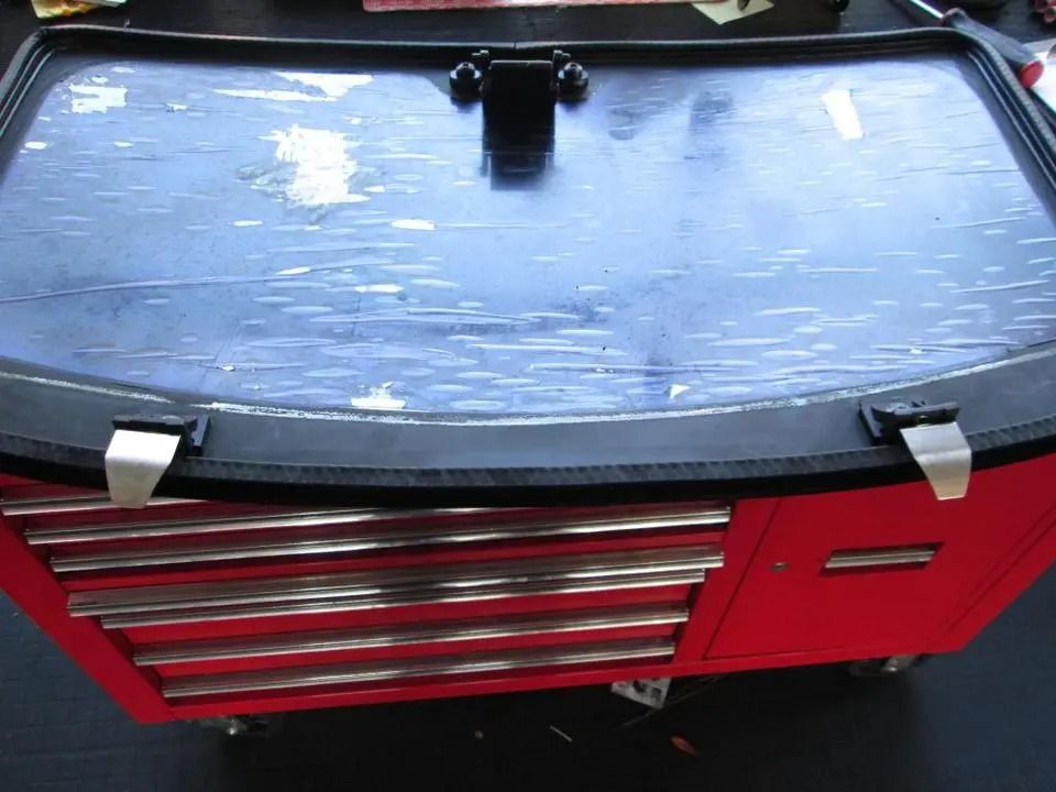

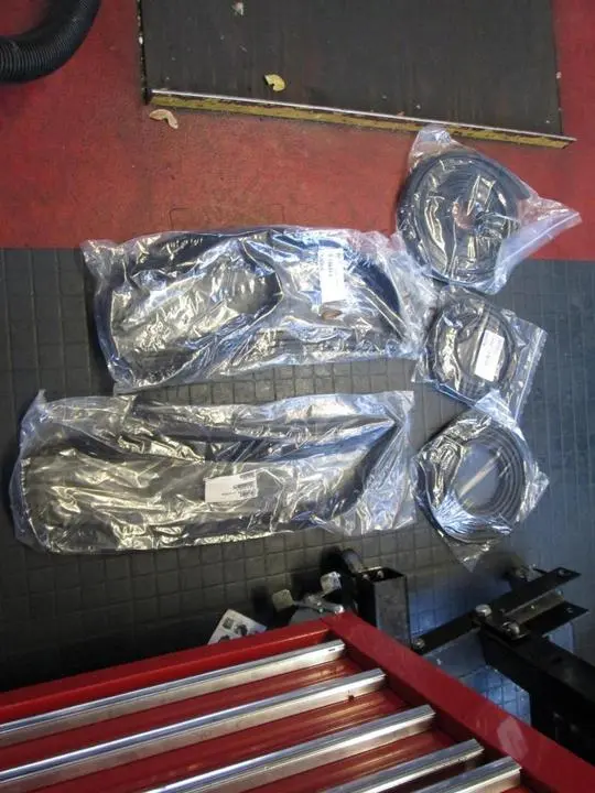

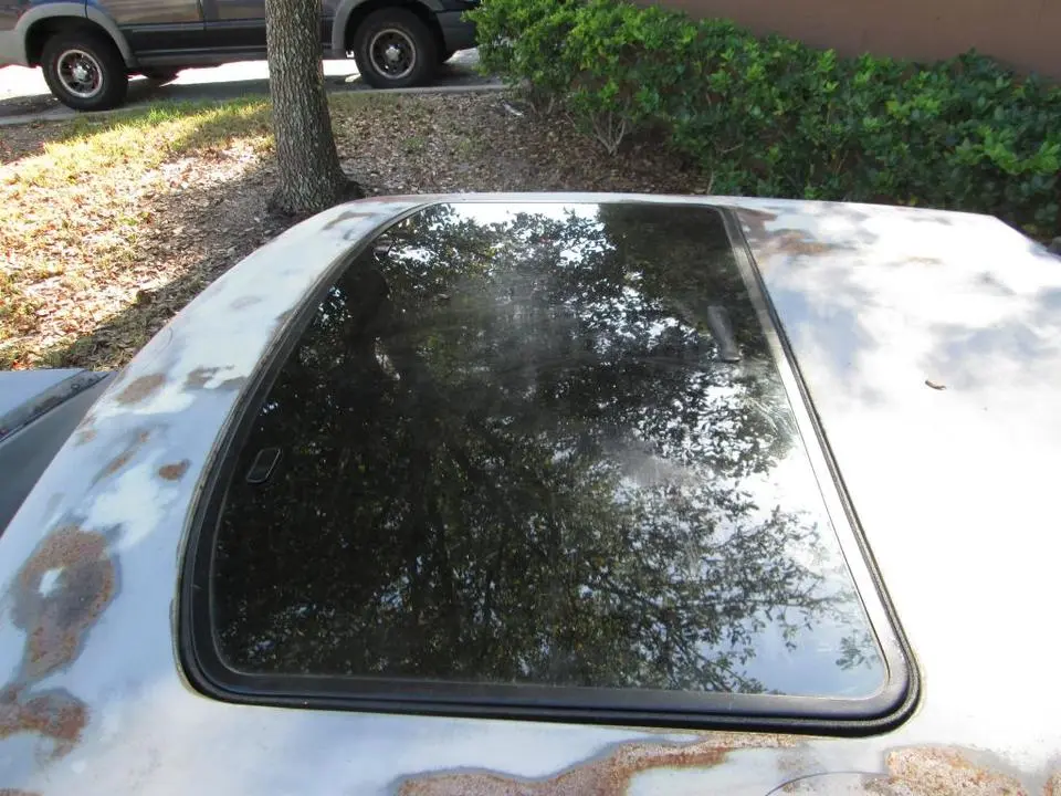

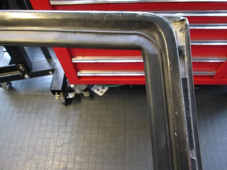

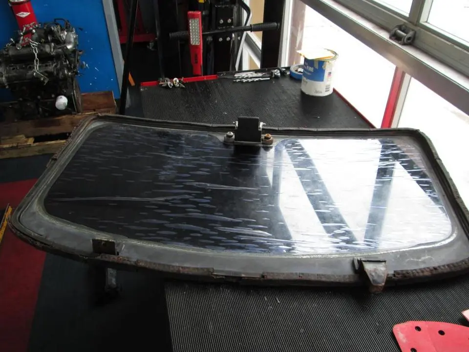

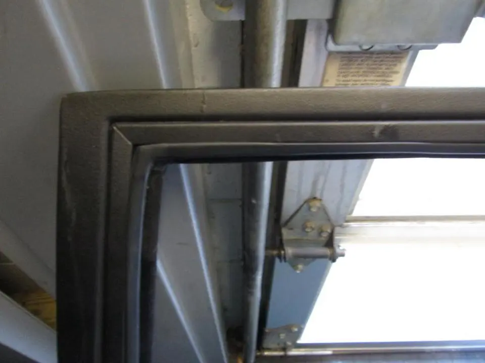

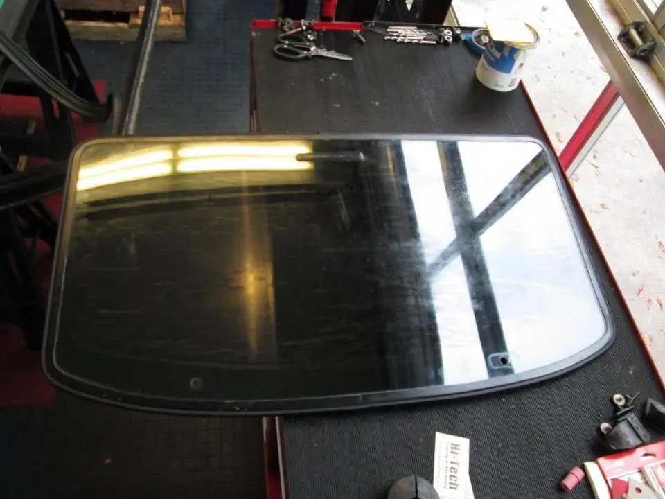

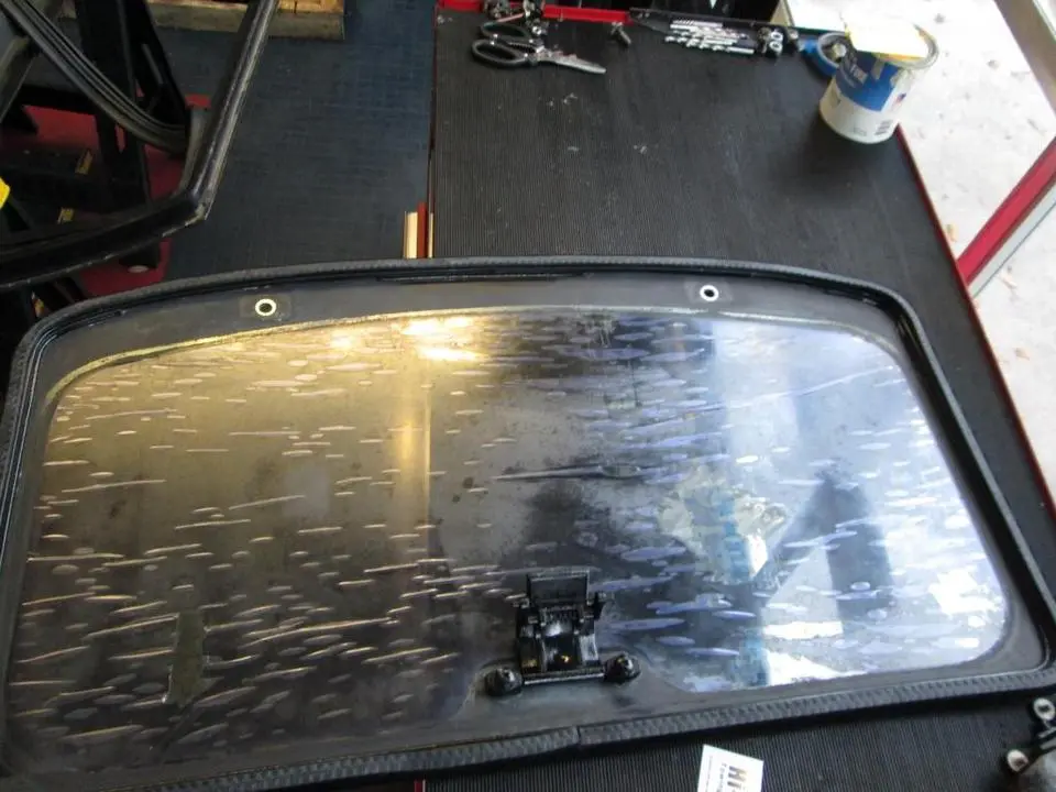

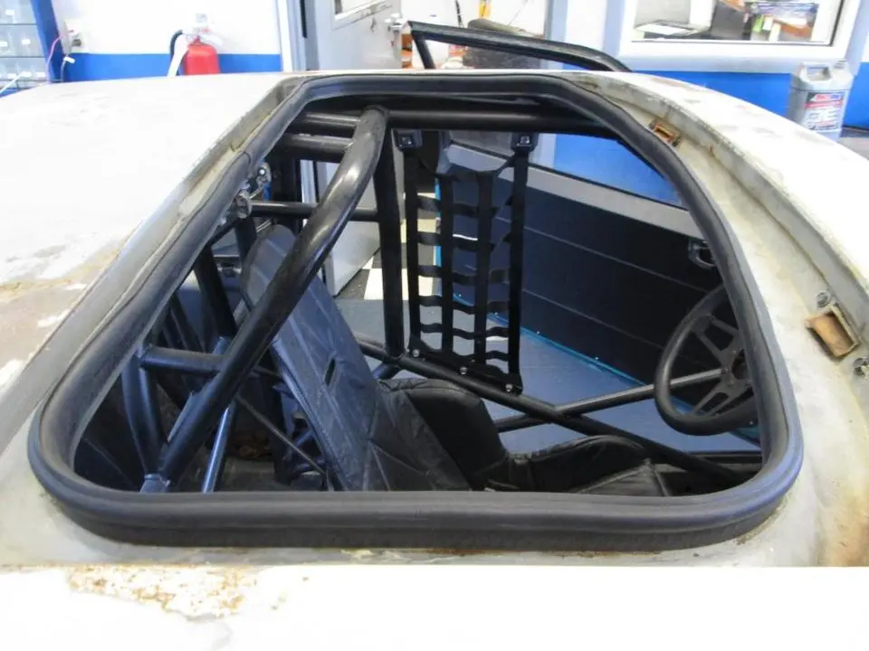

  15. Well, between Army, kids, family and pulling extra weight at work from cutting everyone elses' hours (holiday season is nice and slow), I am exhausted. None the less, I am trying to find time. Sometimes it comes in 30 minute spurts or I can sneak a few hours in. Anyways, the body work is taking me forever! Got some new weather strip in and "restored" the sun roof. I was able to salvage the old hardware (LMRS wants a fortune for that crap). All I have left to do is get the old tint off and I am just going to replace it with black vinyl.
    New window channel, hatch and sun roof weatherstrip courtesy of LMRS
    Hatch weatherstrip

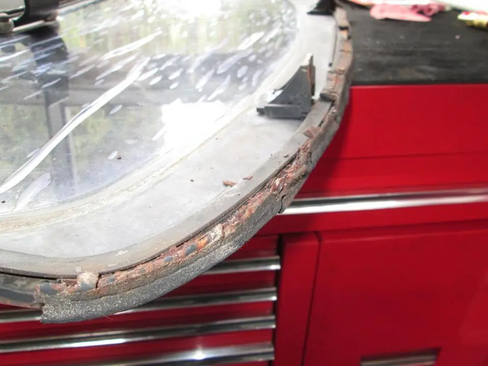

    Old sunroof

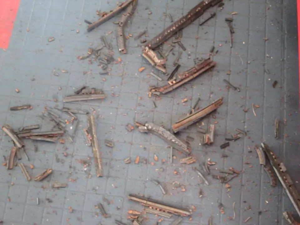

    Old retaining clip. The other one was rusted off completely
    Yes, that is the old weatherstrip
    Old weatherstrip again
    Old hardware
    Cleaning up the old hardware
    Freshly painted
    Cleaning out the passenger door (I have the drivers door to re do)
    Body side of the sun roof
    Like a glove!
    New sun roof weatherstrip
    So much cleaner
    Painted and cleaned
    Test fitting the new stuff
    New window channel weatherstrip
    No more cracks!
    No more wind noise! Now, to do the other door...
    Now, to get that stupid ass truck bed liner paint off the doors

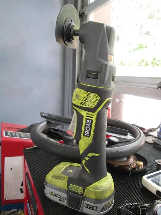

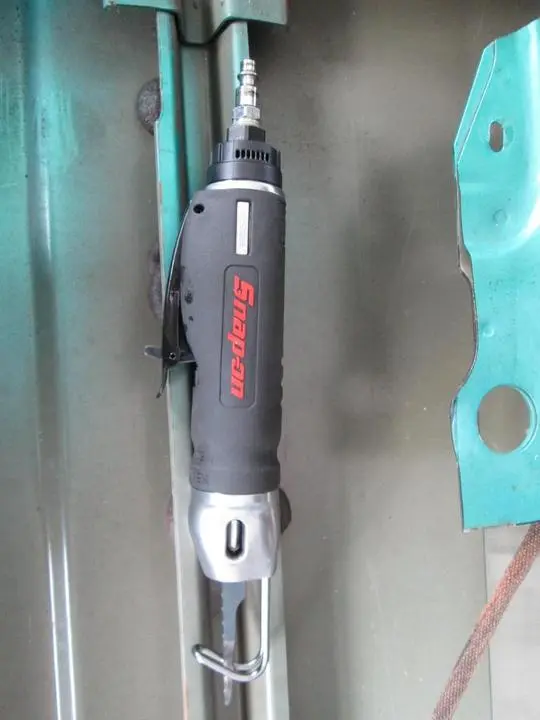

    New tool of choice for sheet metal and lexan. I probably paid too much, but hot damn! This thing is f'n sweet! Gear driven and variable speed. Mmm!
    New sunroof retaining clip. Thank God the plastic did not break!
    Now, to work on the old tint
    Final product. Back to more body work!
