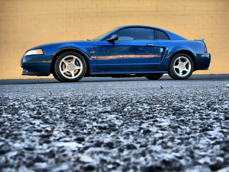

    yeah, i got it back and its finished..BUT.............
    1. the day i got it back i was having o2 sensor issues
    2. during the fix of the o2 sensors i found that my intake manifold was cracked since i dont have the aluminum crossover...
    3. it never got painted due to my hood taking a month to get here...ordered june 7th, supposed to arrive the 29th...the car was supposed to be painted 4th of july weekend and i was supposed to pick it up the 10th... i left on the 12th, the hood came on the 13th.. :notnice:
    4. didnt put passenger side gasket on.. so that just got done today cause it sounded horrible
    i never got to pick it up from MPH...my parent ended up having to cause i couldnt get off work...dyno sheets were supposed to be in the car when i got it but after the car went to my parents they dissapeared..so i was going to take it to the place i had it dynod a few times before but that's not a wise idea with a cracked intake manifold...
    but i can tell you that she pulls like a mofo and all i did the first day when i had it was giggle like a little school girl at the power...but right now if i drive it ive been keeping it in the low rpm's cause of the intake manifold....which ill be taking care of next week....i hope....
    oh i looked into widening the rear wheels and it was $250 a wheel....so i think im just gonna order a set of anthracite fr500's instead
    and for some reason, im the only person with a prochamber and flows that has a car that sounds like a prius...wtf? is that cause i have lt's?
    here's the only pic i have of the car since i got it back...ill post more up when i get my crap squared away and my camera back since im in the process of moving
    [IMG]

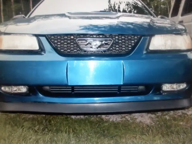

    dehh.. forgot i had a crappy cell phone pic of the front that kinda show the intercooler
    [IMG]
