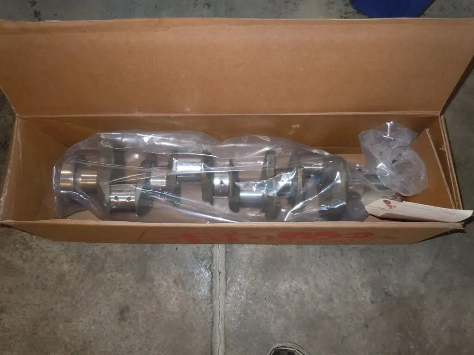

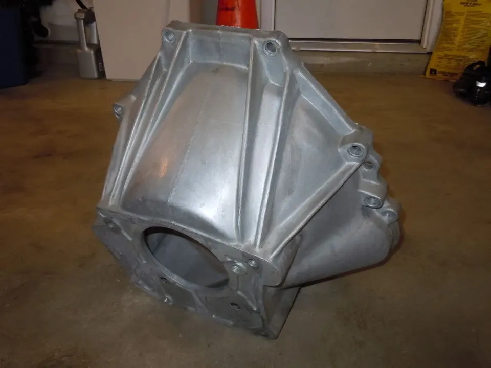

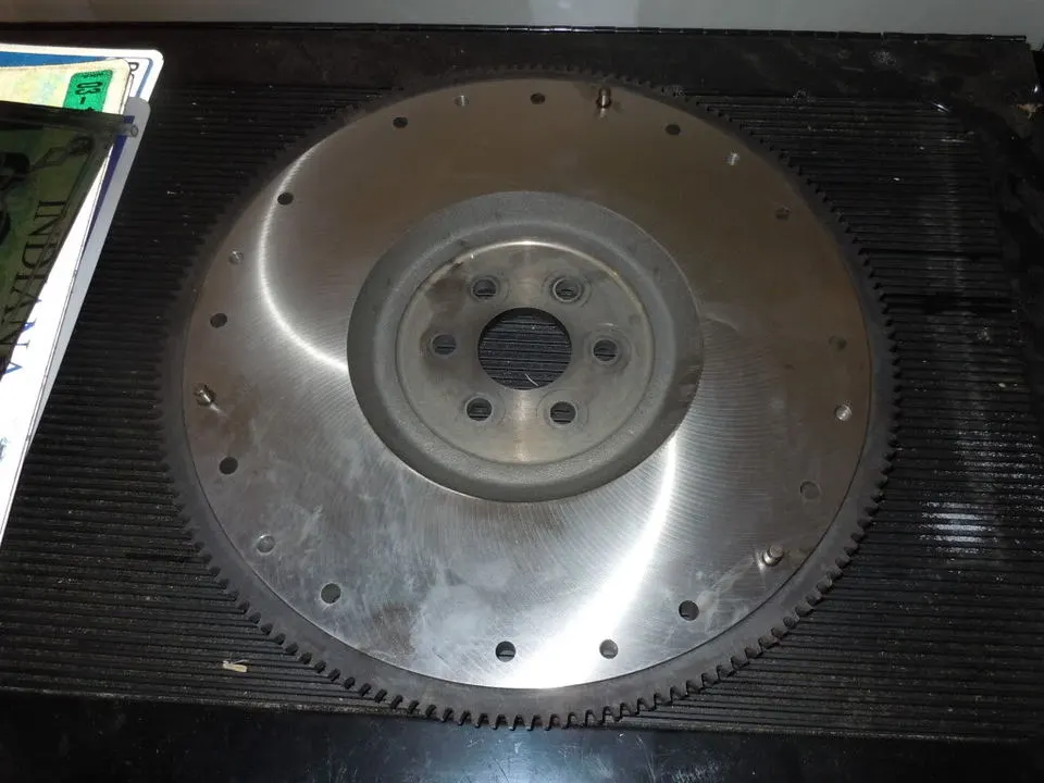

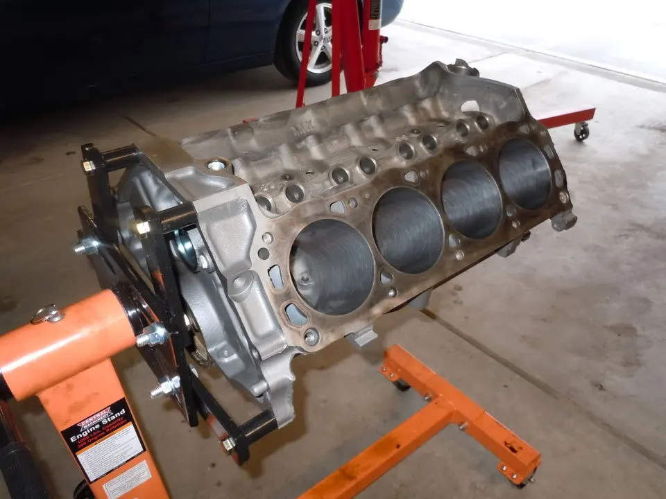

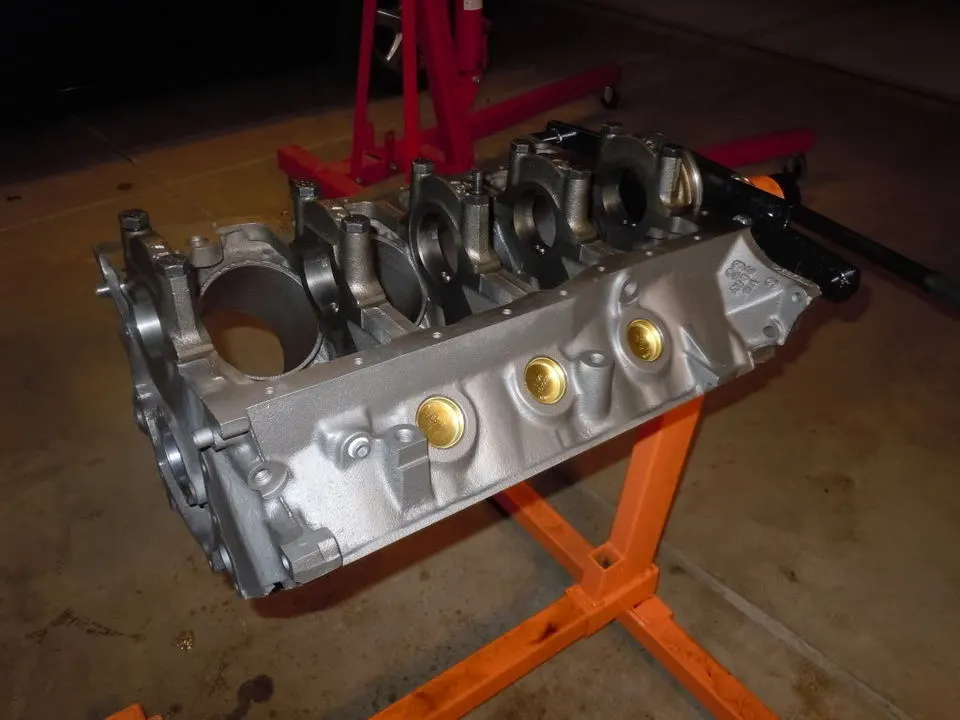

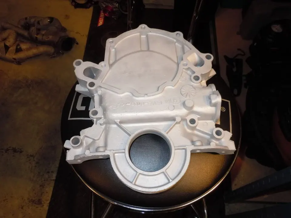

  11. I actually do have another round of pics for you guys; the parts are back from the machine shop and the rebuild parts are in from Summit.
    Here ya go:
    And, I managed to get the freeze plugs IN last night. :D

  16. what kind of casters you got on that engine stand?
    ever thought of a bearing upgrade, to make rolling easier
  17. Haha, what? I greased them. Does that count?
