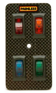

    Oh yeah. We're talking a full fledged mini-ITX machine. The whole computer will be about the size of a small amplifier and it will sit in the trunk.
    I was thinking one of these:
    [IMG]
    in the ashtray. Have a master power switch to keep the machine safe from power spikes during startup, and convert two of the other switch holes to USB ports so I can plug in a keyboard/mouse if need be.

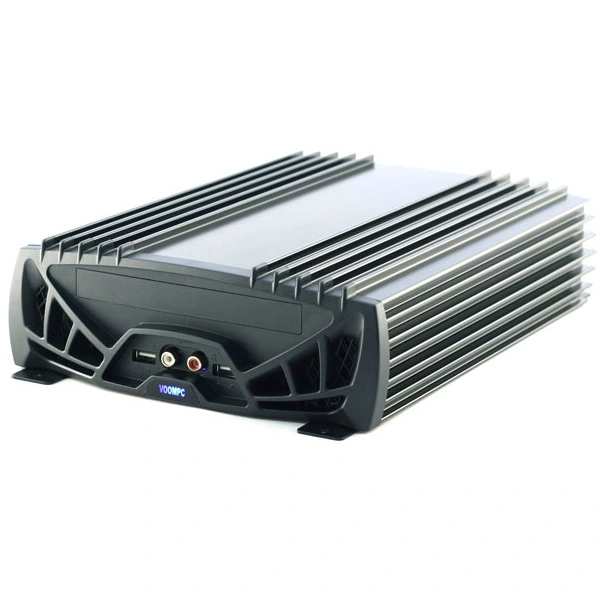

    Okay, so I ordered this today:
    [IMG]
    Its roughly 8x10x2.5. Thats how small the base station is for this machine. This will be mounted in the trunk. The idea is that the whole thing will be solid state. Meaning that there will be no moving parts. This means using a flash based HDD like this:
