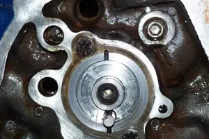

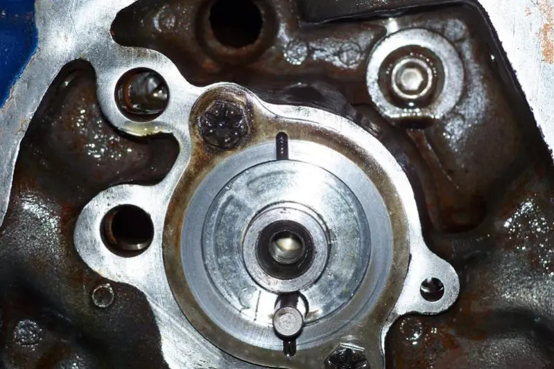

Ok, I took you're guy's advice and turned the cam at the same time I turned the oil pump and still no oil through the rocker arms. I then checked for the oil plugs at the back of the block. There were 3 screw-in plugs. I pulled each out one at a time and bumped the oil pump with the drill and there's definitely oil coming up through each hole. So I then pulled off the timing cover and found something odd. You guys mentioned there were also 3 oil plugs in the front also, but I only found one. It was a screw in plug, but the other two holes didn't have a plug in them. My confusion is that neither one of these two hole were threaded. Are they supposed to be threaded or are they press in like the freeze plugs are? I took pictures of it so you guys could help me figure this out. Now I need to figure out how to upload them on here....

Ok so if those other two holes are press in caps, then I'll run down to the auto parts store and get a couple and press them in. Once I get them in and the timing cover back on, I'll let you know what happens. I guess this was a blessing in disguise. Thank all of you for all your advise.
