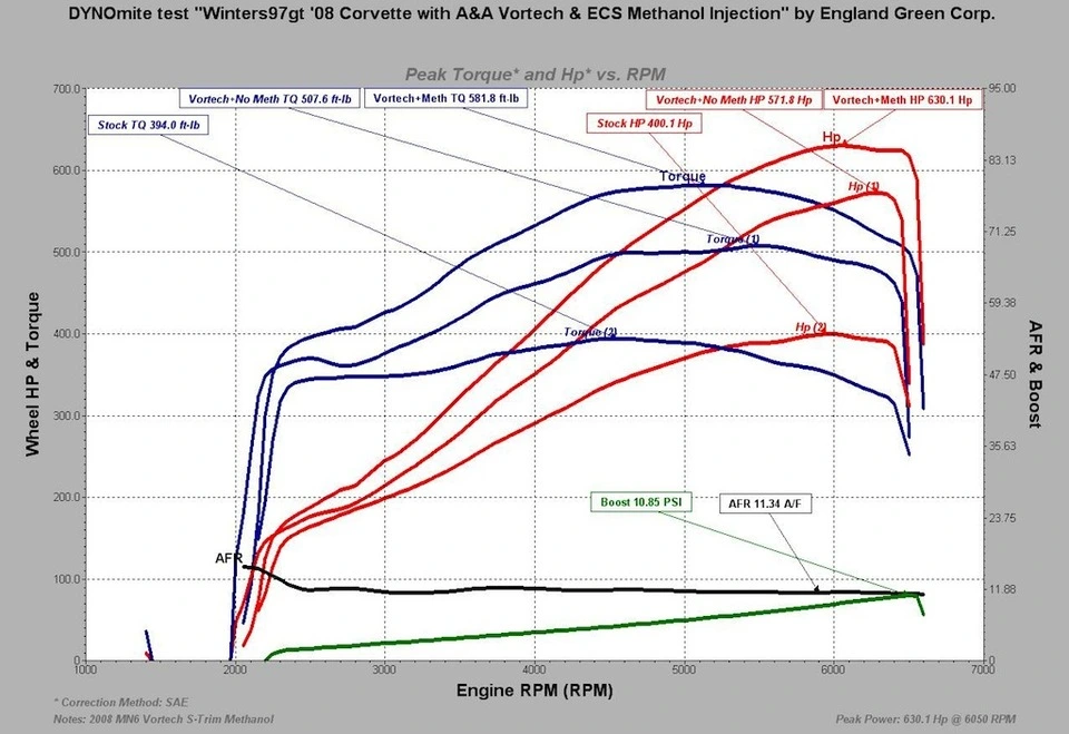

    I use Julio's Alky Conrol kit. He is a mustang guy, but nobody in vette world now puts blowers on their cars without a kit. My backup tuner and good buddy, owns Auto Adrenaline Performance here in Houston. They work on 90% Fords, and that is all he uses too. The Snow Performance kit is good, and if your tuner uses that, then go with it. If he doesn't care, go with the Alky kit, it's better.
    You will have no detonation with meth. It's basically like having race gas under boost. Depending on how much you spray, it will raise your octane a ton. I spray 2 M15 nozzles(a lot, even when I was at low boost). Your tuner will tune your car on 93 to a safe level. Then add the meth after the tune to get the cooling and octane benefits. You can use it as a power adder, or for safety. If you tune it for safety, you will pick up 30-40hp, and if it fails(which I have yet to see), then your tune will pull timing and keep your motor safe.
    Here is what meth did on my stock LS3 at 10psi. No headers, cam, nothing changed. Bone stock car. Before and after meth with an SI trim(1150cfm blower). This tune is a little more aggresive though. But you can get the idea. Look at the torque difference.
    Mark%20Weathers%20C6%20Vortech%20Methanol%20FINAL2.jpg very smart move to go with Procharger if your tuner is a distributer for them.

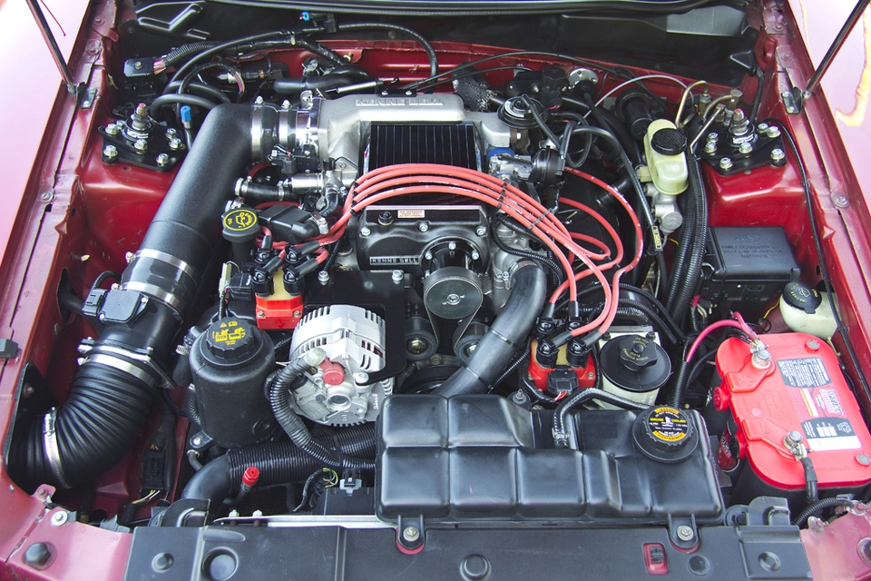

    I was in the same position as you..... I wanted a supercharger and it was gonna be either the Kenne Bell 2.1 Innercooled kit or the Procharger P1SC with front mount innercooler.
    It took me almost 9 months to decide. I had the cash, just was being picky.
    When it comes down to the cost, they are pretty much both the same price from the 3 core innercooled procharger and the innercooled Kenne Bell.
    I ended up picking the Kenne Bell 2.1 for a few reasons.... I will say why...
    Reason I DIDNT get the procharger.
    -I didnt wanna deal with removing the front bumper and cutting stuff to make the FMIC fit. You can to trim stuff, I didnt wanna do that.
    -You gotta pull the entire supercharger off to replace the belt..... and thats a Pain in the Ass.
    - Still gotta buy fuel parts
    -To get the same power as the kenne bell, i would have had to run a Power-Pipe and an aftermarket plenum.
    Reasons I Picked the Kenne Bell 2.1 Intercooled
    - Kenne Bell is 40 mins from my house so I didnt have to pay shipping
    - I got kenne bell to knock off $500 cause I said I was in the military.
    - Kenne bell IMO is a cleaner Install
    - Kenne bell came with EVERYTHING (I added an aviator Fuel pump cause i didnt trust the stock pump.
    -Kenne Bell didnt charge me for the Big Air Upgrade and they gave me the AccuFab 75mm T/B and LMAF for free *Thanks so much!!*
    I was gonna get the Tork Tech kit, but there is so much BS'ing around to get the Tork Tech kit running, plus it doesnt clear the stock hood so after you buy the tork tech kit, the blower, fuel system, and buy a new hood and get it painted, its more than the Kenne Bell. The best thing about the Kenne Bell is that is clears the stock hood.
    In My opinion, the Kenne Bell was WELL worth it. It looks OEM. The fitment is DEAD ON. The Kenne Bell uses a Bypass Valve so you only boost when you press the gas pedal more because its runs off vacuum. I can drive around all day not boosting anything. when i wanna boost, I press the gas and the power is there. Instantly.
    Twin screw IMO blows Centri blowers out of the water. The smooth power delivery and the boost is always there when i want it. Don't believe all this B/S about "Twin Screw and Roots blower Heat soak and get hot". Thats a load of BS from people that dont know what they are talking about. I drove my car all years round and have no problem with heat soak. Car always boost 10-11PSI on a 9PSI pulley. I drive my car is 100 degree temps with A/C pumping and always get full power. Its amazing.
    Just for the record, I dyno'd 407rwhp/420rwtq.
