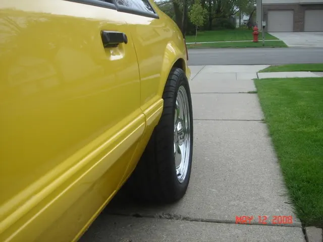

Progress thread, new wheels
looks good
Im pretty sure it comes with longer axels to accomidate the rear caliper bracket, should be about 1/4" wider total.
I would just keep it the way it is , :nice:
its not a ssimple as just smacking new axles in it. you would have to find stock length axles, rangers or mosers ect. then find the brackets, NRC has a stangle hold on the market since they scared the guy off corral from making them. i dont think anyone makes a bracket to make the gt brakes work on stock length. so you would need at minumum the cobra rotors, to grind down your gt pads, or get cobra pads, and the nrc brackets, as well as the axles which means busting the diff open again.
I didn't even think about having to replace those stinking brackets... Thanks for bringing that up. I'll just go to a slightly narrower tire if it really starts to annoy me! Sounds like that will be cheaper and easier in the long run.

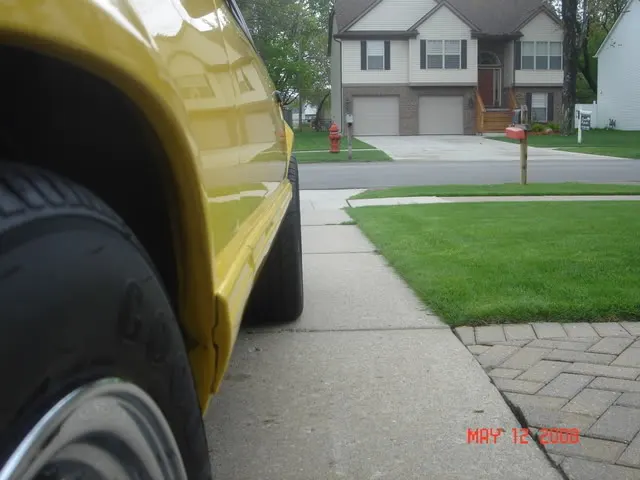

I think it looks good man. I wouldn't change a thing. I used the 2001 axle in Hack Job, and that is 1-1/2" longer per side. I bought 17X9's with a +45mm offset and I'm running a 285 and they do not stick out, but are right to the edge.
I'm not stealing the thread, so nobody comment on Hack Job in his thread, because God knows I have plenty of my own....:D

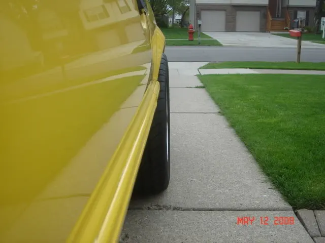

Here is mine....and I have not had the tires hit the quarters.
thats looks really good, I wish with the offset of the 03 cobras, I had gone with the longer axles, the ranger axles are a tight wit with these large offset 17x9's
In all honesty the amount they stick out is to far for my taste, not by much though. It would prob bother me enough to do the axle swap,
That's what I am afraid of. I'm just going to finish the project, get the car on the ground and see how much it grates on me. If at all....
I am pretty happy with the wheel too. They were my plan b, but I like them more than my original choice.
