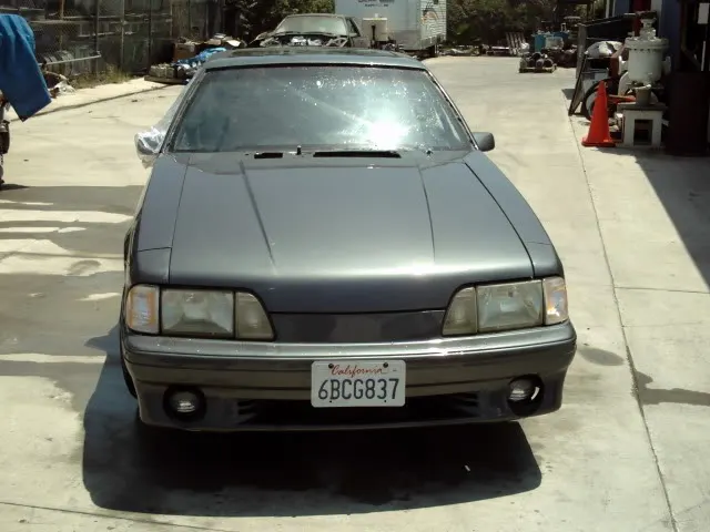

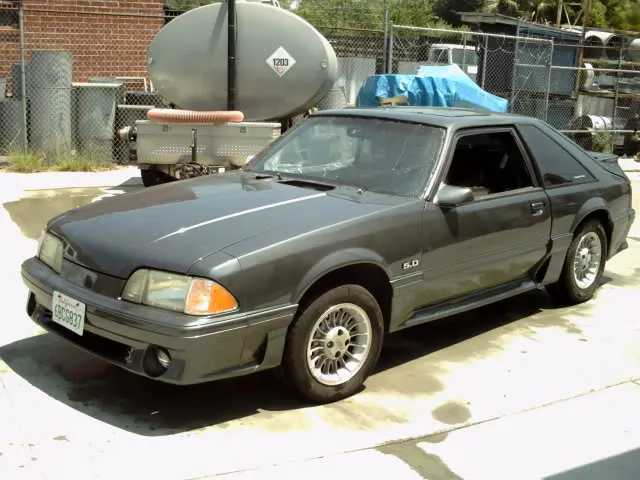

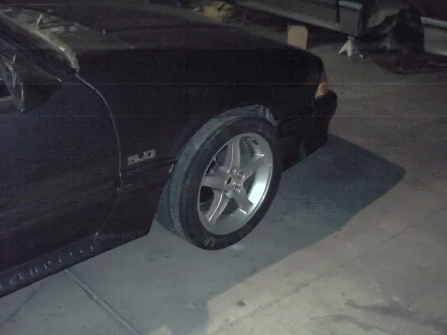

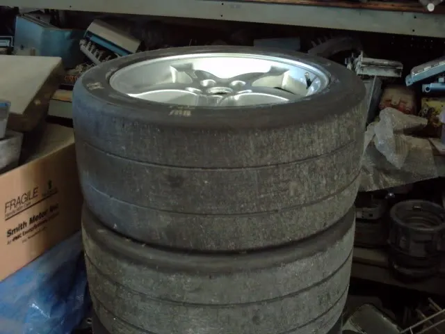

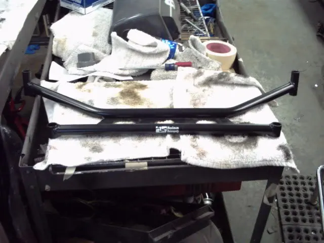

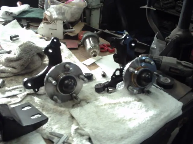

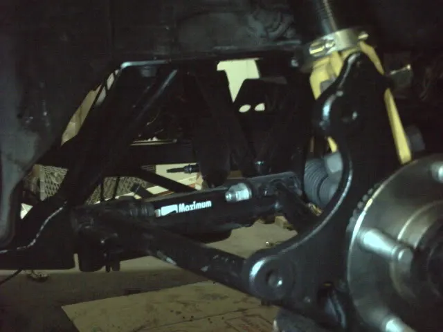

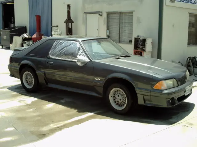

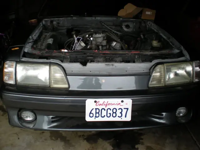

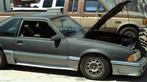

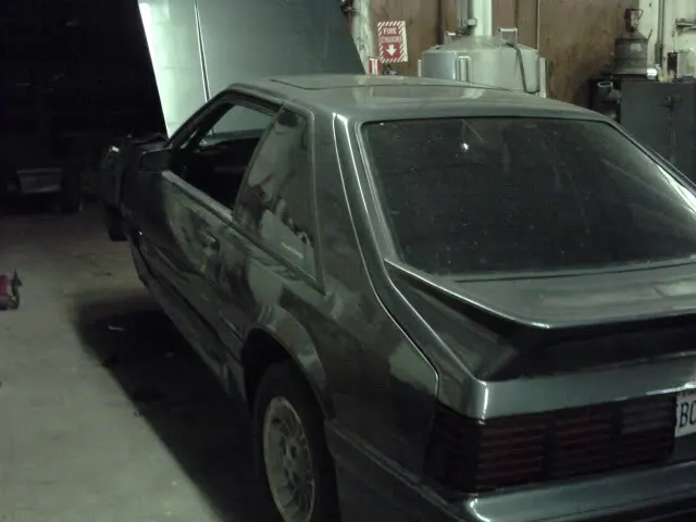

    Well everyone seems to be posting up their build threads and i figured id do the same, first heres the pics of the car
    Day i got it,
    [IMG]
    [IMG]

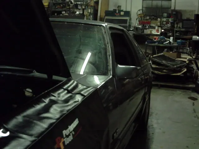

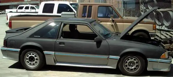

    After original installation of a few parts, maybe 20 miles after last pics
    [IMG]

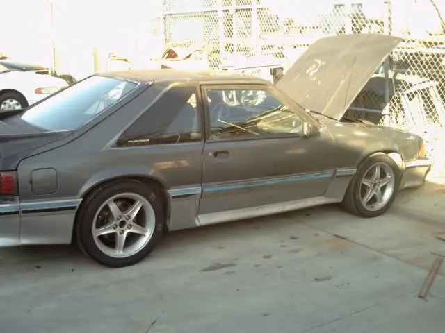

    Now this is the teaser before i install all of the parts i have
    [IMG]

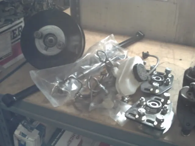

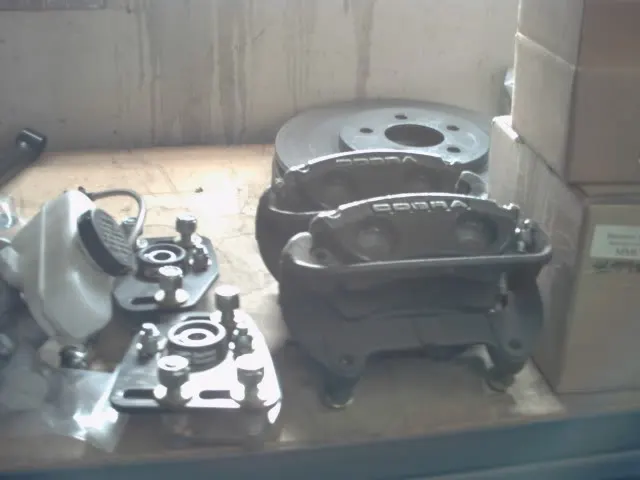

    Now for the parts i have
    MM K-member (with 2-point brace)
    MM Front Control Arms
    MM Torque-arm (heavy duty)
    MM Panhard Bar
    MM XL Series Full-length Subframe Connectors
    MM Coil-over Conversion Kits, Front and Rear
    Coil-over springs (500/250)
    MM Caster/Camber Plates
    MM Aluminum Rear Lower Control Arms (extreme duty)
    Bilstein HD series struts (MM3 race valving)
    Bilstein HD series shocks (MM2 Race valving)
    MM Aluminum Steering rack Bushings
    MM Solid Steering Shaft
    MM Bumpsteer Kit (adjustable outer tie-rod ends)
    MM Strut Tower Brace
    MM Front Swaybar Relocation Kit
    Front Swaybar Bushings
    Front Swaybar End Links
    98 Front Spindles
    Cobra Brake Booster
    Cobra Master cylinder
    Wilwood porportioning valve
    Cobra Rear Axle-torsen ford lsd-3.73's
    All Stainless braided brake lines
    Cobra Brakes front and rear
    Cobra R 17x9's
    Hoosier road racing DOT's 275/40zr17
    Race Harness Seats
    Autopower Roll cage
    Dart Iron Eagle Block
    Probe Dominator 347 with i-beam upgrades
    Forged gear drive
    mechanical cam setup
    billet steel flywheel
    Pics to come in a few weeks when i install everything, let me know what you guys think.

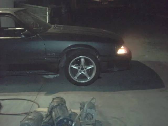

    Is there anything wrong with the front suspension, the front tire looks way closer than normal:shrug: Nice list of upgrades though:nice:
  3. Shaolin Crane Banned
    Member Since:
    Oct 6, 2008
    Message Count:
    5,610
    Likes Received:
    Trophy Points:
    Location:
    Kommiefornia
    if you are refering to the first pic EVERYTHING was wrong with all of the suspension, part of the reason im replacing everything (only a small part)

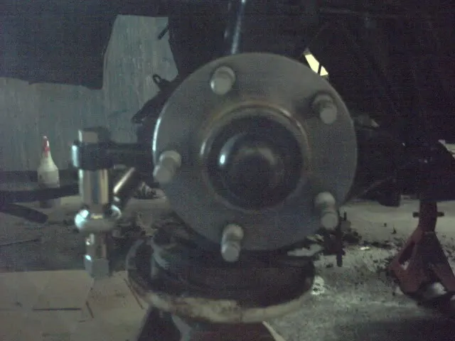

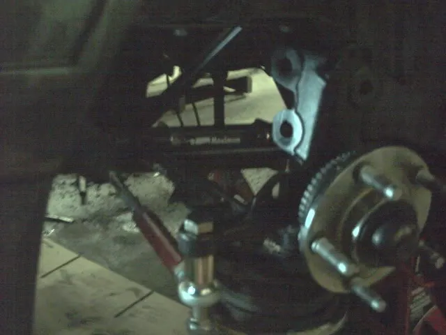

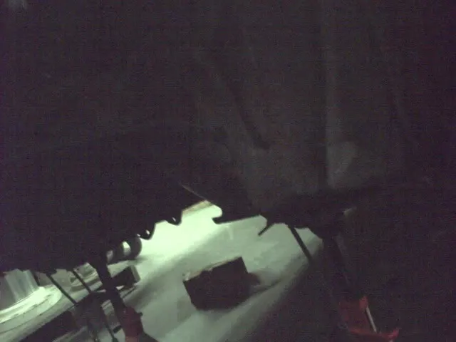

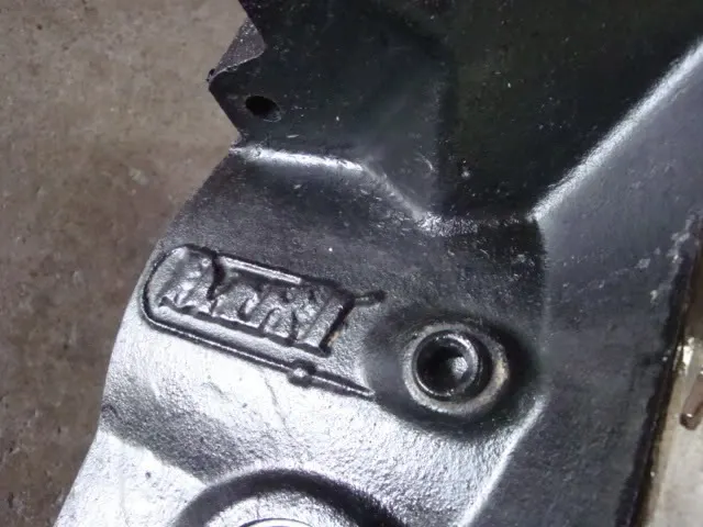

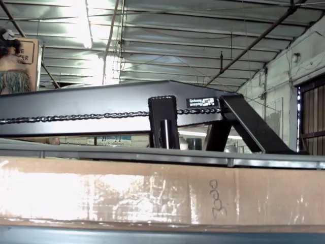

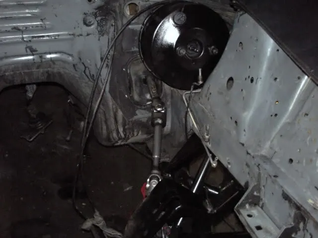

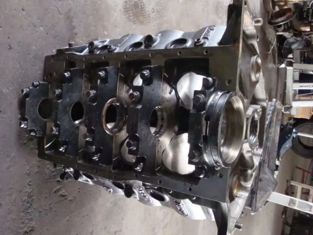

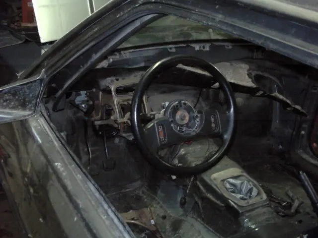

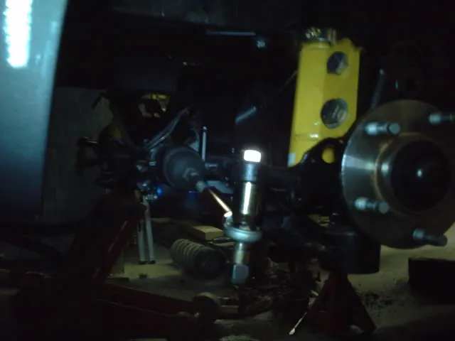

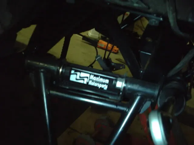

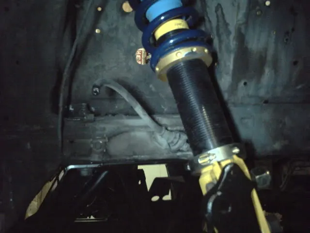

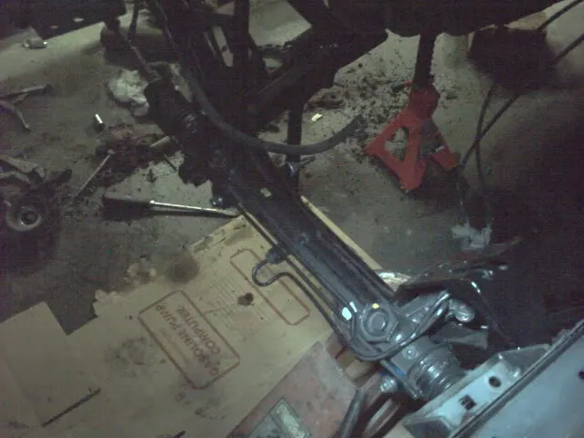

    todays progress

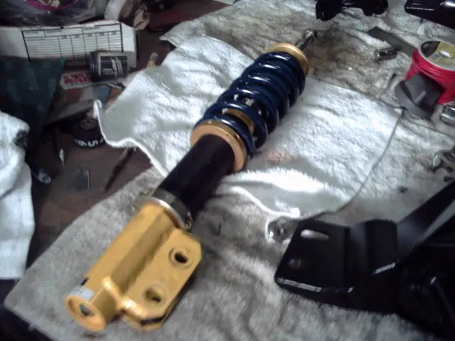

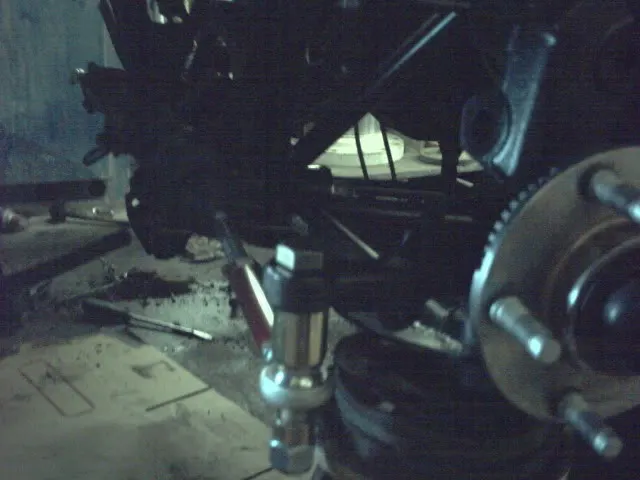

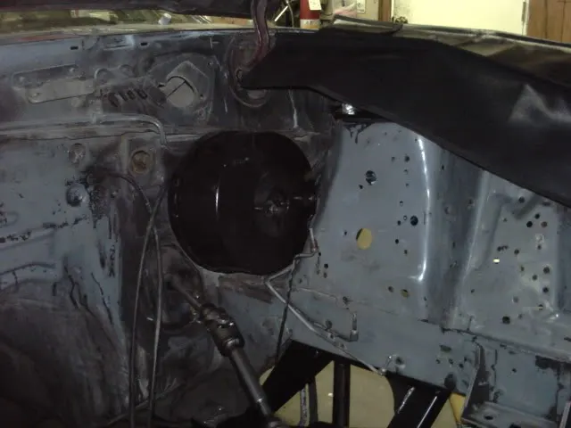

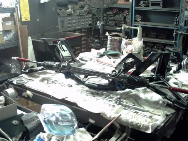

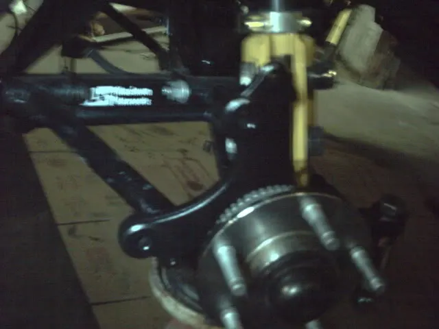

    [IMG]
    [IMG]
    [IMG]
    [IMG]
    [IMG]
    [IMG]
    [IMG]
    [IMG]
    [IMG]
    [IMG]
    [IMG]
    [IMG]
    [IMG]
    [IMG]
    [IMG]
    [IMG]
    [IMG]
    [IMG]
    [IMG]
    [IMG]
    [IMG]
    [IMG]
    [IMG]
    [IMG]
    [IMG]
    [IMG]
    [IMG]

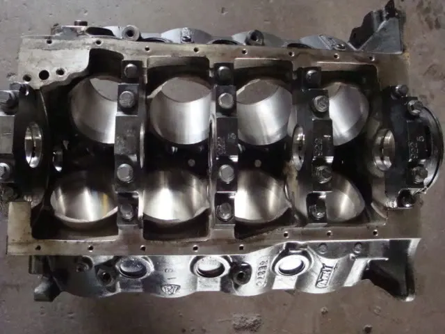

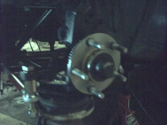

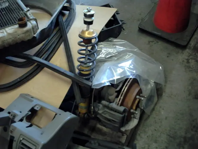

    Didnt quite get all the pics from yesterday/today
    [IMG]
    [IMG]
    Also in the works
    [IMG]
    [IMG]
    [IMG]
    [IMG]

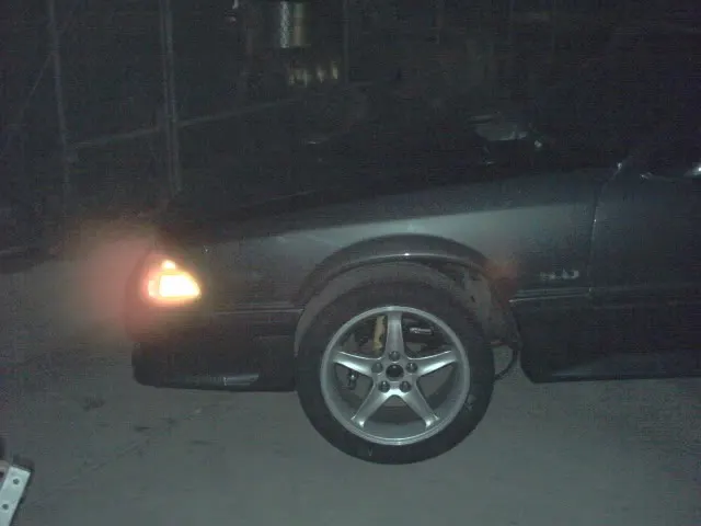

    Gonna be real nice man, just not diggin the wheels being forward with that MM K member.
  18. Shaolin Crane Banned
    Member Since:
    Oct 6, 2008
    Message Count:
    5,610
    Likes Received:
    Trophy Points:
    Location:
    Kommiefornia
    your telling me, my OCD kicks in crazy when i look at it, but new forward offset flared fenders are on the way to keep it "stock" :lol:
  19. youngkow New Member
    Member Since:
    Sep 16, 2007
    Message Count:
    Likes Received:
    Trophy Points:
    Why do they push the front wheels foward so much? Is that how they're designed?
    Looks great BTW!
  20. Shaolin Crane Banned
    Member Since:
    Oct 6, 2008
    Message Count:
    5,610
    Likes Received:
    Trophy Points:
    Location:
    Kommiefornia
    yeah the forward offset control arms and k member pushed the forward about 2" for a wider wheel base and positive castor
