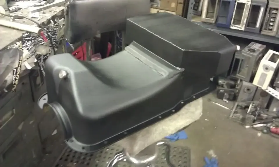

Canton road race pan, pickup, and dipstick $325

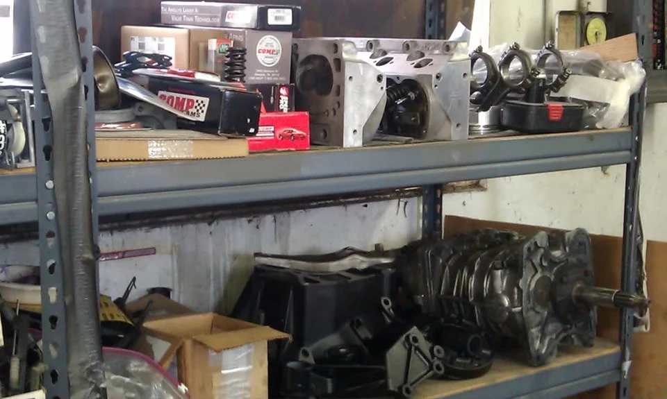

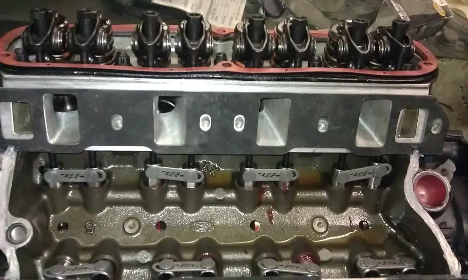

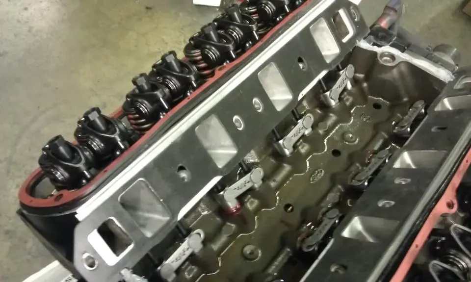

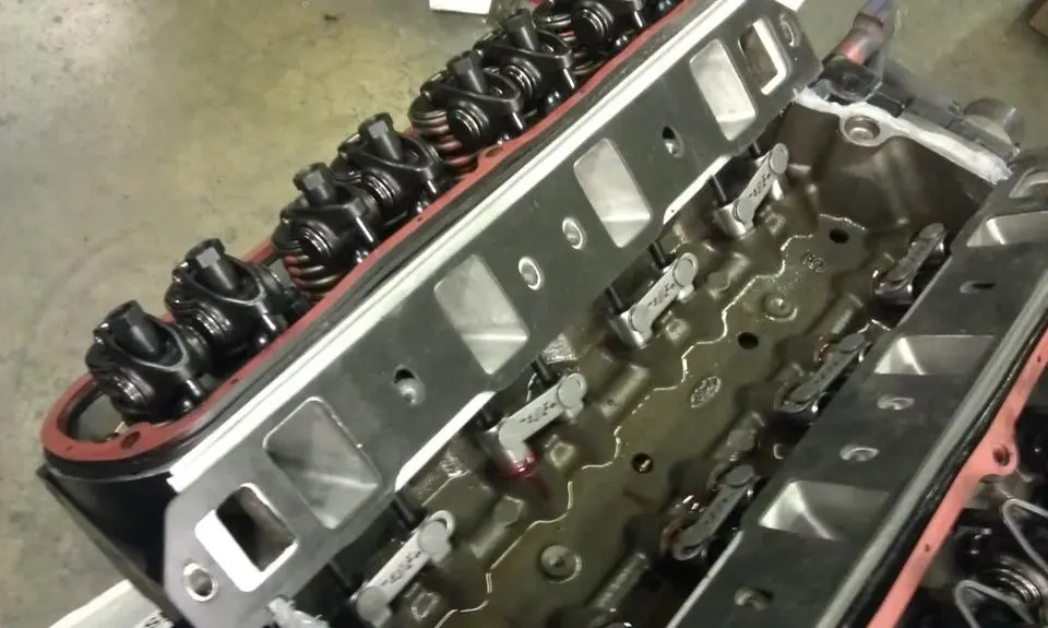

Here is a picture of my parts shelves before assembly
attachment.php
attachment.php
attachment.php
attachment.php

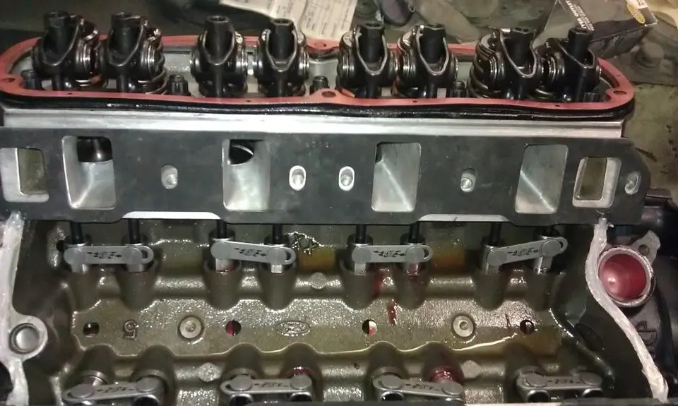

Here are the engine brackets done is a flat/satin black(first pics shows gloss black however)

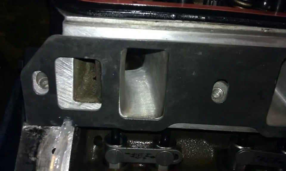

1262R gaskets...
Pics are out of order but whatever, be glad i actually updated this thread ;)

Nate- I HATE chrome, polished, really anything shiney, so I did all the powdercoating myself cause im cheap and poor. Its a really different black wrinkle finish, actually and imperfect cracked look instead of a regular texture kind of finish

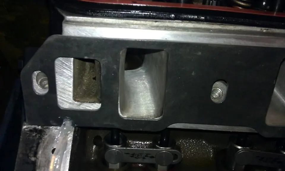

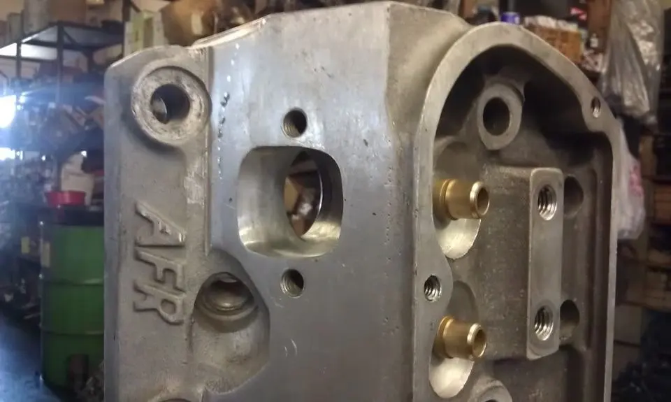

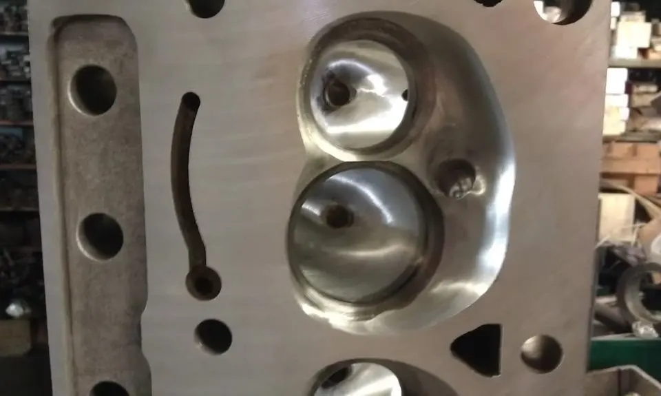

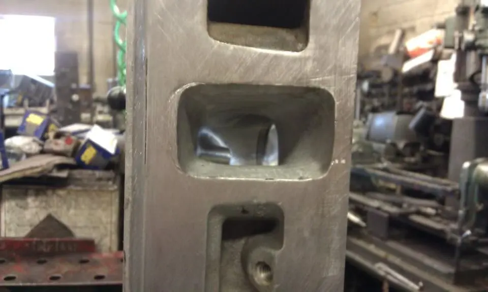

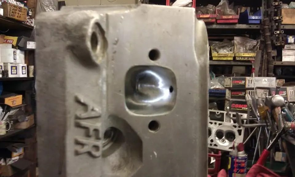

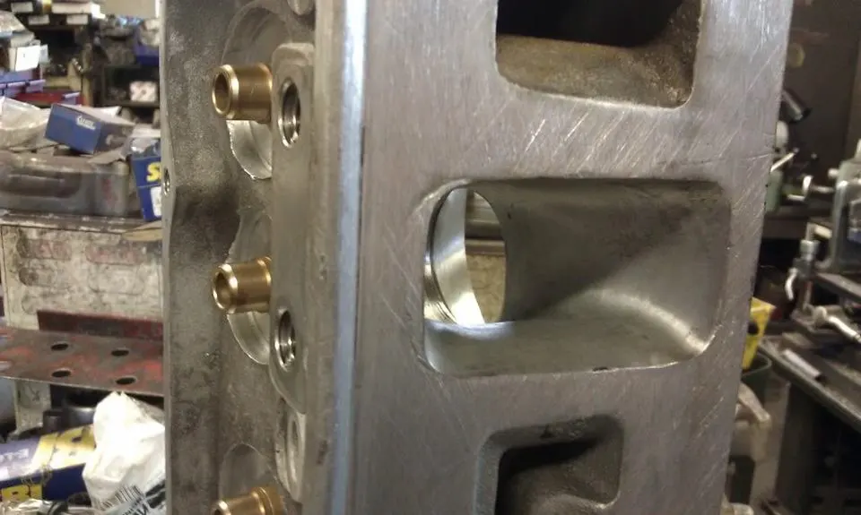

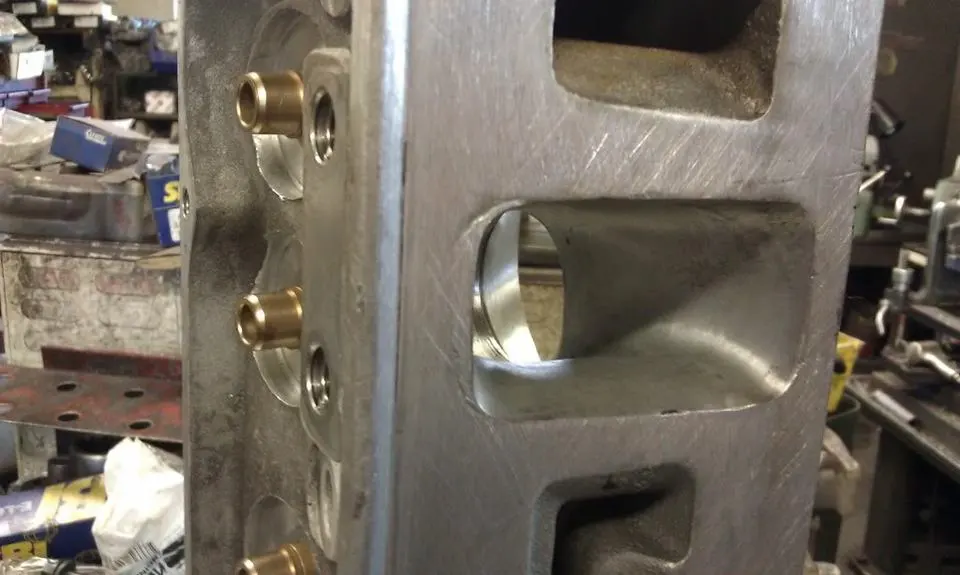

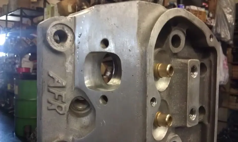

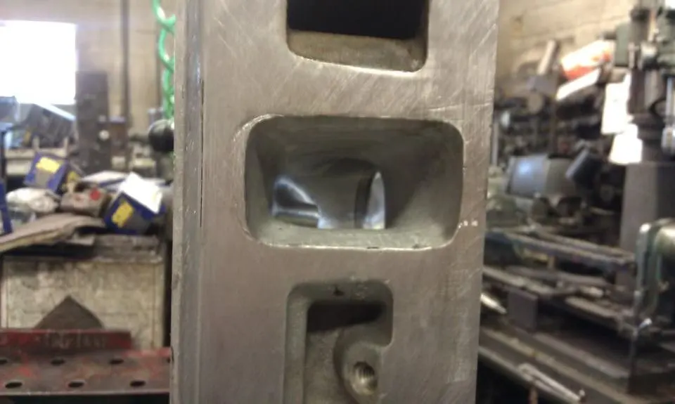

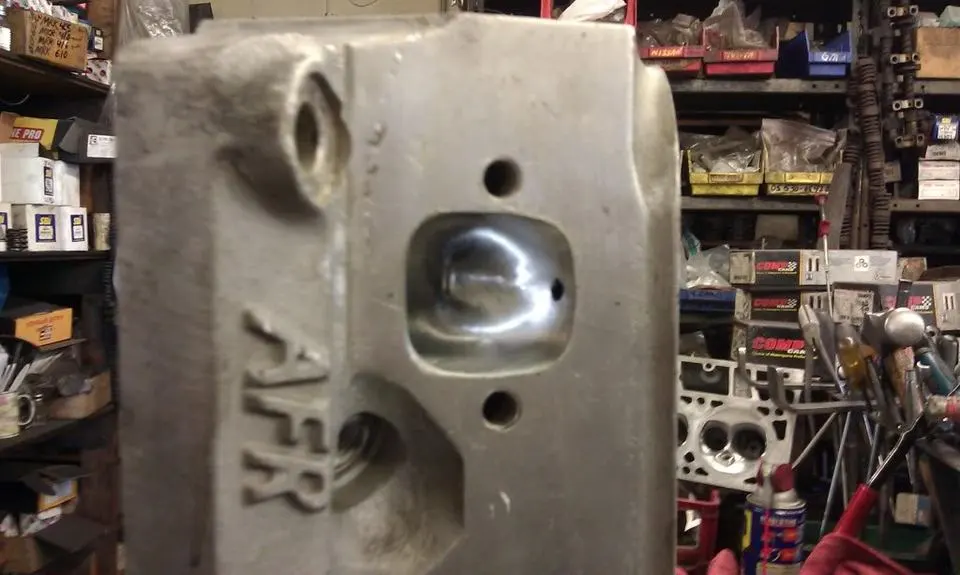

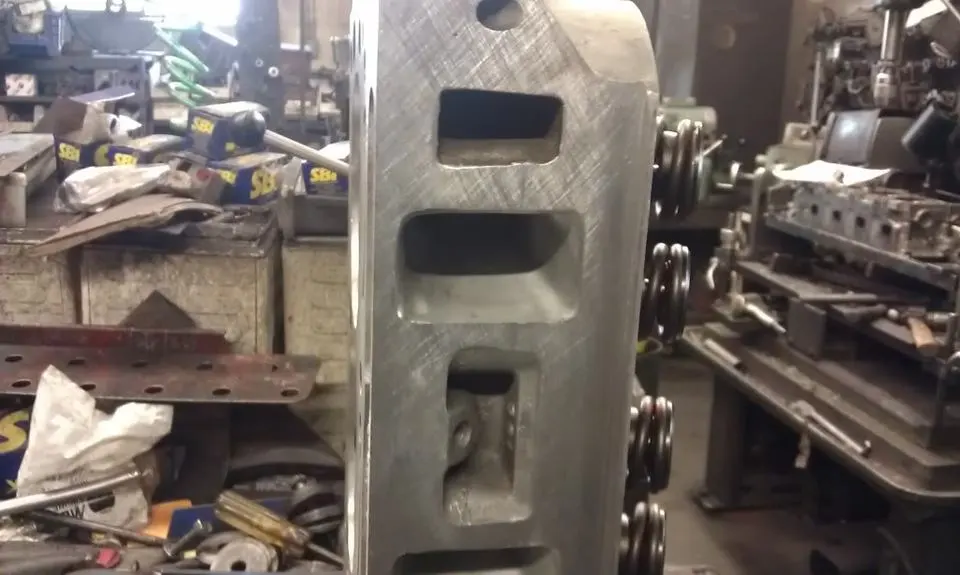

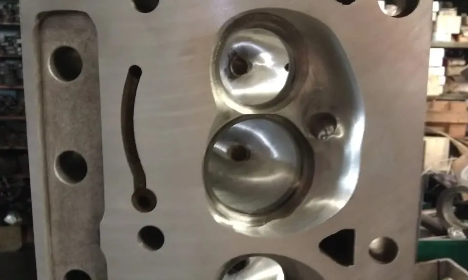

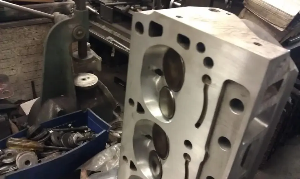

These were requested, these heads had to be extensivly saved, dont buy heads unless you have them in your hands to look over. These are the monster 1262R gaskets, 200cc according to my builder now, im just glad he saved them.
Fantastic job for $300
