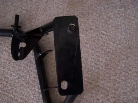

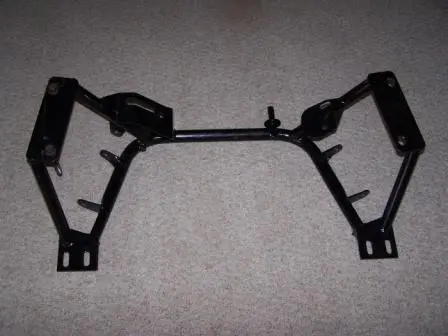

Because the motor is not in the car, loosening the bolts on the K member was not very time consuming. Unfortunately that did not help. There is no left to right adjustment, only front to back. The K bolted up great except for it shifted the tires, not by a litle, but ALOT! I since have taken it all apart for the third time, and am going to send it back for a quality control inspection. I also purchased a PA Racing unit that will arrive later this week. I have been doing some research on some other forums and have found some people with the same problem, just not as bad. At this point if I were to drive the car and hit a pothole my fender would be toast!!! I will post a pic of the K to show there is no right to left adjustment.
