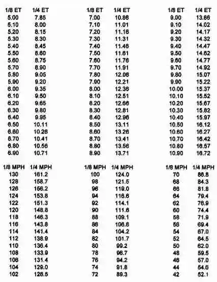

This chart will give you an idea on 1/8 to 1/4 mile.
Many factors so it's not 100 %.
