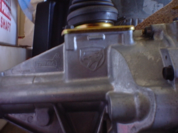

    My T56 is out of a 2006 Viper. A "Viper Spec" is a non Viper T56 built up to Viper Specifications. A Viper T56 has a longer input shaft than a Cobra T56, so you will need some custom work done to bolt the Viper T56 up using a Cobra bell. A Viper T56 will have a Viper emblem cast into the shifter boss on the case.
