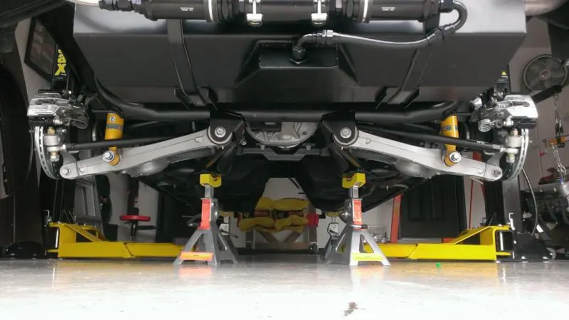

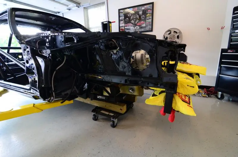

    Grabbed these today with my cell. Better with some daylight on everything. Notice the 160lbs of softener salt on the front end :)
    [​IMG]
    [​IMG]

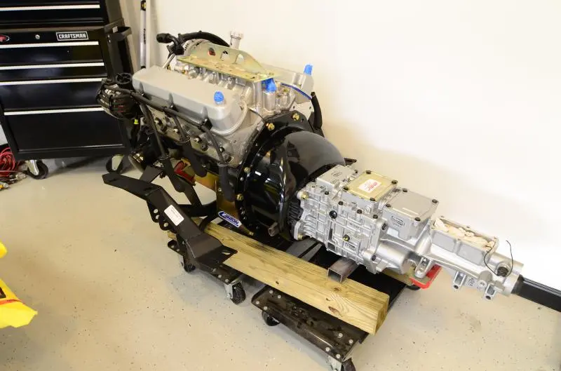

    Finished up mating the transmission to the engine tonight. Bellhousing indexed within specs. I had a hell of a time getting the transmission to seat properly. Apparently, despite using the clutch alignment tool, the clutch was off enough to not let the trans go in all the way. I had to use a threaded rod and two nuts to pull the shift fork in to release the clutch. As soon as I did that, everything slid into place.
    [​IMG]
    I'm planning on sliding this under the car and bolting it in on Friday. If all goes well, I can start putting all the turbo piping on this weekend.

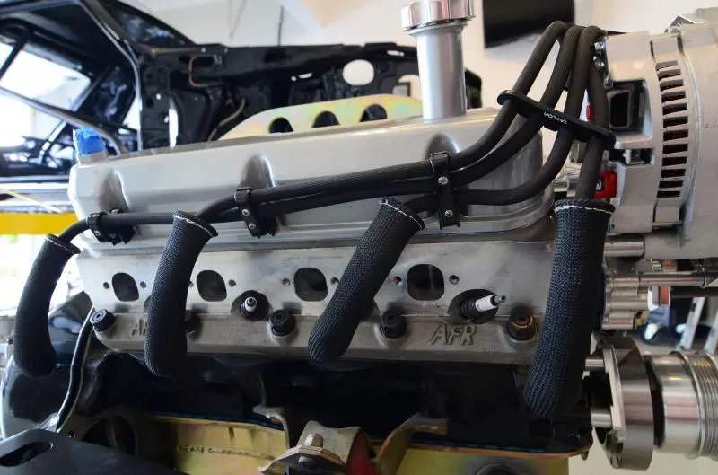

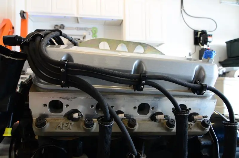

    Scott could you do me a favor and oost some pics how yoy routed your spark plug wires i wanna clean mine up and your orientation looks good
  15. RacEoHolic330
    RacEoHolic330 I like to dress like a pretty girl SN Certified Technician
    Joined:
    Mar 5, 2003
    Messages:
    3,343
    Likes Received:
    484
    Trophy Points:
    123
    Location:
    Allentown, PA

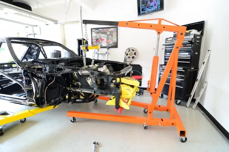

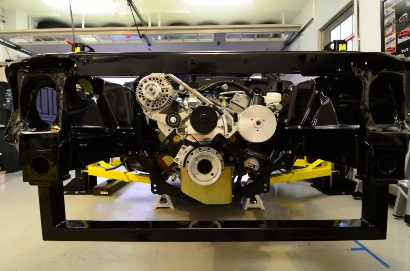

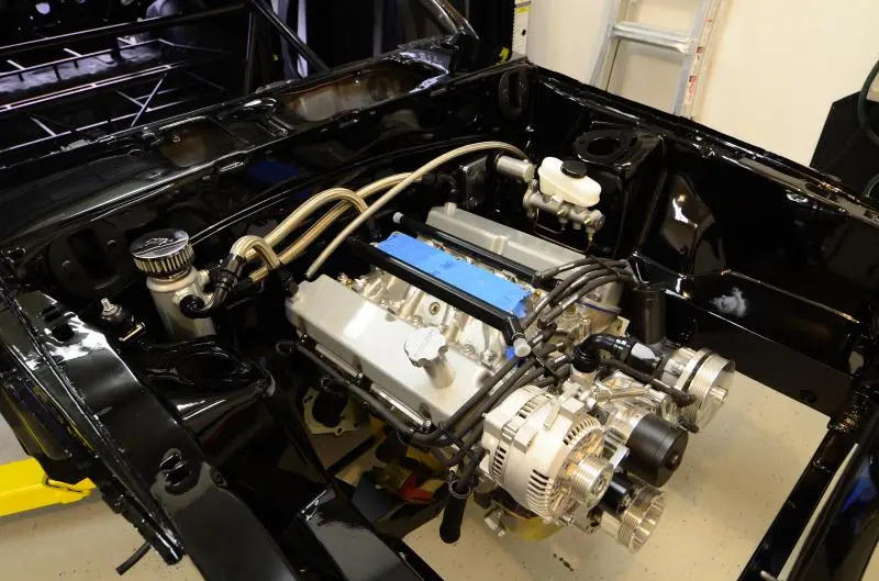

    Sure Mike. Here you go. I think the wire separators are made by Taylor. I'd have to confirm that though. It was tough finding ones for 10.4mm wire.
    [​IMG]
    [​IMG]

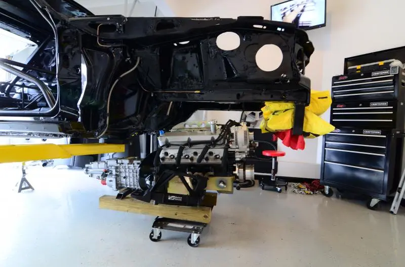

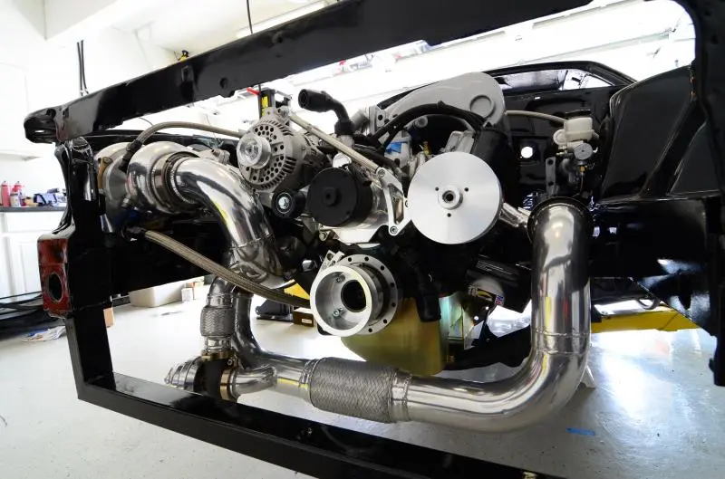

    I did manage to get the engine and trans installed without any real issues. The lift made easy work of everything.
    [​IMG]
    [​IMG]
    [​IMG]
    [​IMG]

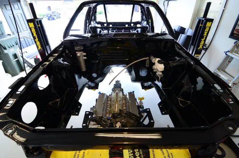

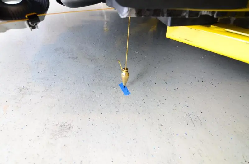

    Once the k-member was just about touching the frame rail, I hand tightened all the bolts and then used the cherry picker to lift the engine off the k-member.
    [​IMG]
    Then I had to align the k-member with the car. It wasn't terrible to do, but did take some time because I was checking all the measurements by myself. I got the k-member within 1/16 of square, so I was good to go!
    [​IMG]

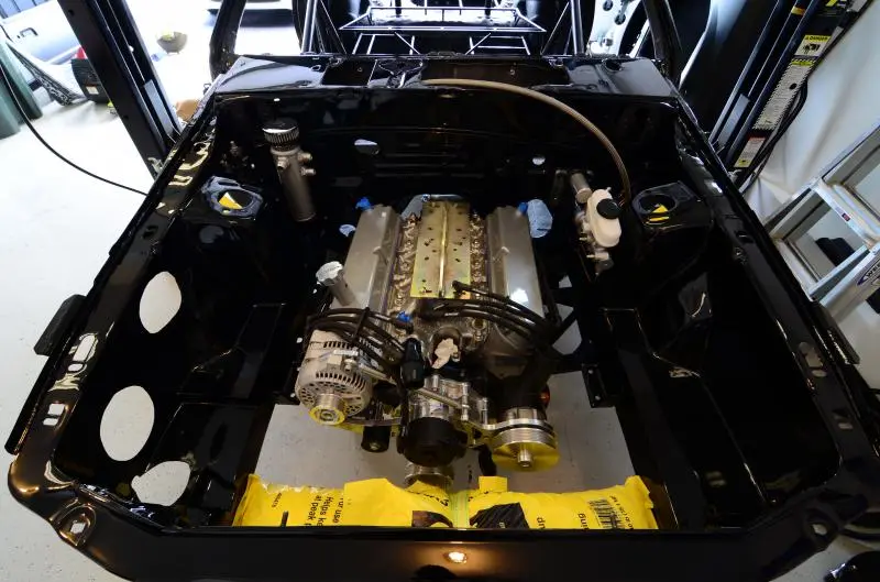

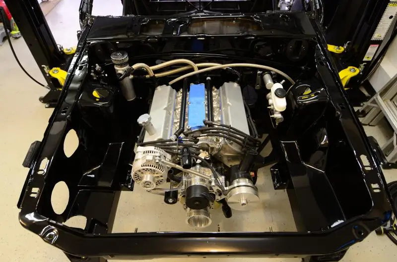

    After that was all done, I dropped the engine back into the k-member and she is now in her final resting place.
    [​IMG]
    [​IMG]
    [​IMG]
    I mocked up the fuel rails and the breather lines so I can begin to figure out how I want to run my fuel lines. It's going to be tight, that's for sure. I need to replace the middle breather line fitting with a 90 degree one. That will free up some room for the heater hoses. The goal is to keep the fuel lines as inconspicuous as possible. We'll see how that goes!
    88LX5.Oh and 91chp notch like this.

    BS. That spec was probably just dust on the camera lens ;).

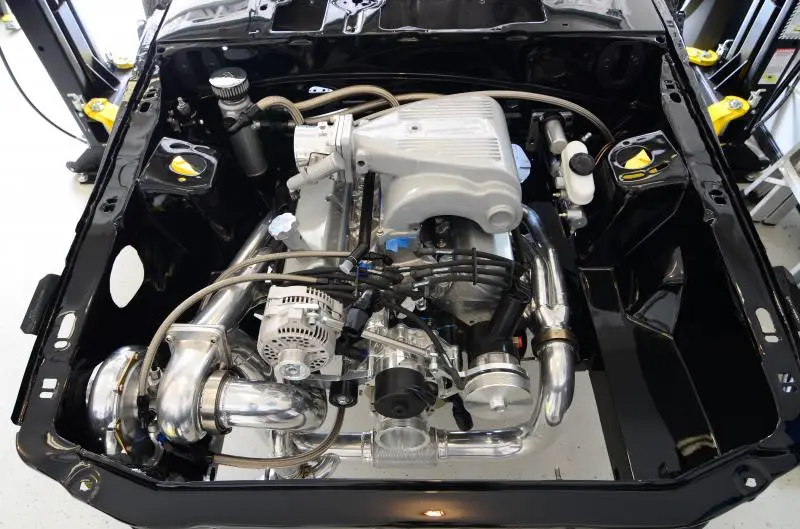

    My IRS took a TON of time to clean up, get blasted, clean some more, prep, paint, etc. Definitely not easy stuff. I was lucky that I bought it with the entire Full Tilt bushing kit installed. That is a real bear to do.

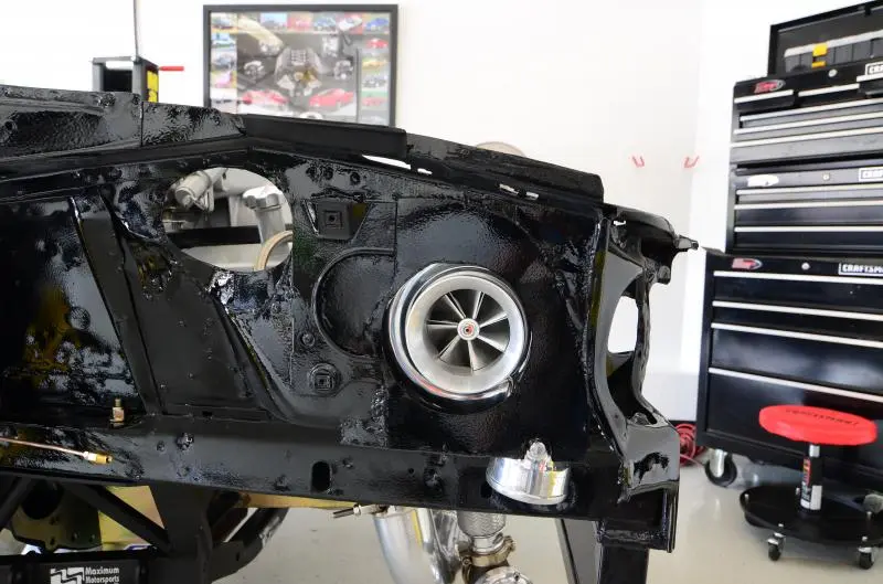

    It's great how compact the pushrod engines are. Makes it easy to stuff all this shiny turbo piping in the engine bay...
    [​IMG]
    [​IMG]
    [​IMG]
    A5literMan, 88LX5.Oh and 91chp notch like this.

    Hows that alternator gonna hold being next to that pipe
