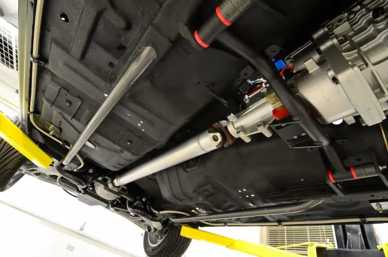

    Quite the opposite Mike, unfortunately. Today was the first day in about two weeks that I had a chance to touch the car. Didn't really get a whole lot done either.

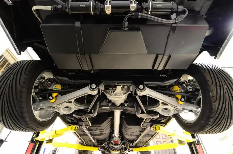

    I cleaned up the driveshaft and got that installed. It's a tight fit with the IRS having a slightly more forward mounting position than the fixed axle. The yoke is right up against the tailshaft seal, but it should be okay. I still have to measure the pinion angle.
    [​IMG]
    [​IMG]

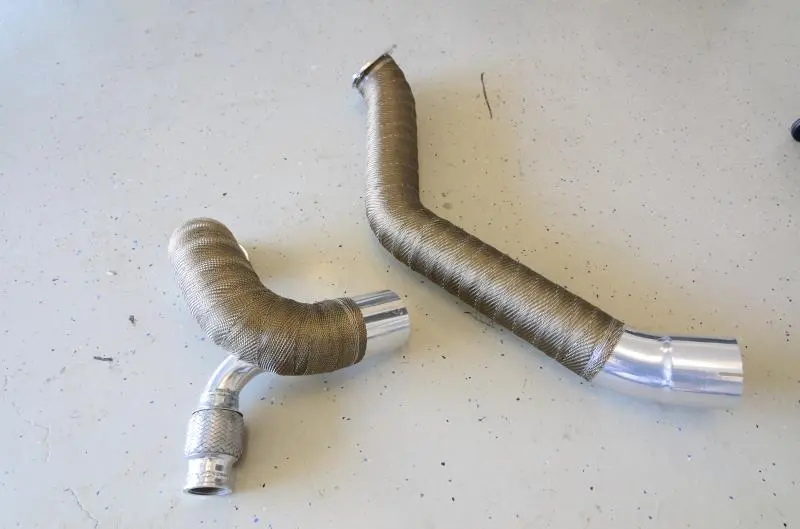

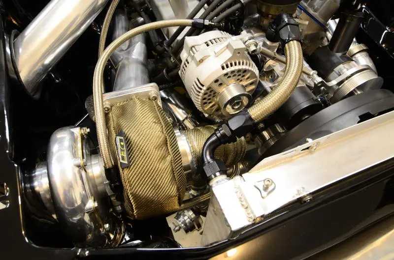

    I also decided to go ahead and wrap the downpipe. It gets pretty close to a lot of things, so I'll feel better knowing it's wrapped. I'll eventually wind up wrapping the rest of the hotside as well sometime down the road.
    [​IMG]
    [​IMG]
    [​IMG]
    [​IMG]

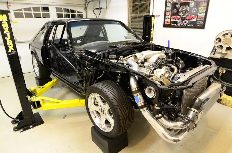

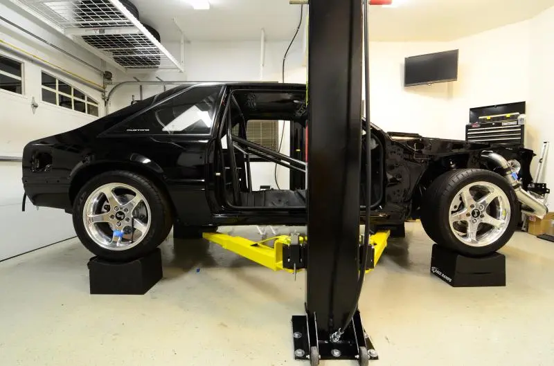

    The car is also on all four wheels for the first time in three years. The race ramps are really cool. They'll make it a lot easier to setup the suspension.
    [​IMG]
    [​IMG]
    The only issue I noticed is that for the car to be close to proper ride height, the coil overs need to be so loose that when the car is elevated and the suspension in full droop, the coil overs have slack between the springs and the perches. I'm going to have to look into that, because it doesn't seem right to me.

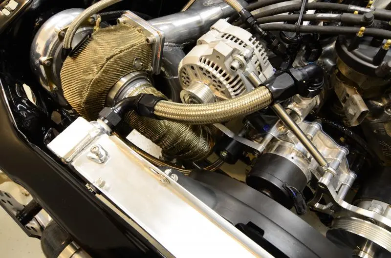

    Finished up the hydroboost lines today. It was a bit of a pain to route the stainless lines. They are not swivel ends, so the fittings had to be exactly where I needed them before I tightened them down. Everything came out okay though. I can bleed the brakes out once I get the pedal box installed in the car.
    [​IMG]
    [​IMG]
    [​IMG]

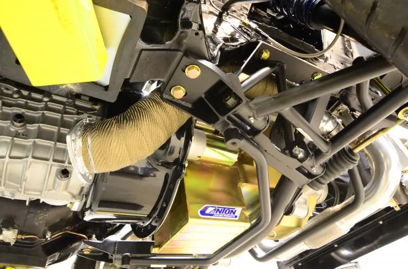

    I also finished up the exhaust. Everything bolted up surprisingly well. The downpipe is really close to the bellhousing and lower k-member mount, REALLY close. I was shaking the exhaust around a bit, and nothing was hitting, so I should be okay. The heat wrap should help as well hopefully.
