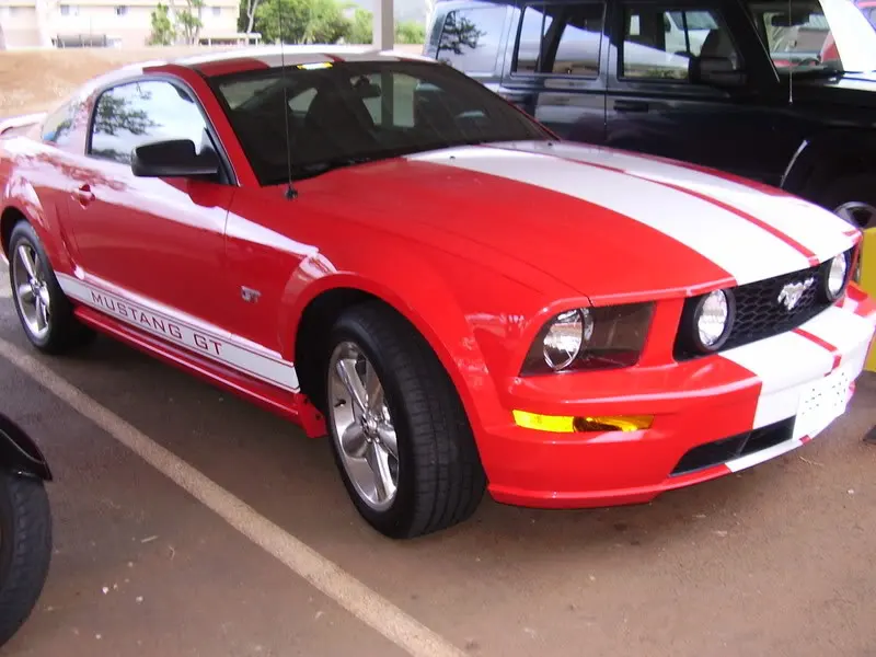

    I spent a good chunk of the day putting white 12 inch stripes, and white "Mustang GT" door stripes on my red Mustang. I used Baltimore Mods 3M stripes. It was laborious, but came out okay. I ended up with occasional ripples, but they aren't noticable from afar.
    Problems: It was really hard to figure out what stripes were for the front, as well as the rear spoiler. I wasn't sure how the appliques actually worked. I had to guess that the top part would be peeled off. Well, it did, revealing vinyl stripes. I used liberal spray and rubbed and squeegeed out the bubbles.
    A hair dryer was indispensable in getting the stripes to dry, go over corners, and work out irregularities.

    Sorry, it's not a great picture, but I had to work late and it was cloudy.
