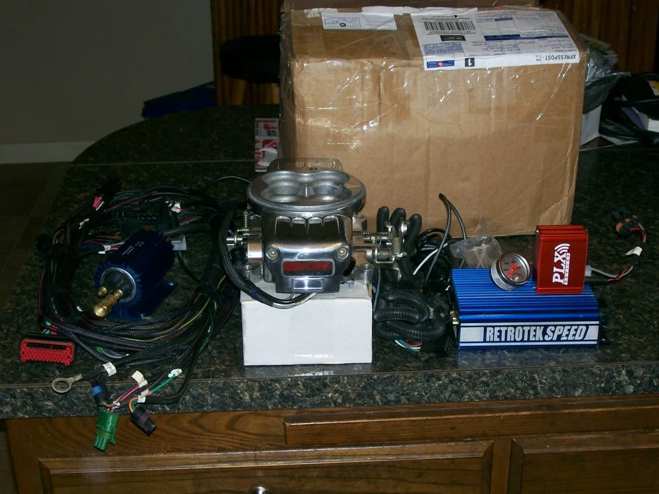

  11. Got mine today.......1300.00
    also found out this computer will run low or high impedence injectors, compatible with the BG VFI. The other cool thing is the guy had it on a 408 similar to mine (he's going stacked injection) in his cobra so the base program is already there. PP told me the 750 actually flows 930 cfm....I will install it after I install my 9" with cobra brakes and frpp dual mode muffs and new tail pipes. I plan to dyno the car with the mighty demon 750, then install a tfi dist and the powerjection and dyno it again and see what gains can be had.

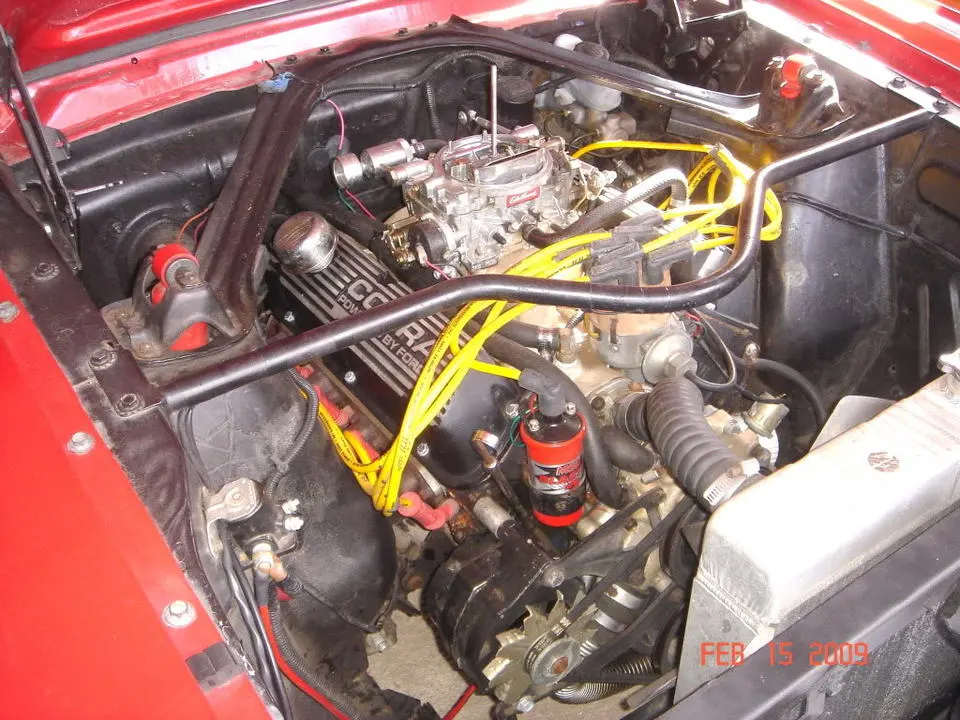

  17. I've got my PowerJection1 system installed and have gotten the new engine started, but have had some bugs to workout.
    I'll post more later. In the mean time here are some before and after pictures:
    Before:
    After:
    Tim

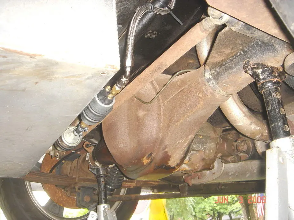

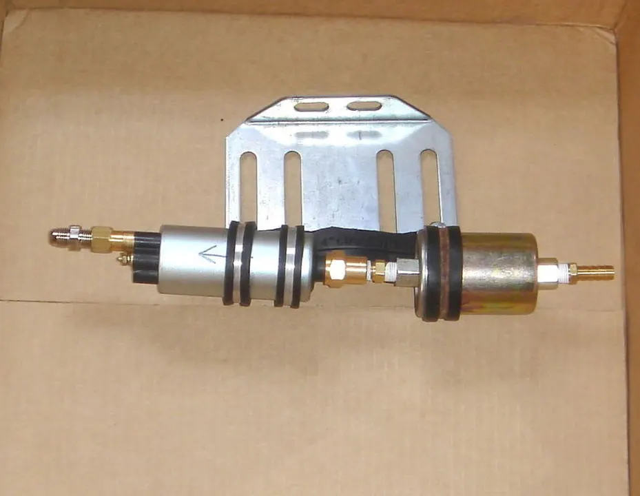

  18. Fuel System:
    Tim

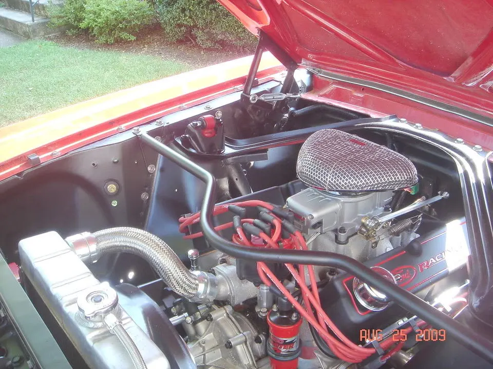

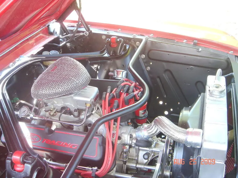

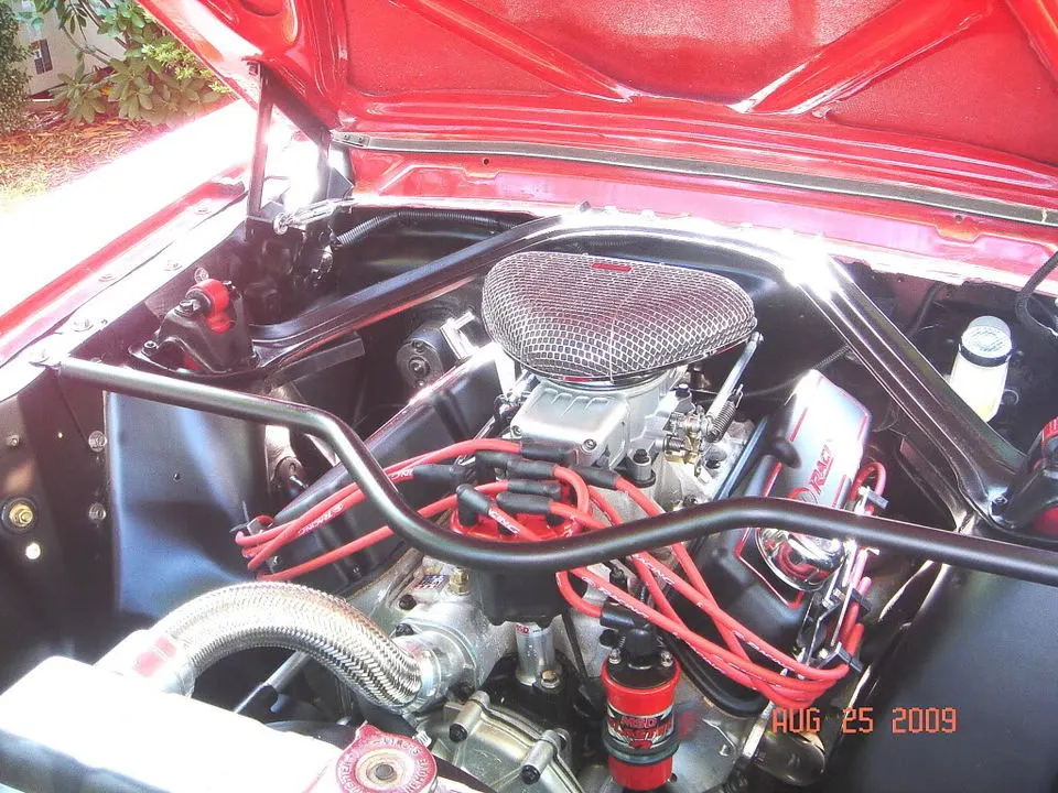

  19. Engine bay and EFI install looks great!
