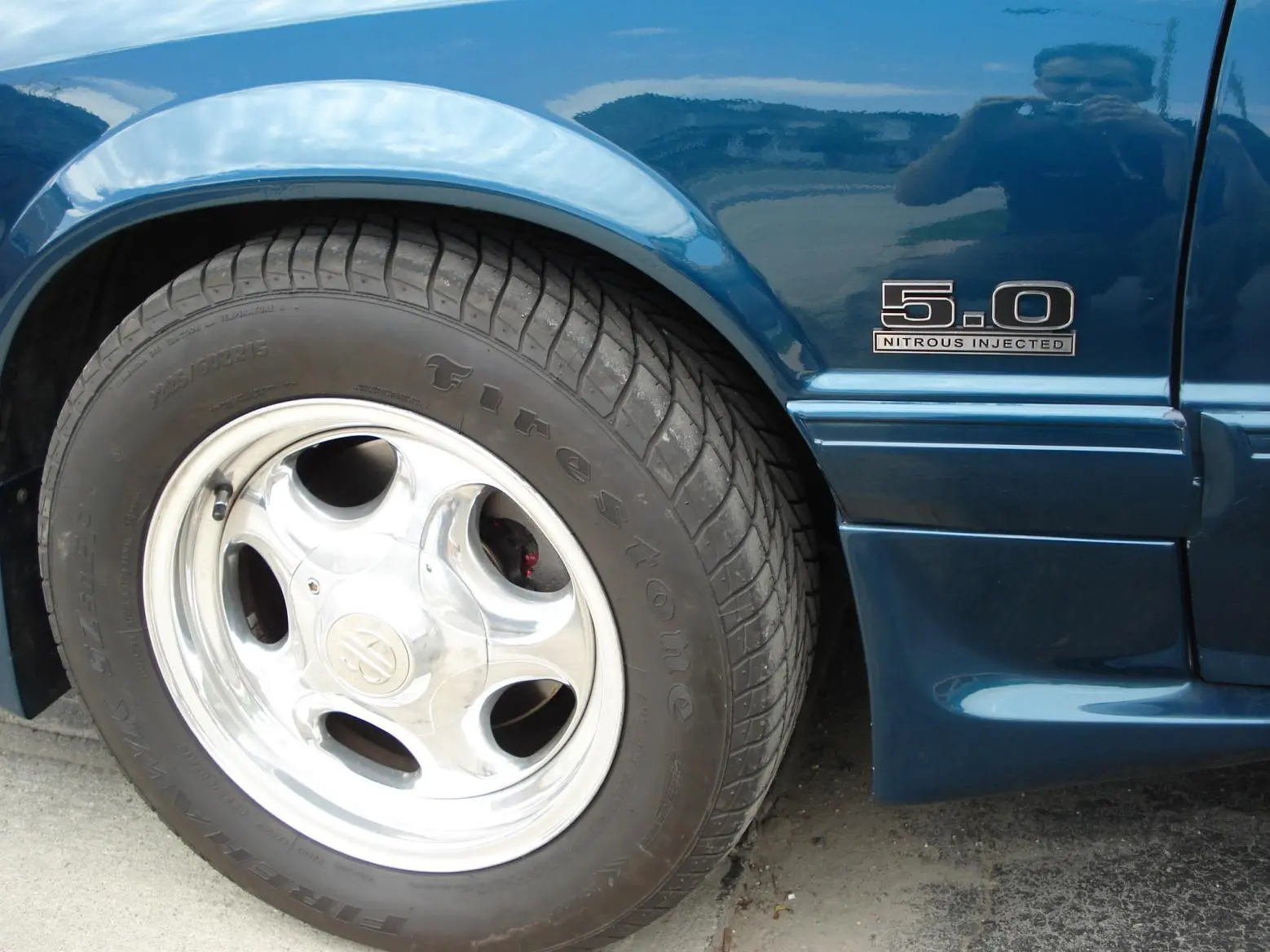

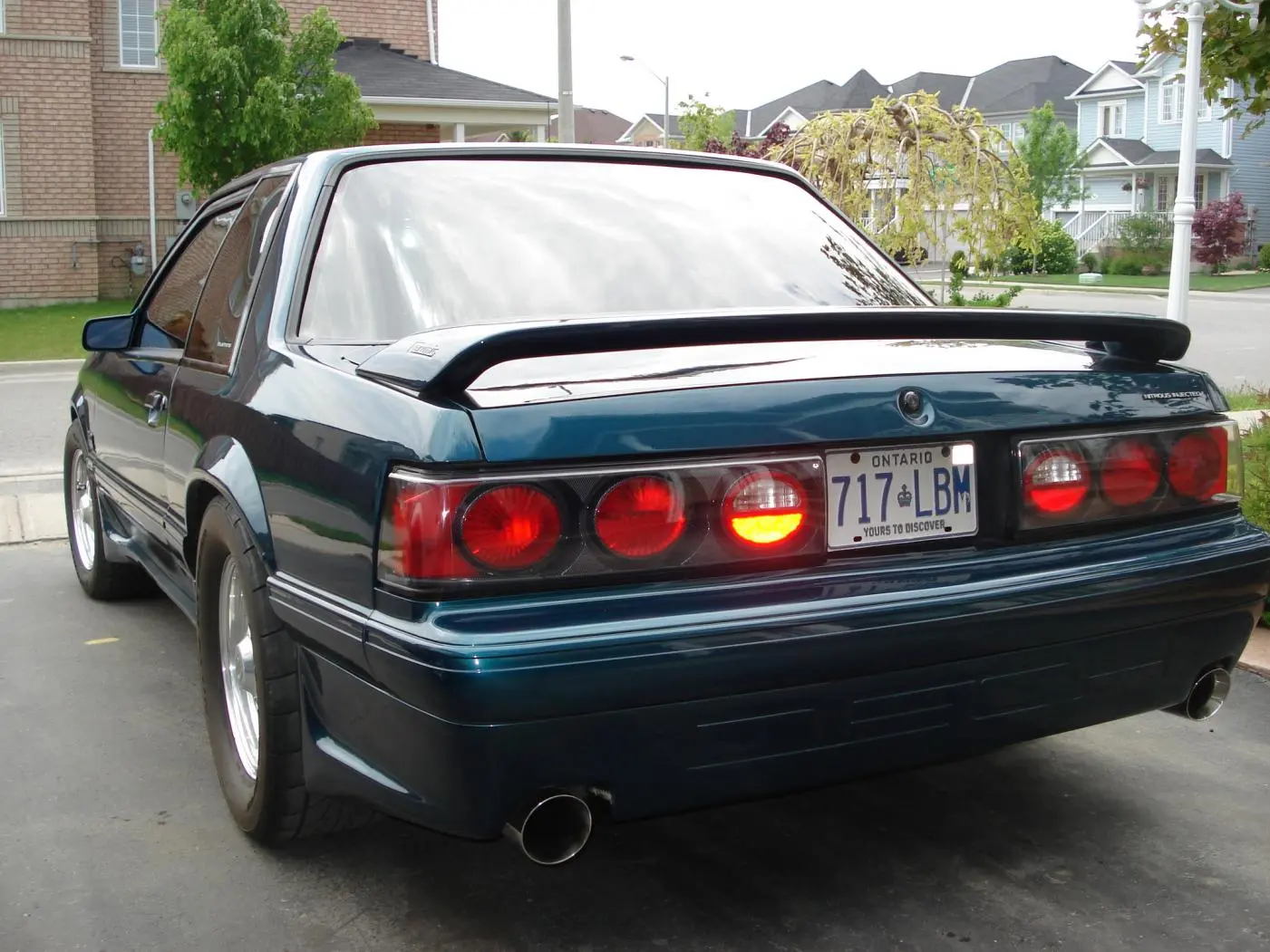

    I need to know the measurement from ground to fender lip. I have quite a bit of stereo equip in the trunk, so as a result the back end sits a little bit lower than the front. I just picked up a front coilover kit and I want to know how low I can go in the front. My rear measurement is 25.5" and my front is almost 26". Anybody know the stock measurement? What's the lowest you can go without any problems.

    Thanks for the reply and info. I have an 89 LX. I have suspension technique lowering springs and i"m going to replace the front with the coilover kit. I want handling and looks. right now the car is leaning to the back, I want to lower the front at least as much as the rear, so that it rides level. I already have the cc plates (MM). I have the rear upper and lower control arms. the only way to raise the back would be to put stock springs back on, or use 'weight jacker' rear lower control arms. I'm going to install the coilover kit and drop the front to 25.5", the same as the rear. I'll check for clearance issues. I was hoping some of you had some info about tolerances - so I don't learn things the hard way.
    I've got stock size 225/60/15's up front, and 275/50/15's in the back.
