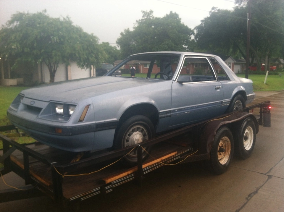

    It's an '85 coupe, clean, clean, clean (read: no rust or damage) 4 cyl car with associated parts. Despite pouring its ass off, we got it loaded on the trailer. It is so light that me and the guy I bought it from pulled it on the trailer with a rope with minimal effort. For $750 with a clean TX title, I couldnt say no.
    So now Im a multi-fox family. The ol' lady isn't sure about it, but I promised her its cheaper in the big picture.
    I just cant decide if I want to swap all the 4 cyl parts on to the '87 and sell it as a roller, or part it and scrap the shell. Input?

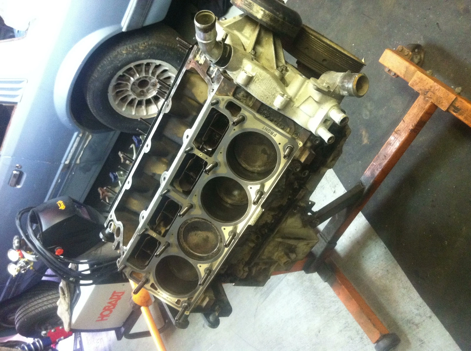

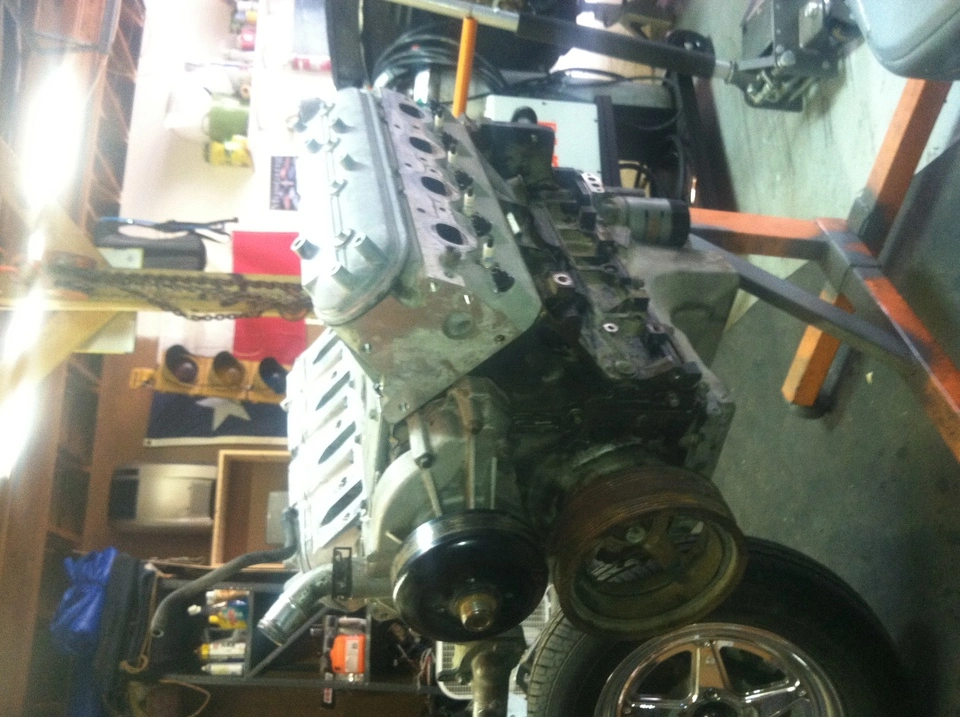

  14. Today I assembled the motor just short of putting the heads on. I need to swap the springs and don't have the tool, so it's off to my buddy's shop in the morning.
    I just opened beer #2 and am debating on putting both cars on stands and swapping front suspensions. The only one here is my lab Luke and he's not much help.

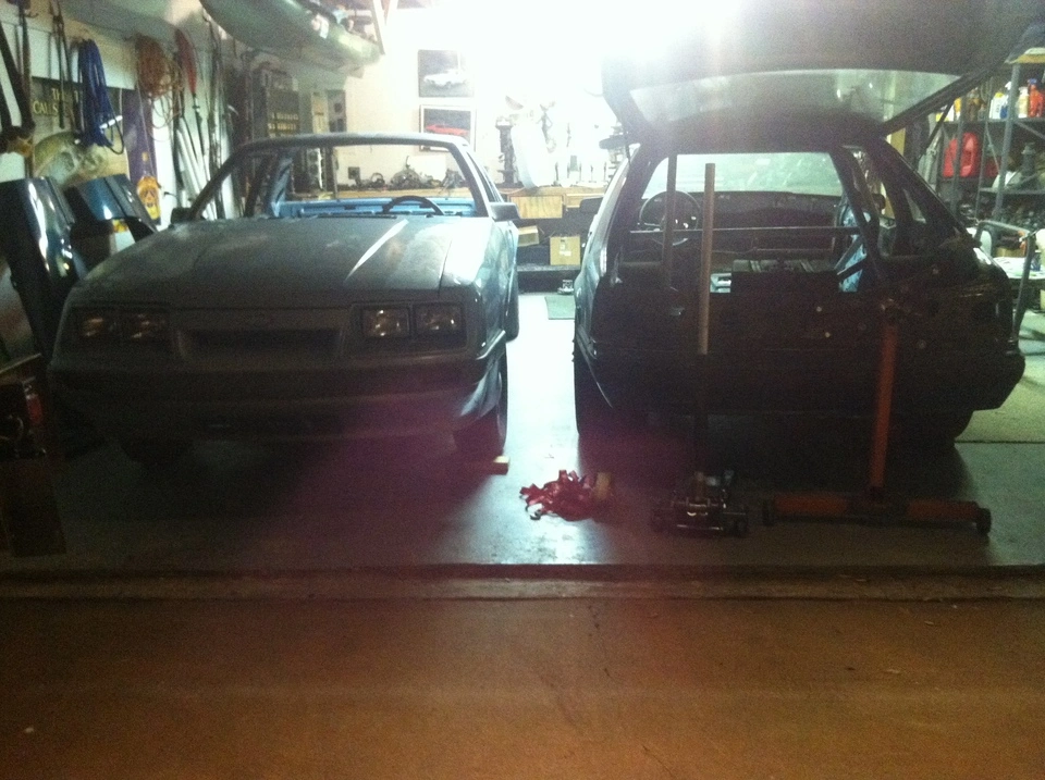

  15. I managed to pull the front end off the '87 buuuuuut..... Since there is nothing on the front end of that car right now, it would make it incredibly easy to fab up some motor mounts. Guess Ill bolt it back on in tomorrow and get to work on some mounts.... After I swap the spring and finish the motor assembly.

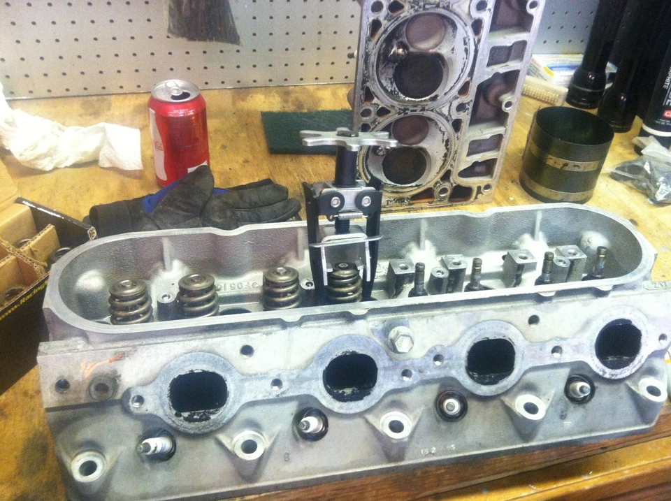

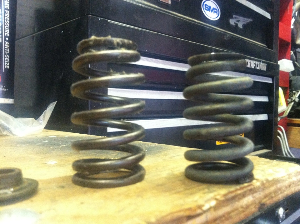

  18. Got some work done today -
    Began by degreasing the heads, VCs, and lifter valley cover. If you've never used Bleche-White, you should start. It's amazing stuff; even tried to remove the skin from my fingers.
    Then I swapped valve springs:
    Here's the stock vs the upgrade (more on that later):
    And here she is, ready for battle....maybe:
    *Edit - I assure you it's really clean. I did a lot of scrubbing, the light is just hitting it odd.

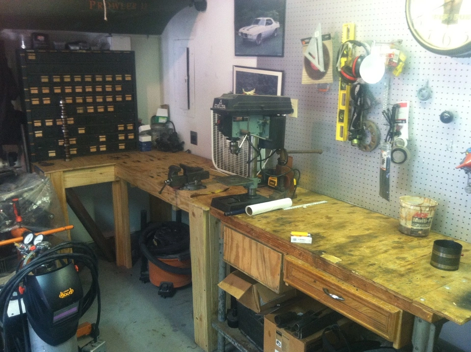

    I'd have to say that of this progress, Im most happy about having a clean/open workspace again.
    And then it hit me -
    The popular LS swap upgrades are PAC 1218 springs, studs, and LS9 head gaskets. Tried and true, proven to work. I figured I'd take it 1 step further and add in a turbo cam. Why not, right?
    ....It wasn't until AFTER I completed assembly that I remembered these springs are only good for .600 lift.
    The cam? .610 lift.
    :oops:
