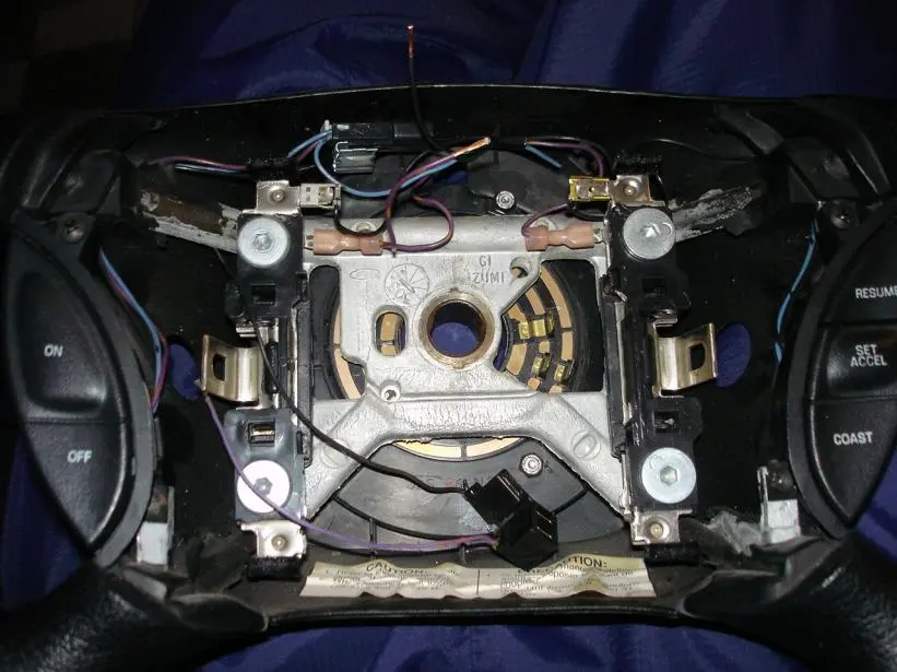

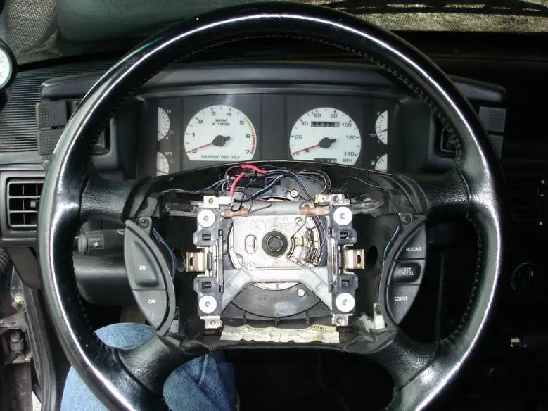

    I honestly would rather not have an airbag in this car. I don't mind them at all, but if the car didn't have airbags, why should I put one in..even if it's not hooked up.
    What's funny is my interior is from a 1990, so the visors have the airbag warning on them.
    I like the looks of my SN95 wheel in my '03 GT. That's the main reason why i put one in the fox. I love the feel of it when i drive. if this works nicely, i will prob upgrade to the FR500 steering wheel.
    I just HATE the escort air bag. I'd rather have the pony bag. It's shaped differently and looks MUCH better IMHO
    BTW, i'll be wrapping this up shortly. Just gotta finish mounting the contact ring and splicing the wiring before i bolt it in for good.

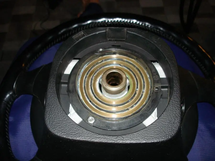

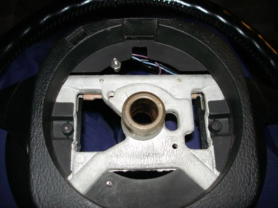

    Ok some more work. Got the disk mounted on the backside. I simple marked and drilled two small holes and bolted the disk onto the plastic of the SN95 shroud. Since the electrical pins will push on the disk, it's pretty sturdy since the back of the SN95 wheel gives it support all the way around.
    [IMG]
    [IMG]

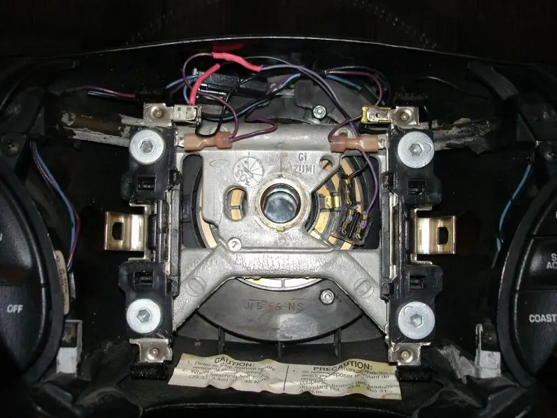

    You can see here how the electical pins poke through in just the right spot.
    My car doesn't have cruise control, so i simply cut the cruise wires and tucked aside. All i needed was the black and purple horn wires. So i soldered them up. If you have cruise, both wheels use a 3-wire setup, so you will be able to make it work.
    Final pic is the wiring done and tucked in and ready for the final mounting.
    I just need two bolts for the airbag. Anyone know what size pitch they should be?

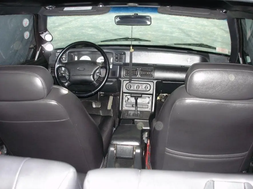

    Steering wheel bolted up. Make sure you use some dielectric grease on the fingers.
    I also bolted the airbag on for good. You need two M6 x 1.0 bolts as short as possible for the airbag to keep it from interfeering with the ability to press it in to beep the horn.
    I hate the Ford airbag, will need to find me a black Mustang airbag.
    Anyway, that's the install. Have fun
