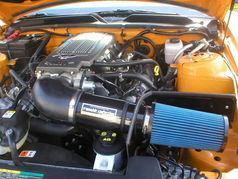

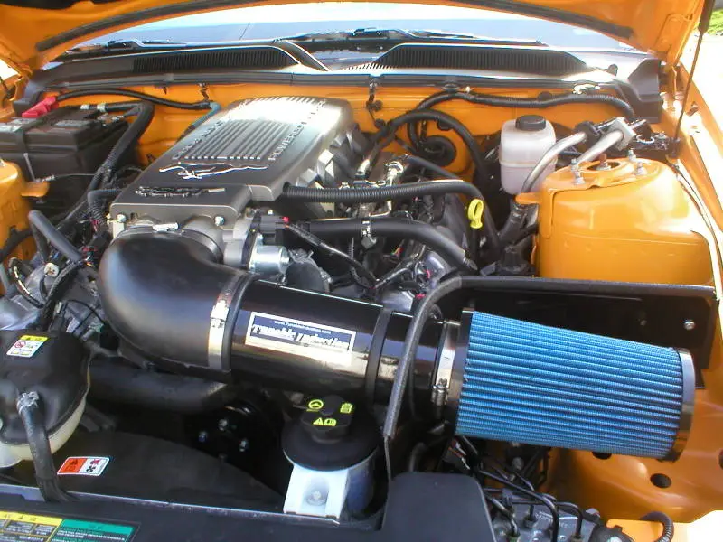

Check out Demolet cai, beat out every other single cai out there with hp and tq gains, and u can get the cai for 100$ when u buy an sct xcal-2 for 379$.
I paid 479$ shipped for my system, dyno numbers to come!:nice:
http://www.demolet.com/

I was sold on the c&l racer cai as well, and i was going to buy it, and my friend told me that demolet had a 05+ system, and not only was equal if not better than the top cai's out there it was cheaper than all of them, and i personaly hate the idea of a metal cold air intake, it just makes sense that plastic stays cooler and suffers from way less heat soak, and the demolet comes with 100mm abs plastic tubing and a 95mm mas, and for 100 bucks when u buy a xcal-2, i was sold and bought it there on the spot. Gave demolet my computer code and info and 3 business days later it arrived. they also offer lots of custom options such as factory matched paint, and diff color filters. Anyways i def reccomend everyone at least check this kit out before buying a cai:nice:
I was sold on the c&l racer cai as well, and i was going to buy it, and my firend told me that demolet had a 05+ system, and not only was equal if not better than the top cai's out there it was cheaper than all of them, and me personaly hate the idea of a metal cold air intake, it just makes sense that plastic stays cooler and suffers from way less heat soak, and the demolet comes with 100mm abs plastic tubing and a 95mm mas, and for 100 bucks when u buy a xcal-2, i was sold and bought it there on the spot. Gave demolet my computer code and info and 3 business days later it arrived. they also offer lots of custom options such as factory matched paint, and diff color filters. Anyways i def reccomend everyone at least check this kit out before buying a cai:nice:
yeh, it definiteley looks like a good setup. the one thing i like better is the racer system is a one piece tube whereas the jlt and demolet are 2 piece with the rubber connector to the TB. Your system is nice, be sure to post the dyno up. you went what, 265 stock or something?
Yeah 263rwhp bone stock, i am getting her dyno'd again tommorow and will have the new numbers with 87oct tune up in the evening. I'm also thinking about then switching to premium gas and loading the 93oct tune but im not sure i can justify the $ for the additional dyno just to find this difference between the octane in the tunes, but im thinkin about it:nice:
