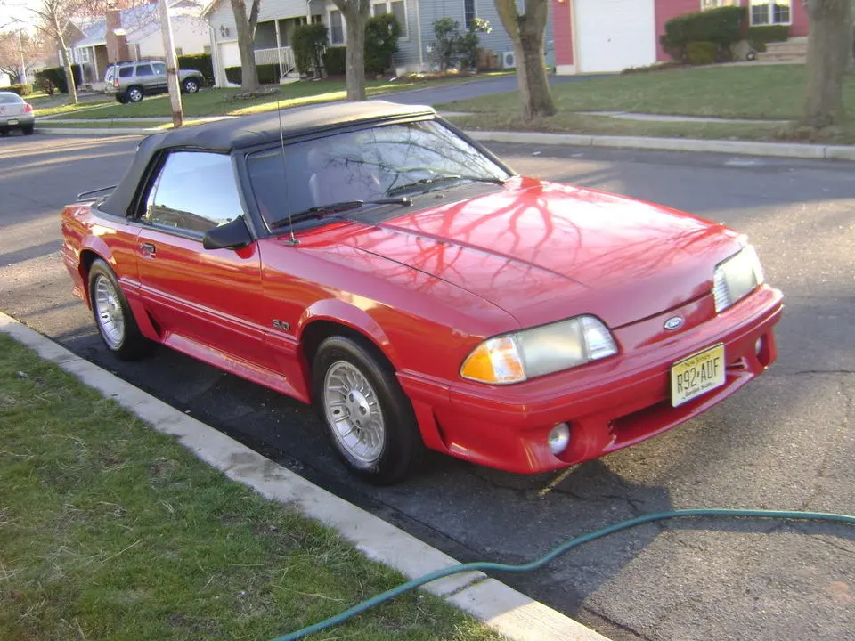

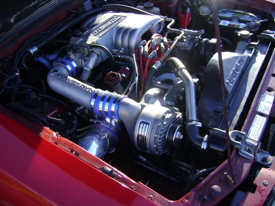

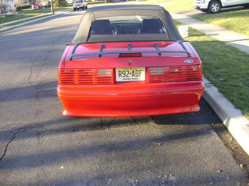

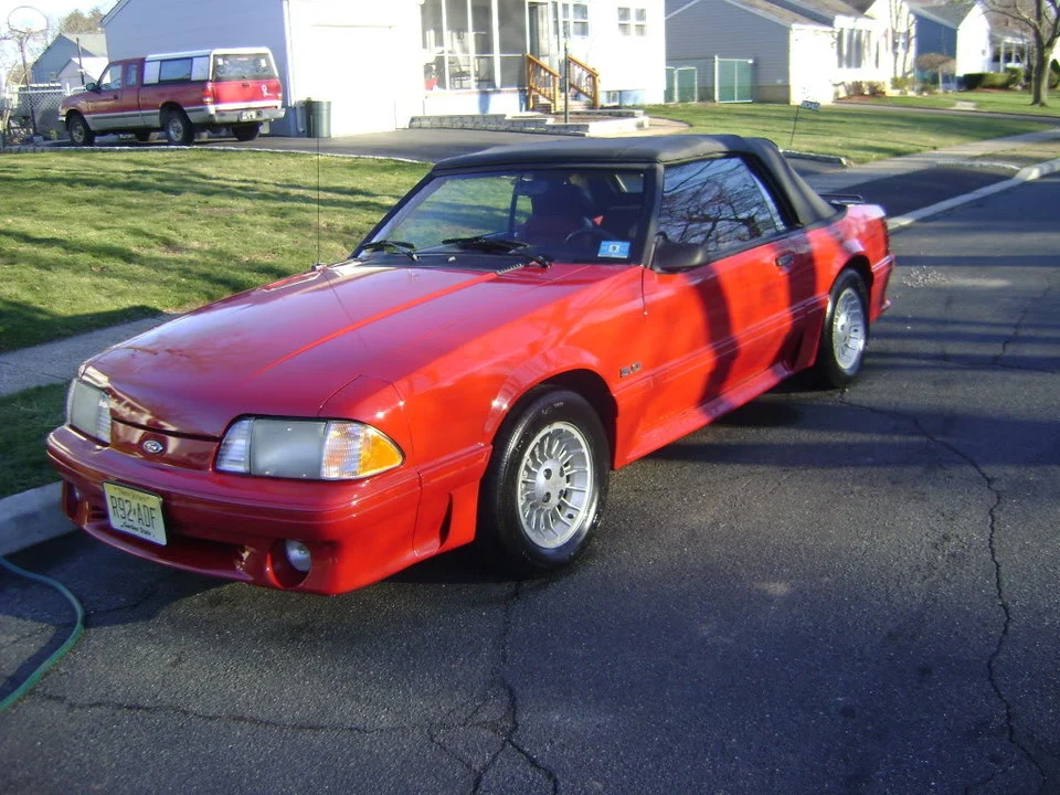

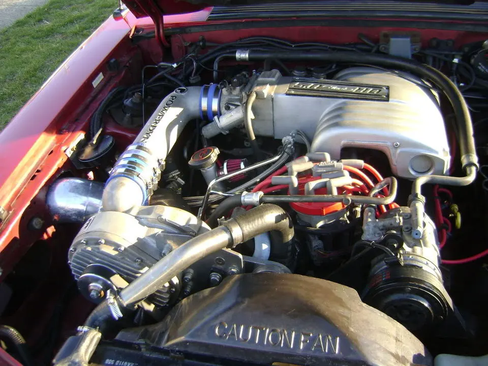

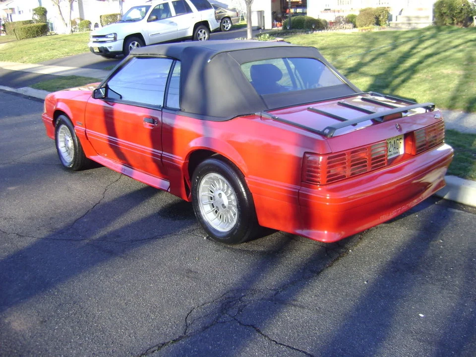

    Just washed and waxed the car after a hard winter..Also added a supercharger from the outside it looks well stock...but its not..LOL..

    Did you keep the Speed Density? If so hows it running?

    Yep i kept the Speed density.Im running 9 psi.this car is old school...LOL...RUNS AWESOME...taking it to the track very soon...Going 40 mph hit the gas go sideways smoking then up with an AOD thats priceless...:D

    Nice! Now get some new headlights! :D

    It runs great..I have the timing locked at 16/18 degrees so it doesnt ping under boost and drives like stock until you hit...lol:D

    Do you still have the PCV? If so, that breather on the oil fill tube is causing a vacuum leak.
    Other than that, looks great!

    Yes i do have the PCV still...Really a vac leak doesnt seem too at all...car runs great idles perfect right around 700 rpms...Should i cap it?

    It's worth a shot. No need for it to be there, really.

    that is old school, awesome! looks great!!! love the car but I can never get past those mini ricer filters

    That looks great and I normally am not a vert fan!

    Thanks Guys...I put the small filter being that the car is pushing 9 psi i know the car will build up crank case pressure so i wanted an escape route, i see alot of guys running them that way...Thought what the hell...lol...seems to run great!!!!! I love the old school look hey i was 17 when the GT came out so brings me back to when i wanted one....I also have a 90 GT 5spd!!! I love these cars...:nice:

    Not usually a fan of verts but that thing looks amazing!

    That's the cleanest set of turbines I've ever seen, hands down. The car is looking good! :nice:
