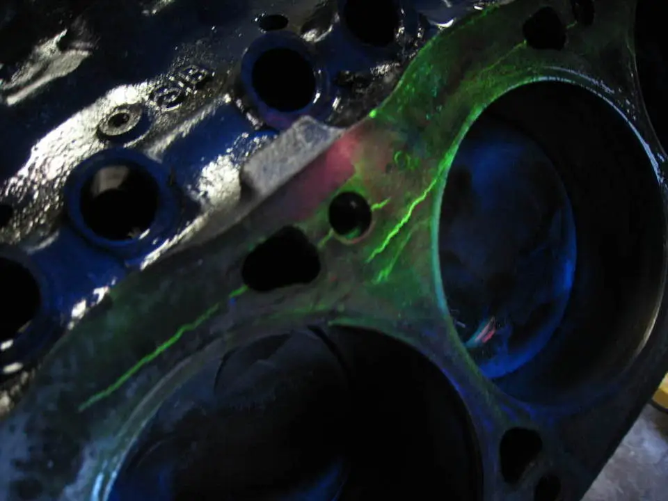

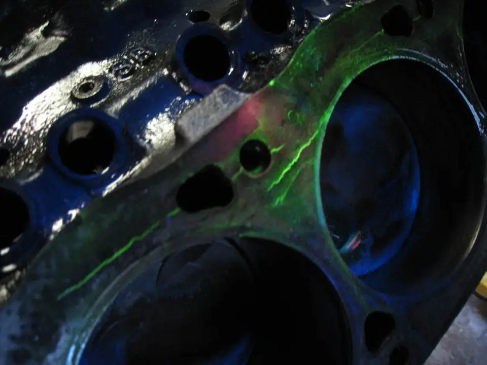

I got the engine torn down and my brother noticed a small crack on one of the water jackets right above the cylinder.
My dad magnafluxed it and we saw this
Is it common for a crack to be there? Do i absolutely have to get a new block?

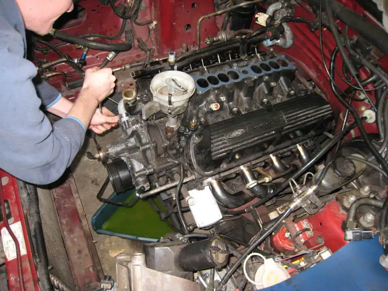

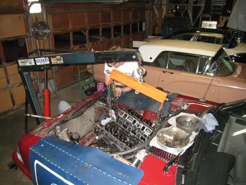

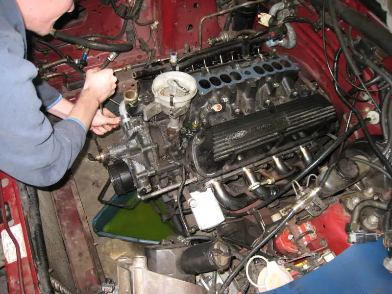

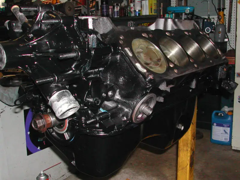

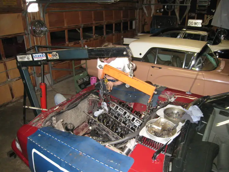

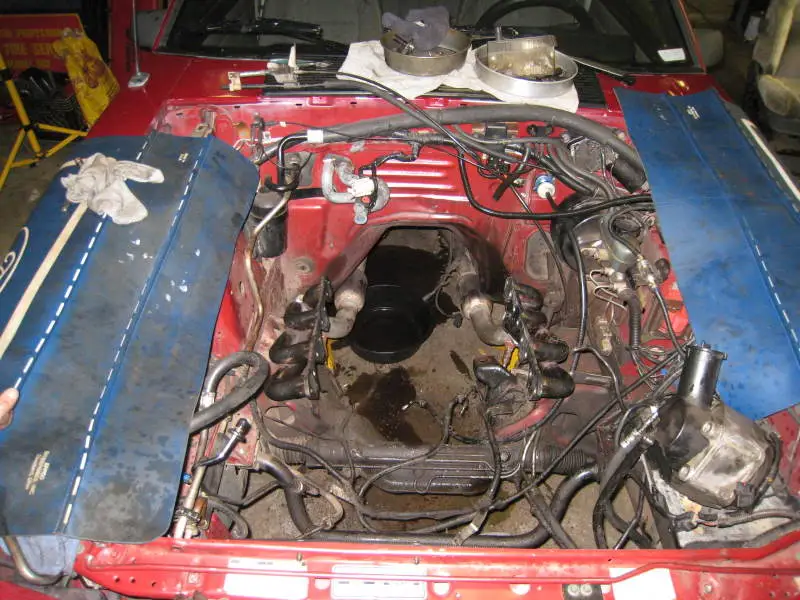

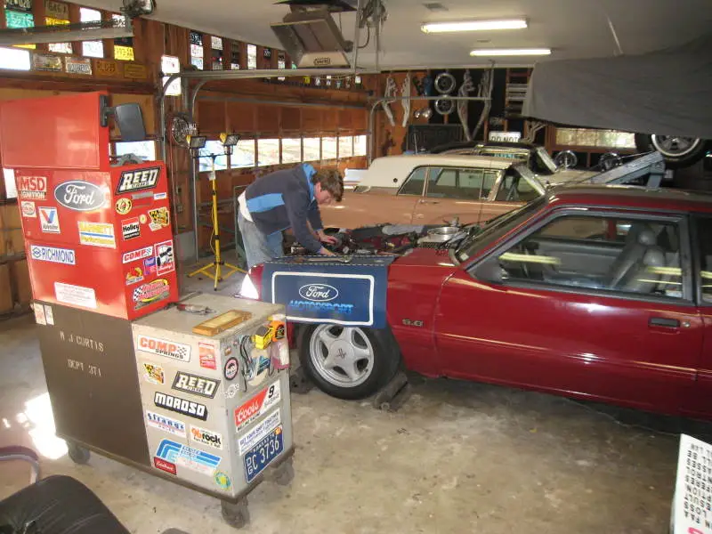

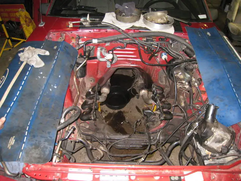

Here are some more pictures from the teardown.
there's absolutely no point in using a high volume oil pump unless you're running looser tolerances in your bearings. not to mention it puts more stress on your cam and distributor gears, shortening the life expectancy of both. and you'll have to get a hardened pump shaft if you do too. just get a standard volume melling, i believe the part number is m68. other than that, looks like it's going to be a fun build! good luck with your block issue, regardless, i would never run a block with a crack in it. you can pick one up for a couple hundred bucks.
