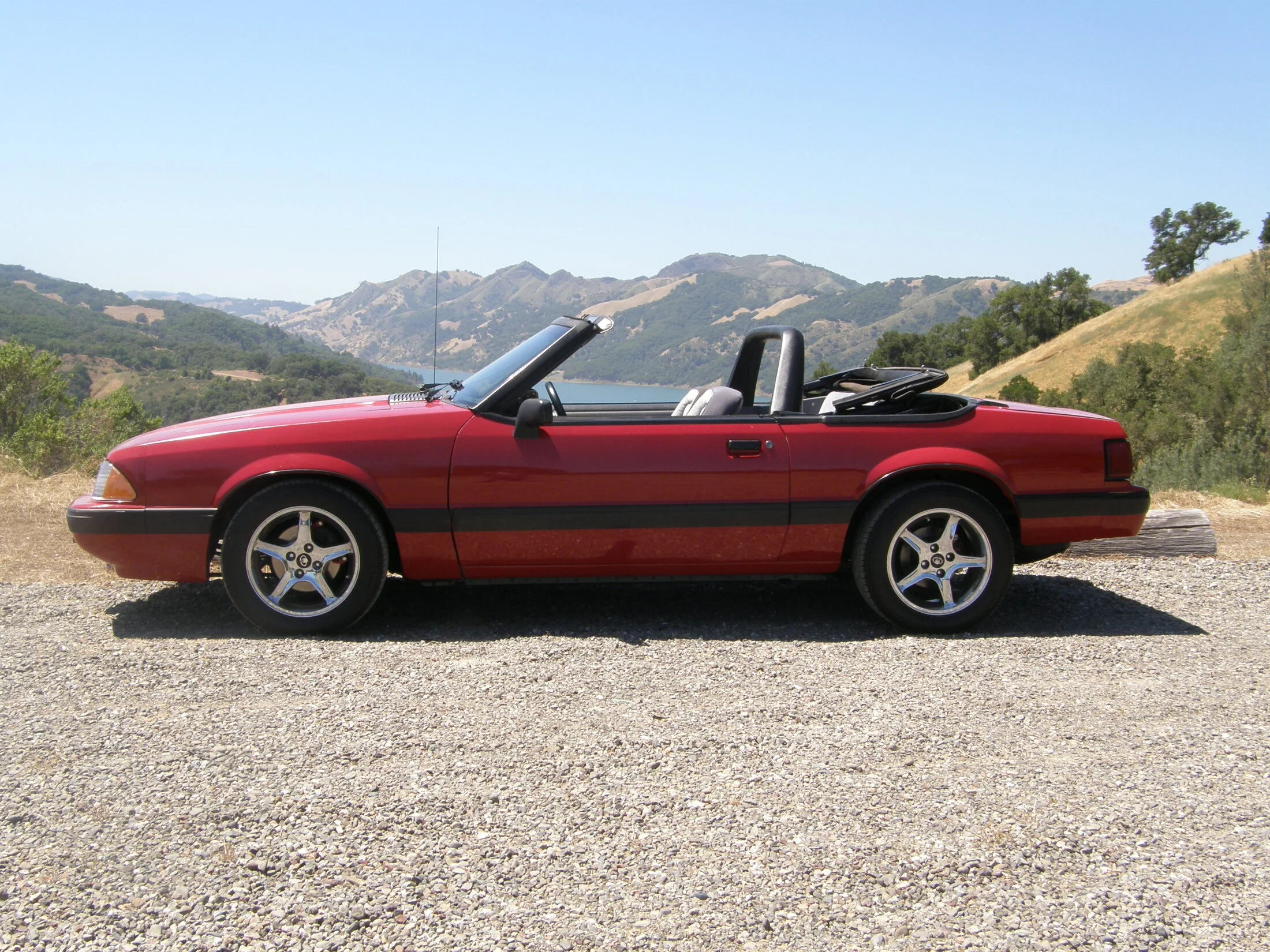

Will take a look for the SVO video, they are the reason the car is staying 2.3. Glad to hear that the FIT system works well, coming back to the Mustang scene after so many years their name wasnt familiar to me - other than the movie of course.
What do you suggest for springs, have the stock 2.3 NA, the Turbo Coupe and the Ford Motorsport 5300 springs new in box or something completely different? Had thought about coilovers but dont see the need to adjust a street car so not really seeing the need
