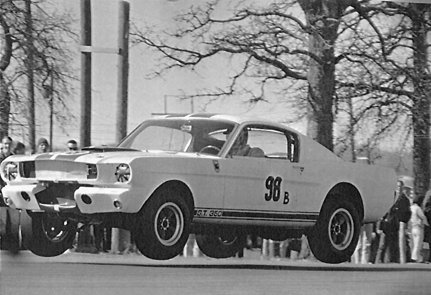

    There is something wrong with your Z bar. Thousands of these cars have been road and drag raced, and it is not a common problem. My car has been driven hundreds of thousands of miles, autocrossed, drag raced, no problem. This is NOT my car, but it does have a Z bar:
