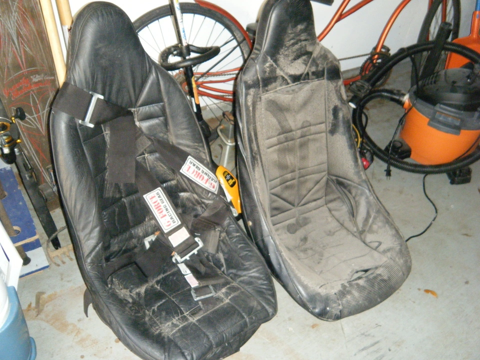

  1. The only thing I can comment on (negatively). Is please get rid of those bracket racer wannabe plastic seats. There is nothing that cheapens an interior more than a set of those things. (that is,...unless you intend to bracket race it..........:runaway:).
    Sorry to ruffle feathers, and you do what you want to, but I just hate those things.
  2. Well the thing about a build thread is that you aren't going to please everyone. I got those seats because they were $80 for the pair and they weigh less than 10 lbs each.:shrug:

    Corbeau seats are nice, but come at a hefty price as well.
  3. Then you're gonna take that pretty car and ......:eek: bracket race it?
    No body was saying that you had to buy Corbeau seats as opposed to those plastic ones. The fact that you got them for 80.00 should tell you something. They were cheap because all they'll do is cheapen an otherwise good looking car. Nobody was saying you had to run some rich mans class either. Relegating that car to bracket duty is the quickest way to throw about 1000.00 of it's net worth straight into the toilet.

    The bottom line is I'm building the car I always dreamed about having while I was growing up. The seats were in my buddies shop collecting dust so I figured I'd use them until I get something better. Eventually, I'd love to have a mint, show quality interior, but the first goal of this build is function over form. I'm going to make it hook and haul, then make it look good doing it.

  6. HAH! yeah, the condition of my car (before the build started) was light years behind reefbluehatch's car. It needs all new exterior sheet metal to be that nice. With that said, input from people like you who have been there and done that is why forums exist. Youngins' like me get on here for information and approval from the seasoned vets. I would never in a million years put those seats in a car that was meant for anything other than racing.

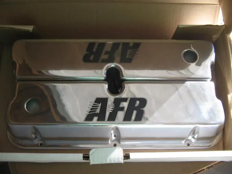

  16. Jeebus help me. I'm bored and started spending again.
    Puuuuurrrrrdy. Also got a timing gear set, solid trans mount, and am waiting on an email back to see if a guy still has some other stuff so I can really blow some cash.
    I need an elbow and a 90mm throttle body if anybody has one... They're surprisingly hard to find used.
